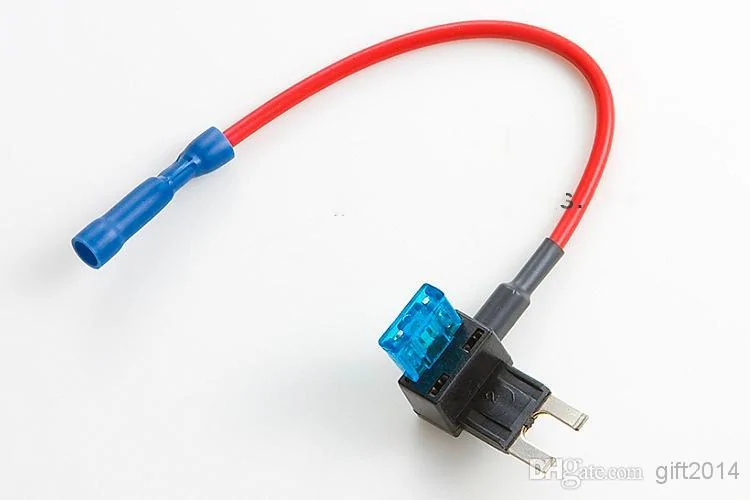

Why not just use a fuse tap?
nothing wrong with those tbh, I just want to integrate the upgrades into the car as if it were factory, I've already got all OEM connectors and will be ordering the same colour wire as what is in the wiring diagrams, figured why stop there lol
