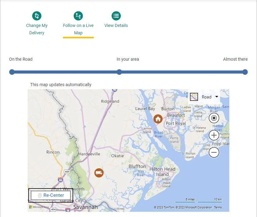

I did order on Amazon. It'll be here tomorrow. I have a feeling the steering wheel won't be here until tomorrow either. It says it's almost here. LOL. I guess it's still possible since that truck originates in my town. But, still.
