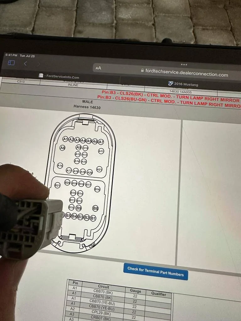

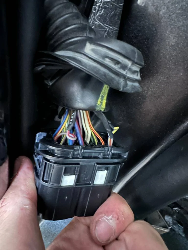

2) Second step was adding the door harness and body wiring for both sides.
For that i bought a used door wiring and body wiring harness to cut out the pins i needed to add in my harness.

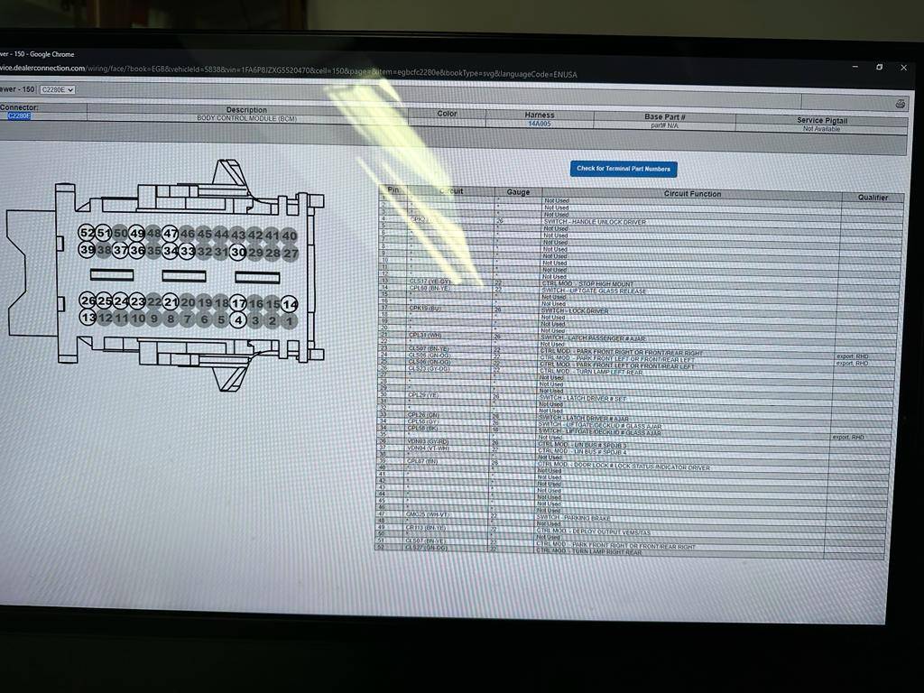

I had the Base mirror's so my harness had 3 wire's for the mirror's and i've added 5 wires. (Ground, Indicator, Puddle Lamp, BLIS, and Heat)
The Ground wire goes to the other ground wire in the door connector, The Indicator goes to the BCM Connector C2280E, puddle lamps go to BCM Connector C2280C and the BLIS wire goes to the trunk for both sides. Heat i only added in the door harness maybe when i have time for that i'll get back to it.
For all the wiring diagram's i used the motorcraft service site. Ford makes it pretty easy with that.

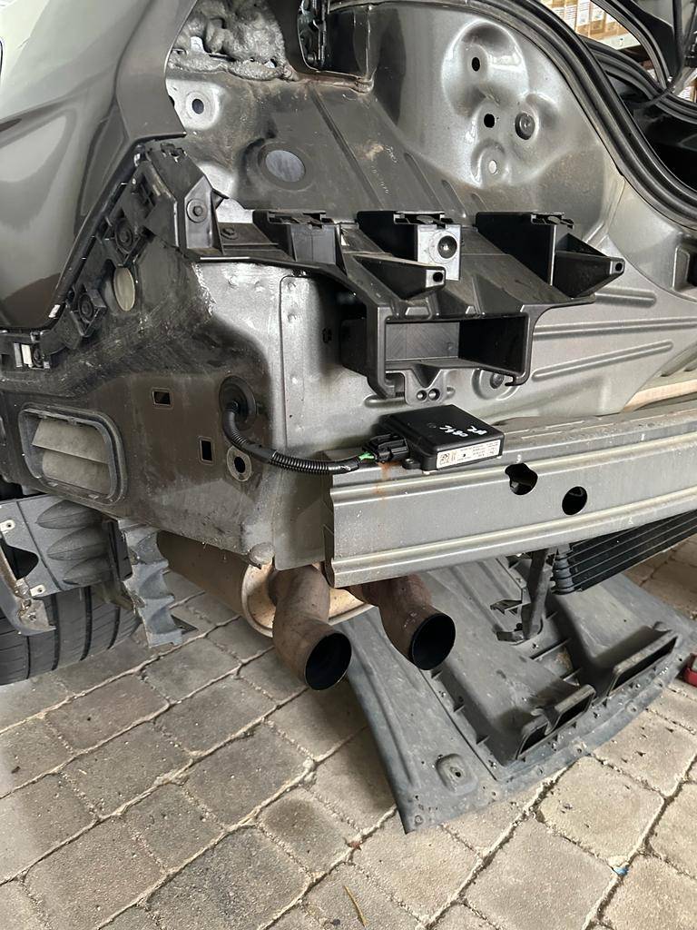

3) Third Step was to install the radar modules for the Blind Spot in the Trunk and wire them.
For that i used this guide: https://www.mustang6g.com/forums/th...stem-blis-and-cross-traffic-alert-cta.107623/
I still need to change out the puddle lamp with the snake since these mirror's came of a gt.
