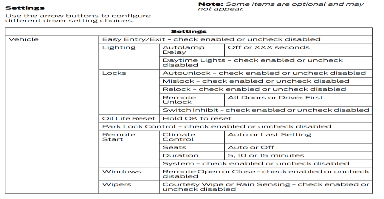

The three LED’s in the headlight housing are the DRL’s for ‘15’s through ‘18’s. They should normally function as the DRL when the car is running and in drive. There is a setting on the computer in the center of the gauges under the “set up” screen where you can go to settings-lights-then there is usually an option to turn on or off the DRL’s. My car doesn’t have that setting, the dealership said the car was built without them as an option. The three local dealerships I have been to all told me they can’t be added. I have to believe that they can certainly be programmed to work. I just need a “guru” to explain how to get it done.
