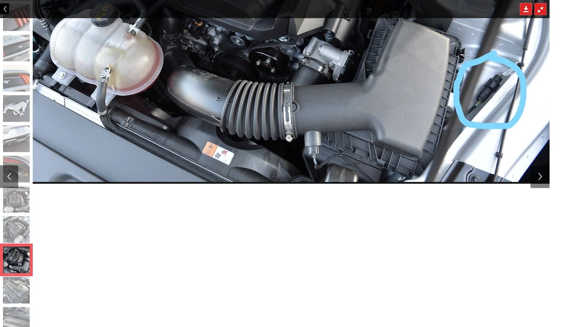

Hi on my 2016 ford mustang ecoboost next to the air intake there is a wire that is not connected to anything. I was wondering if anyone knew what that wire was used for on other mustang models. I Circled it in blue. Thank you in advance.

It is for disabling traction control stuff if you put the car on a chassis dyno. Unplugging it disables traction control and anti skid.
