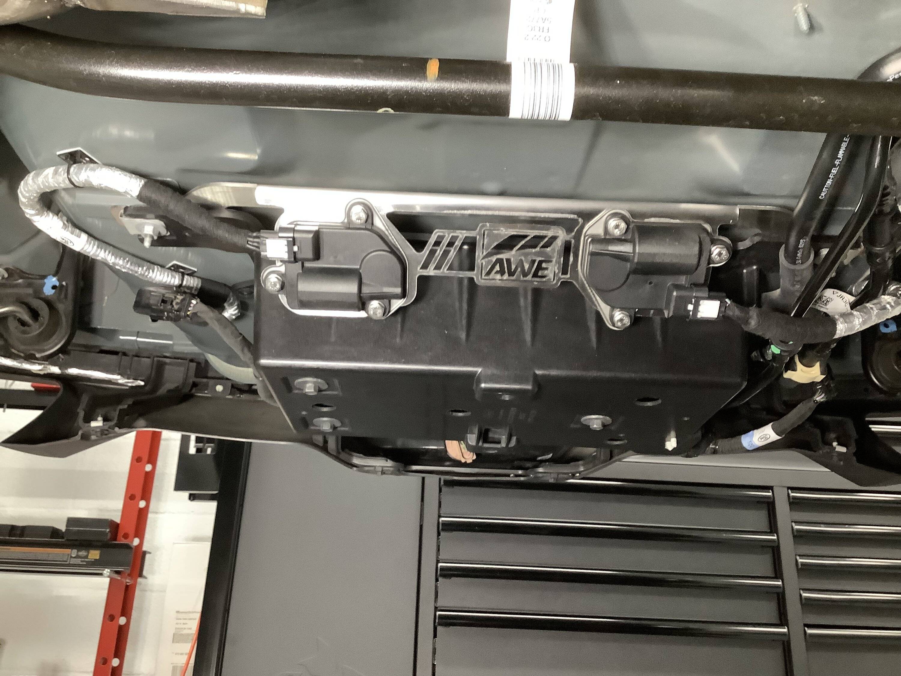

Any factory active exhaust people switch to non-active with the AWE active exhaust valve motor bracket? Did it actually work or did you still lose drive mode functionality and throw codes?

You don’t lose anything, that the car knows about, so drive modes stay active. You mount your actuators to the bracket and they’re still plugged in, so they still adjust too, in free air. There will be no more exhaust mode changes, though. Quiet mode is exactly the same at track mode since the mufflers do not have valves in them.

I have the AWE bracket and it’s just as @CorvZ061 said. No issues with codes and you can still cycle through the modes to get the preferred dash view, only there’s no change in the exhaust note.

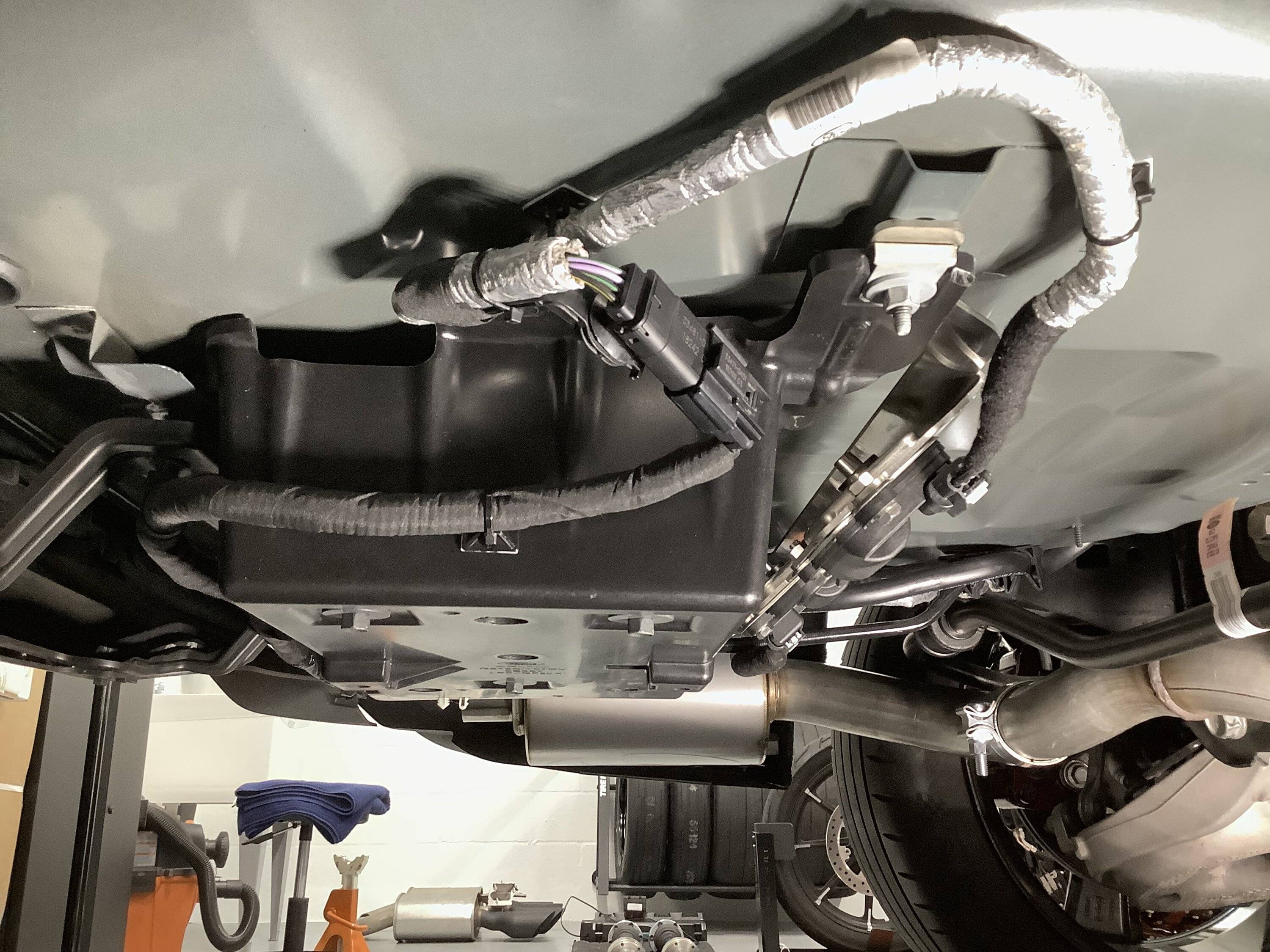

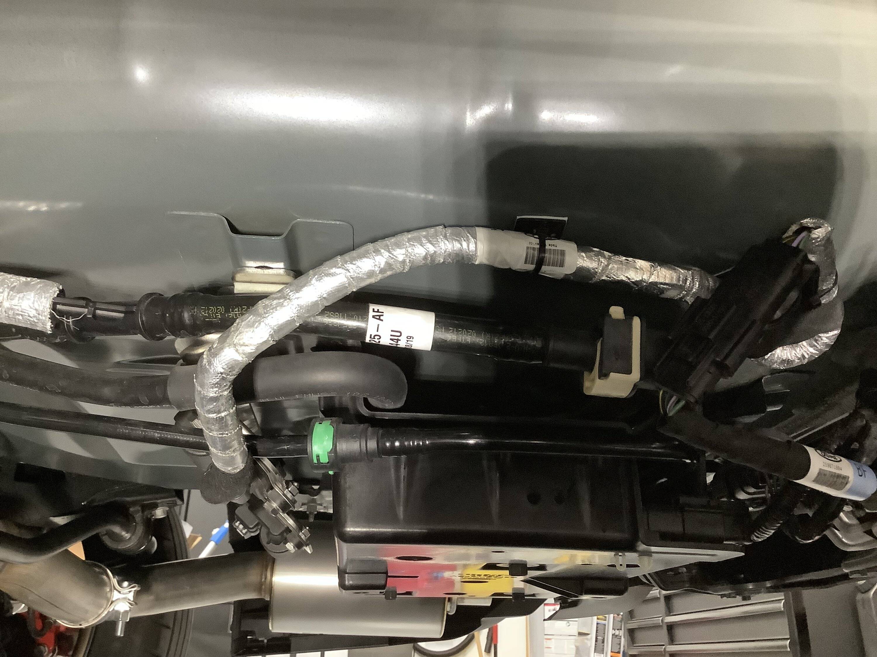

Ok cool! I just noticed in a select few reviews on American Muscle that some guys had trouble even with the actuators mounted in the bracket. I went feral and swapped my AE for muffler deletes, so I had the bracket put on too…. No regrets, drone and all 😂😂
