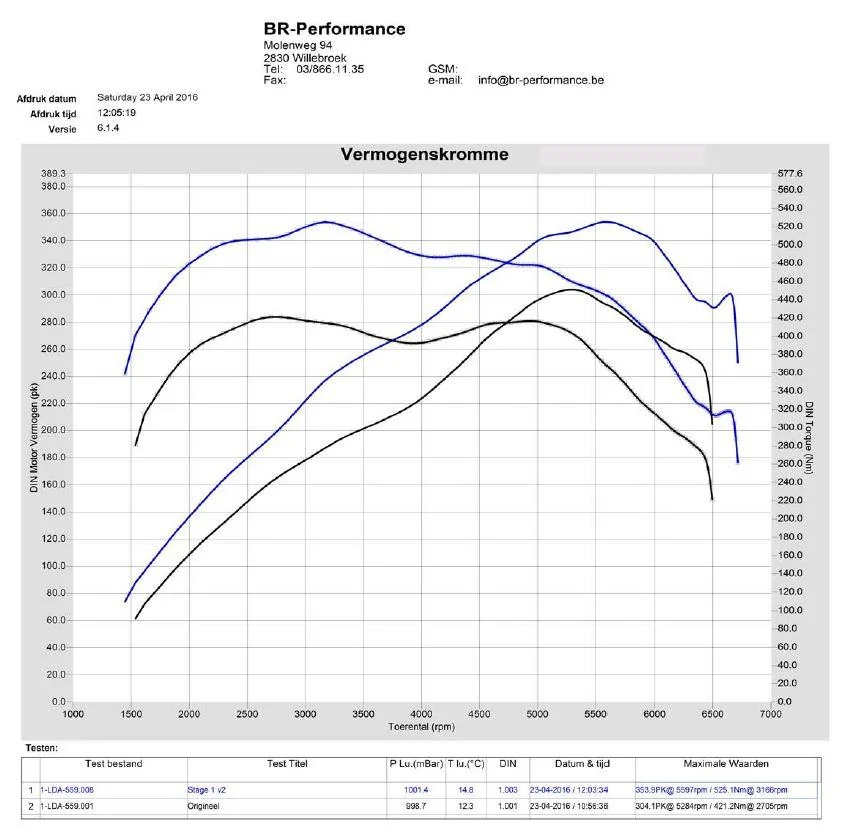

I don't have it connected as well. Just for data logging if Adam has a new revision.
You still have all the driving modes. But besides the 4 modes the car already has, you can also chose between 5 different maps where certain parameters are different within your selected mode. Giving you more power or better fuel economy as a result. With Cobb it goes from 1 = performance to 5 = economy. I only used 1 and 5. Also Adam can give you other ones as well. For instance if you want different fuel, like E30. Which we should really get in Belgium btw.
If the traffic is busy or it rains or I want the exhaust a bit less loud when I arrive at my grandmoms house, I do normal mode and slot 5 (economy)
If it s dry, sport+ and slot 1 (performance)
