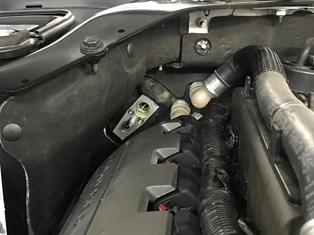

So I got the compressor out, all the lines out. That stuff is all super easy and obvious. I don't think anyone needs much guidance there. Basically:
Compressor Removal
1. You need 13mm and 10mm ratcheting wrenches.
2. Start at the compressor and unbolt the two lines going into it and pull out of the way.
3. Follow both lines and unbolt them at the condenser and going back into the firewall and get them out of the engine bay.
4. There is part of the harness connected to the compressor. Unclip it so you have slack.
5. Using 13mm wrenches unbolt the three studs holding the compressor. I found this easiest from the back under the car because I already had engine mount and starter removed.
6. Carefully lower it after the third stud is out. I nearly crushed my finger being careless. Pull it back towards yourself watching out for the wiring harness attached to it.
7. Unclip the wiring harness by squeezing it and pull the compressor out.
8. There is a third line going to the condenser that is in front of your radiator or behind your intercooler if equipped. Same story, go ahead and unbolt and follow it.
9. Crack open and kill a beer.

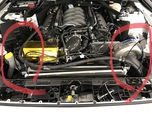

I'll eventually get to the stuff behind the dash and clean up further and document that. This is all that's left under the hood:
Condenser Removal
These instructions are a little application specific due to my power adder.
1. Remove the under-body shield via bolts and retainer clips from under the front fascia. Removing front fascia doesn't seem necessary.
2. Remove the radiator sight shield on top of the front fascia by unclipping retainer clips fro.
3. For a factory coolant overflow tank you should unbolt and push it out of the way.
4. Remove the upper radiator bracket bolts and push radiator up and towards the engine.
5. I could not push my radiator far enough due to my ProCharger Stage 2 setup. Skip to instructions below if you have a similar application.
6. Pull condenser up and towards you to unlock it from the plastic tabs and slide up to remove.
7. Re-assemble.
ProCharger S2 Alternative Instructions
I found that it is possible to yank out the condenser between the intercooler and radiator even if the procharger stage 2 kit is in your way. Basically I hooked two thick zip ties like handles around the metal tabs of the condenser that are locked in the plastic tabs. This let me push with one hand forward and have leverage to unclip and yank up the condenser without removing the supercharger. You should start on the passenger side and yank that up a few inches, then do the drivers since that has the least clearance. Keep doing that and eventually you can basically roll it over and the driver's side will come right out. Be careful not to damage the intercooler and radiator.
