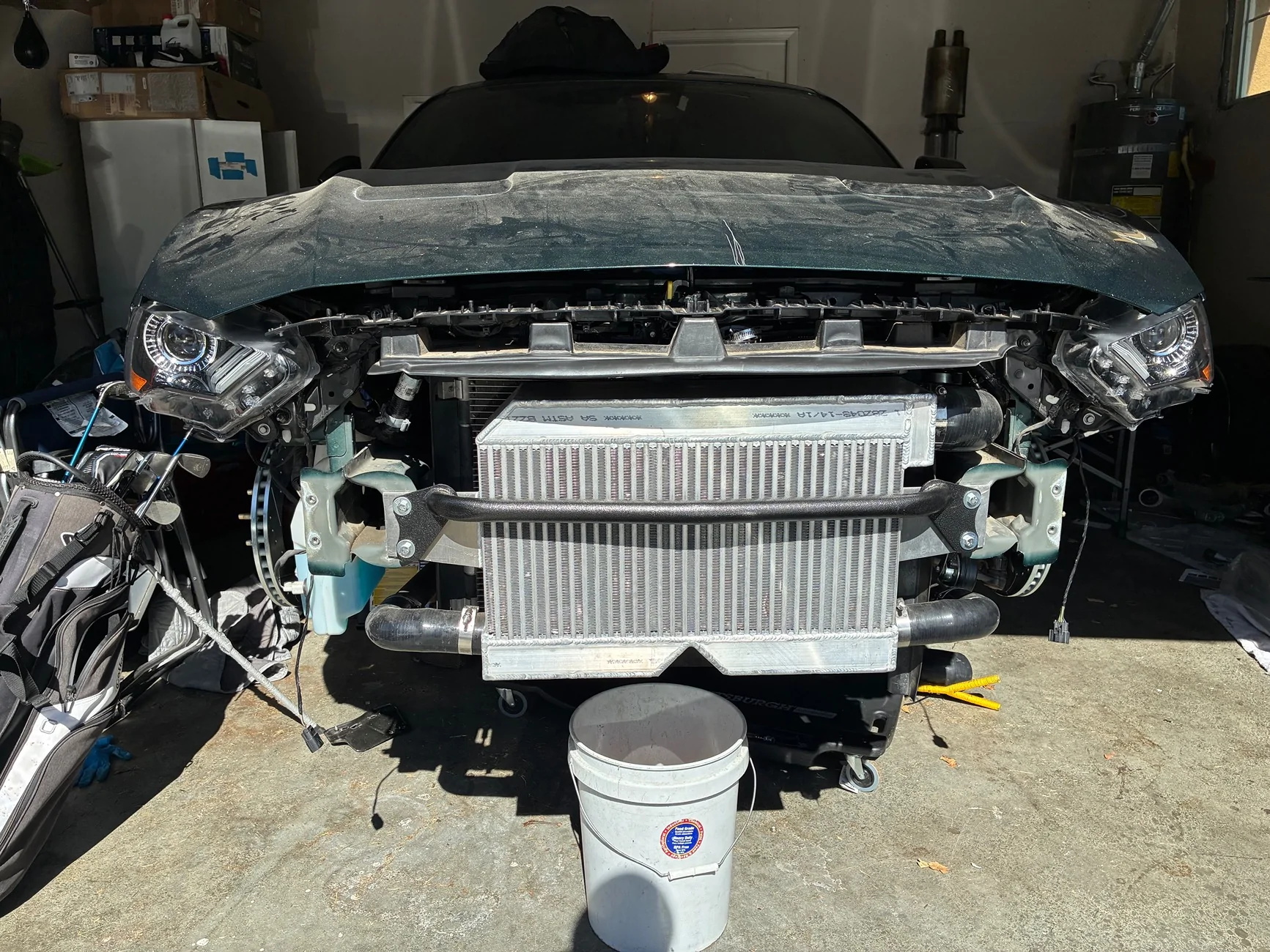

Anyone using an A2W on the street for low boost driving without a heat exchanger? The car has a low mount twin turbo setup, 10 gallon ice tank and currently has an A2A.
But I’m switching to A2W because the car will be mostly running short distance rolls and 1/4 at the track.
wondering if anyone has iat data with A2W on the street or photos of their setups!
I was also thinking since the A2W will most likely block the radiator of solutions for cooling. @NGOT8R recommended using air vent scoops to get air to the radiator.
looking for some solutions for cooling and getting air in as well. Any ideas are welcome.

I have a twin turbo setup.
With the intercooler being under or on top of the blower for supercharged applications like you mentioned, they have room to mount the heat exchanger right in front of the radiator. I on the other hand need to do something like this attached photo.
It's the Lund Racing Blue Goose on the old top mount turbo kit. I wont have a way to stick a big heat exchanger up front like the blower cars.
I believe most people run from an ice tank to the blower, then right into the heat exchanger and return back to the ice tank in the trunk.
Unless there is something I don't know I think my only option with this setup is to run lines right from the trunk into the a2w intercooler. and without the heat exchanger, I don't know how the temps will be

Exactly, that’s why I asked for data or what people are doing with A2W setups and street driving.
I’ll have to keep looking. I don’t think a heat exchanger is an option for me. Unless it is mounted somewhere that is pretty clever.
