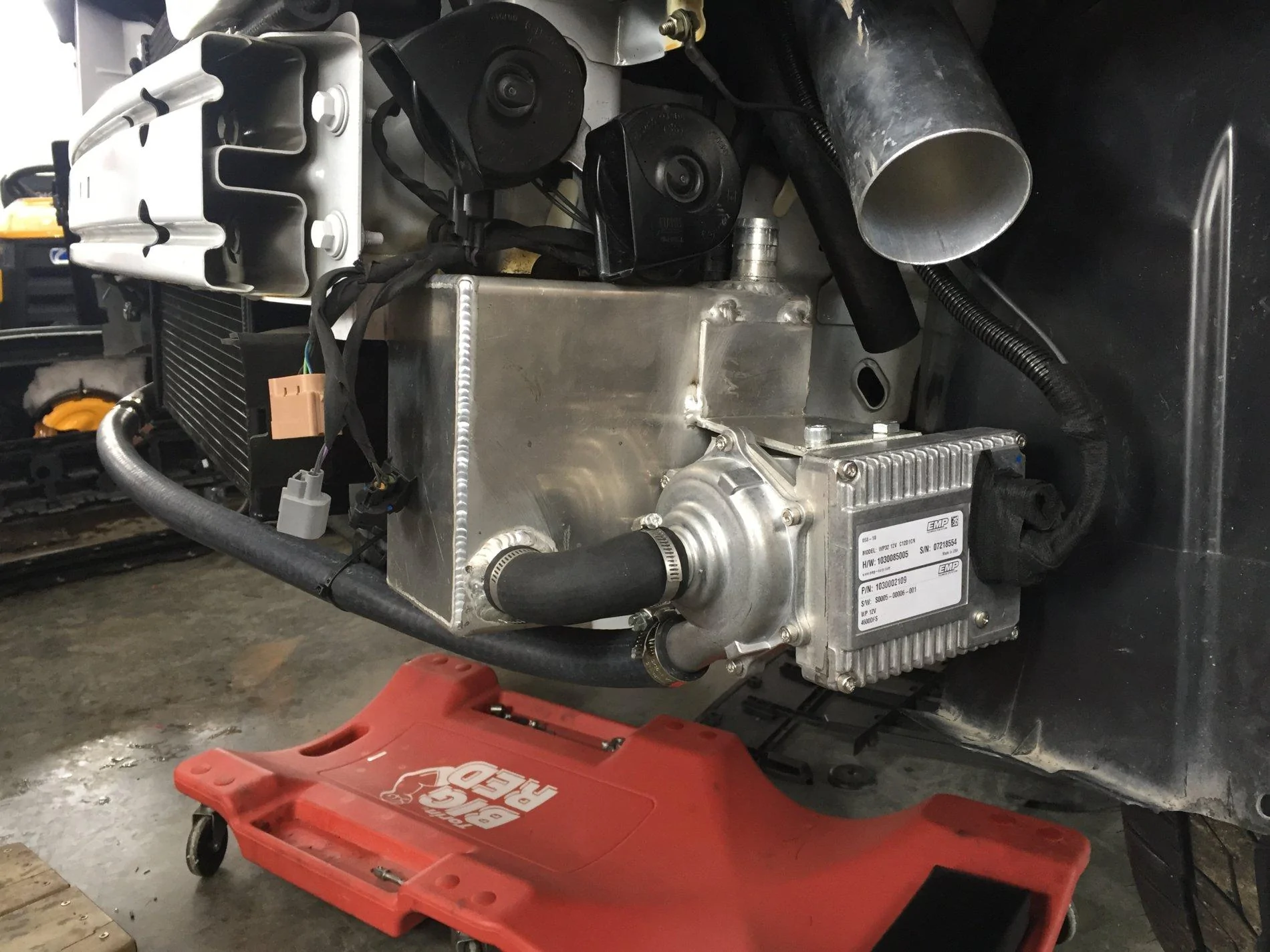

I’ve used a Steward EMP pump on my custom setup for 2 years without issue in my DD.

I've been running an EMP on my TVS 3v for 5+ years . Stewart has nearly doubled the price since then but it is worth the money.
It's designed for continuous use in an industrial setting so is the pump you want for moving a lot of water.
I've ran it on both high and low current and found no difference in my IAT's so I'm keeping it on the low current setting ...
