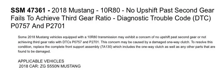

I think I experienced this twice in two parking lots while coasting out slowly on flat surface then trying to tap gas for throttle. stayed in 2nd and RPM went up, then eventually I let off gas to reset shift above 2nd.
Could it be this TSB? I think I will keep an eye on it and see if my car gets codes when doing my regular oil change and multi-point inspection at the dealership.

Yes that could be the problem. It could also be a malfunctioning valve body, which there is also a TSB on that as well.
Check out the Issues/TSB sub-forum on here or search my user ID. I had started a 10R80 thread that contains all of the current SSM/TSB/GSM info available to date.
Whatever the issue is, it will be covered under the 3/36 (or if you purchased an extended) warranty.
The early 2018 S550 10R80 builds seem to be affected more by some of the early shifting/clunkiness issues.
There was also a SSM or TSB regarding the fluid type that shoots be used in the 10R80. I think some of the issue could be related to 10R80’s probably receiving the incorrect trans fluid early on (why else would Ford put out a notification after some issues started cropping up).
