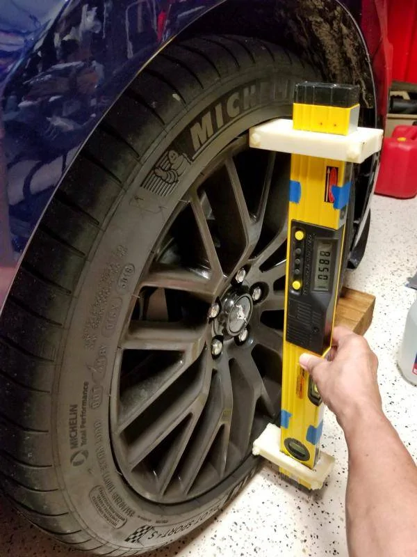

I have been reading about the possibility of using Camber Bolts along with getting a gauge which attaches to the rotor to make a small adjustment myself. Just wondering if anyone else has made this type of adjustment. From what I have read I would need to add a little Neg camber after zeroing out the gauge before starting. Maybe a half of a degree? What do you guys think? Car currently rides and handles great. Just trying to get a little more life out of those front tires. Thanks

Mine (2019 PP1) came with -1.5 from the factory and seems to be wearing ok. Camber is the easiest of the measurements to check, plenty of DIY articles online.

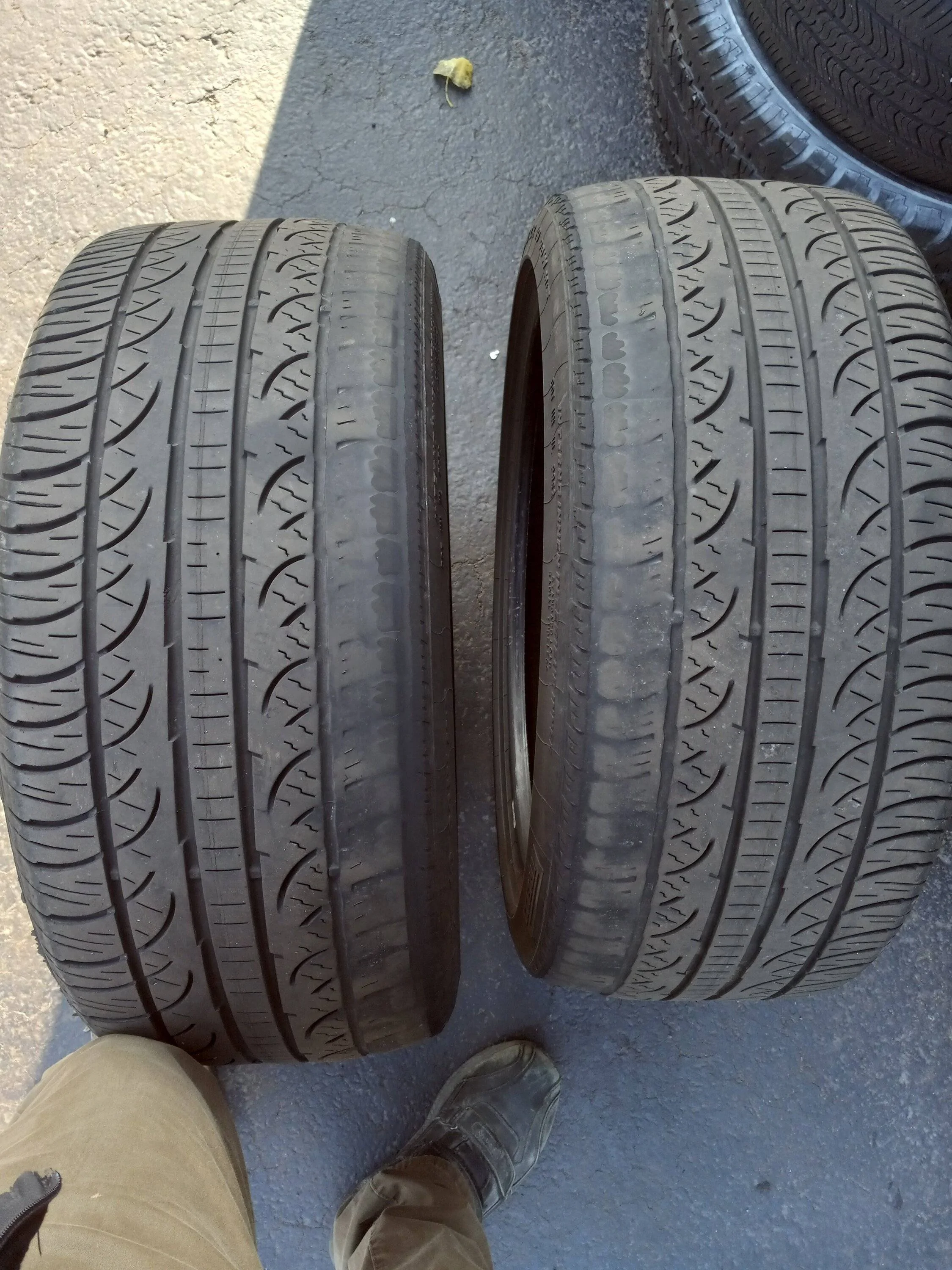

Same problem 2017 gt pp 32k miles

Thanks again Guys, Thanks for the picture stoner My Cooper AC3 looks similar but the wear on mine goes a little into the next tread block with only 10k miles. I take it yours is toe as well.
Cooper AC3s are labeled with an inside and an outside for mounting. Not sure if that is for Tread pattern only. I have flipped directional tire rotation before with no issues.
