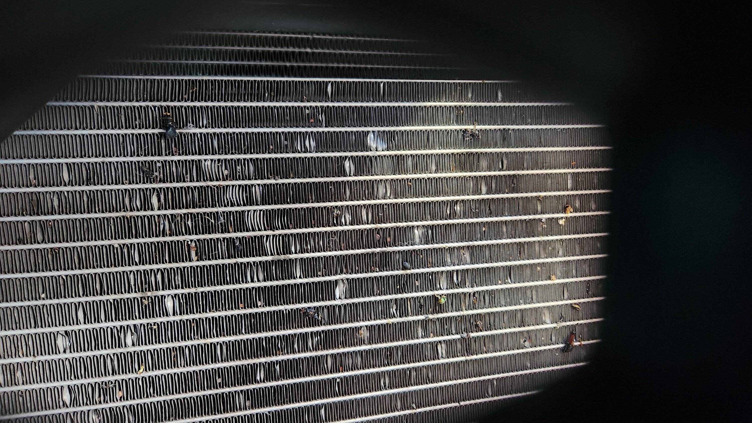

So I borrowed some good gauges and got some UV leak detector. Didn't find any noticeable leaks throughout the system, but did notice my condenser was pretty dirty so I washed it off. There are some bent fins, but this isn't too bad it's it?

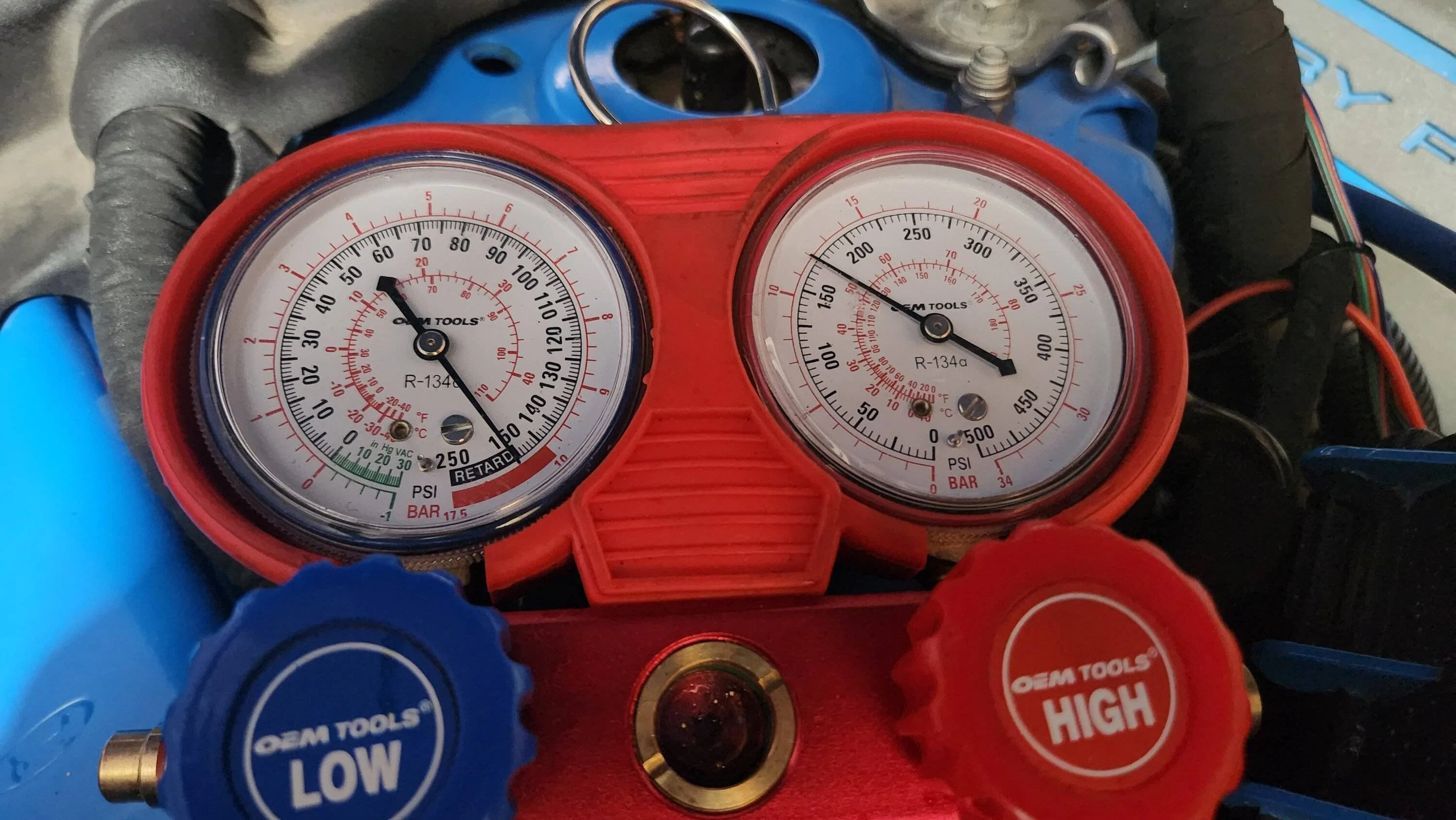

When the compressor is running, these are the pressures

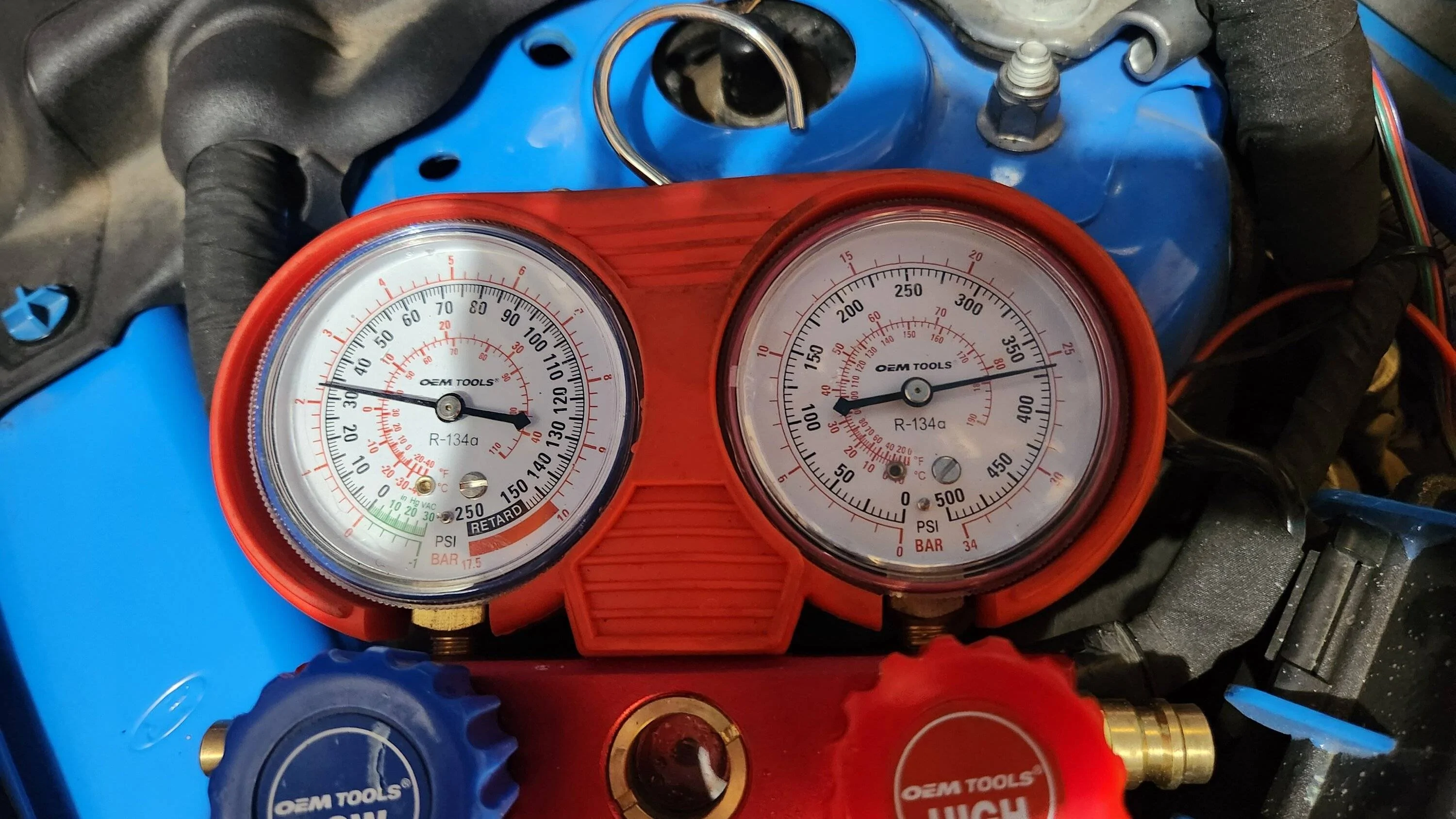

And when turned off and allowed to equalize I get this
The high and static pressures seem high, yea? Or is this normal for this system? The good news is that the compressor runs consistently now, but is still noisy.

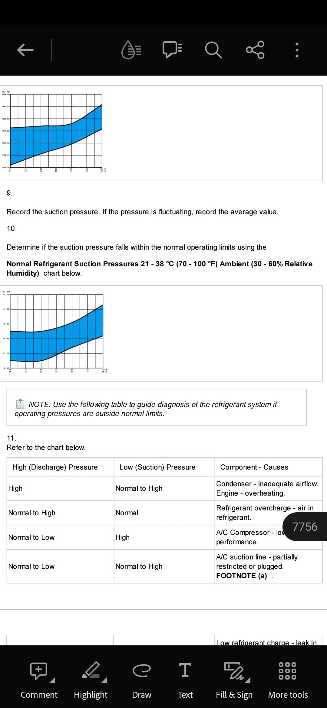

So I found this in the Workshop Manual, which answers some of my questions about pressures.
In this cool weather, the high pressure should be between 150 and 230. The table below the graphs also gives some direction on what the problem could be based on the pressure readings. Out of the three causes I think air in refrigerant is the most likely, and since the compressor is whining, I should probably just replace it and flush out the system.
