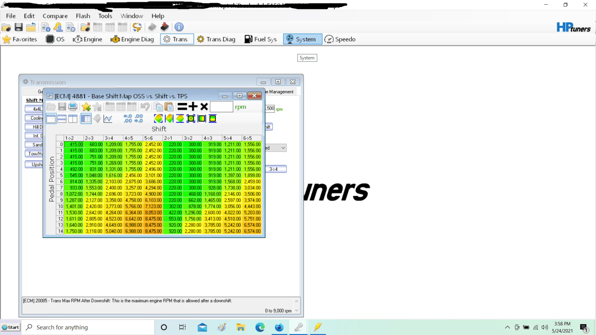

Does anyone have a tune for the 6r80 that doesn't shift into 6th at 38mph during normal driving? I cant stand it. Id like to move the 5-6 shift point to around 53mph.

This should do the trick. Have him copy this schedule

Does anyone have a tune for the 6r80 that doesn't shift into 6th at 38mph during normal driving? I cant stand it. Id like to move the 5-6 shift point to around 53mph. My tuner wont do it
Your tuner doesn’t know how to do it.
