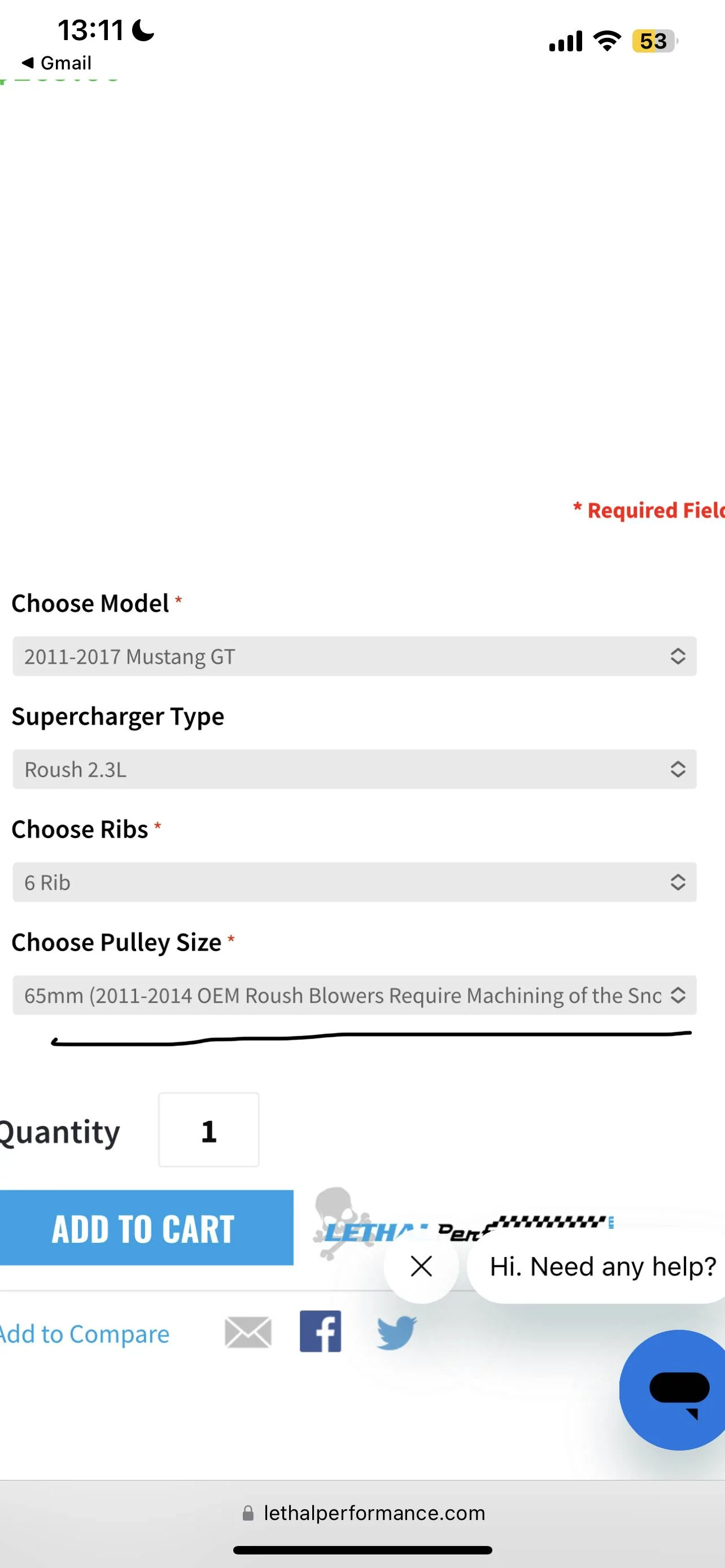

That pulley (2.6”) won’t fit unless the snout diameter is machined down about .050”Anybody run or ever ran a 65mm pulley on their 15-17 roushcharged gt ?
The older ones had less clearance than the newer ones.Is that regarding the older roush kits or newer ? I’ve heard the newer (15-17) kits you don’t have to do any machining.
Absolutely. I have an almost new 2.80” (72mm) Griptec that would fit for you if you’re interested.So you’d still have to do some machining ?
They got that drop-down menu wrong.this is what made me think it would fit on newer models

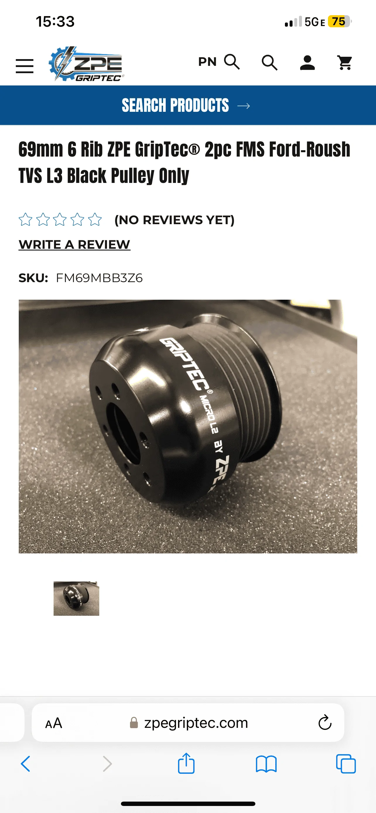

FYI, your VMP pulley is actually a 72mm…. They measured them wrong way. They were stating the pulley size based on the diameter at the bottom of the groove valley, not the top…..I appreciate it , I’m already on a 69mm . Was trying to squeeze out a bit more boost.
Well I’m not using a vmp pulley. I’m using a 69mm grip tech pulley.FYI, your VMP pulley is actually a 72mm…. They measured them wrong way. They were stating the pulley size based on the diameter at the bottom of the groove valley, not the top…..
Do you have a picture? Because VMP used to send their pullies to Griptec. The longer cone pullies were still wrong.Well I’m not using a vmp pulley. I’m using a 69mm grip tech pulley.
