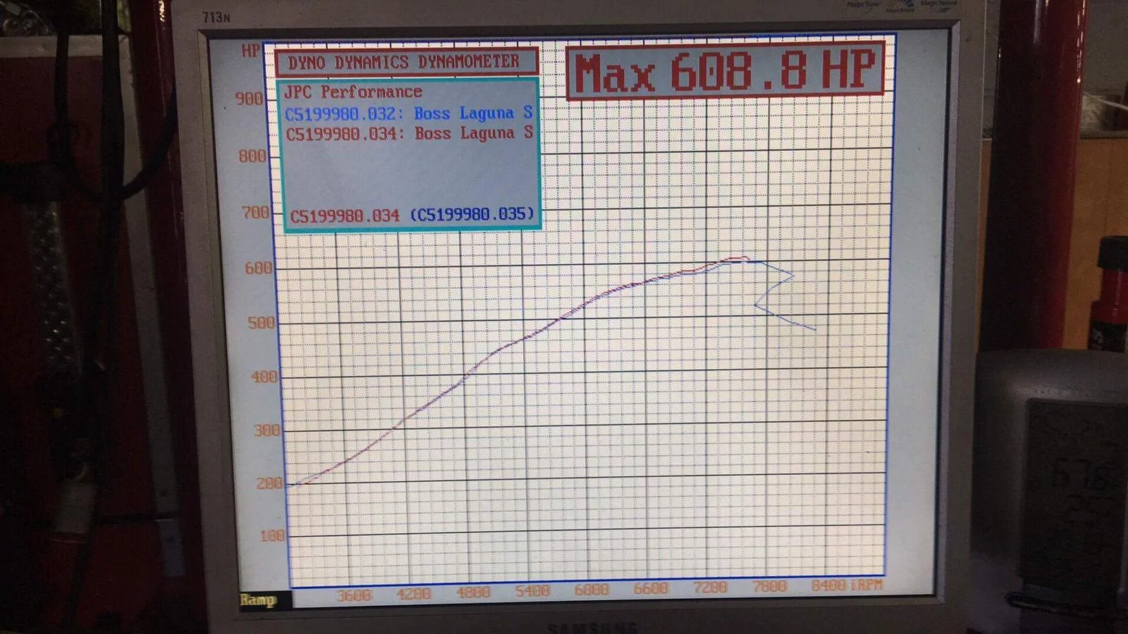

After some break in miles, this is what the car dynos at
RGR 326ci block 11:1 Compression
2015 Heads with RGR Stage 2 Heads
Cometic .040 Head Gasket
RGR custom grind NA cams
Cobra Jet IM
Monoblade TB
JLT CAI
Kooks 1 7/8ths Long Tubes
Kooks Green Cats
JPC Racing Lightweight Alternator Pulley
ATI Balancer
FTW Purple
609/448
On E85 when I last dyno'd it we were at 580/442 and on 93 we came up with 565/430
