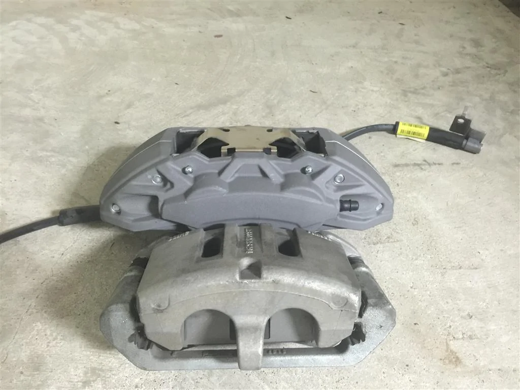

Located in Union county. The rotor and calipers will be a direct replacement right? Or do I need to buy other parts to hook everything up?
My understanding is yes it is a direct replacement....suggested the brake lines as it was suggested to me. Also the one thing is the master cylinder which I have heard yes and no. But is not that expensive 70 bucks ish to do it right.
PS thanks for the comparison pics David. They look soooo much better along with better performance.

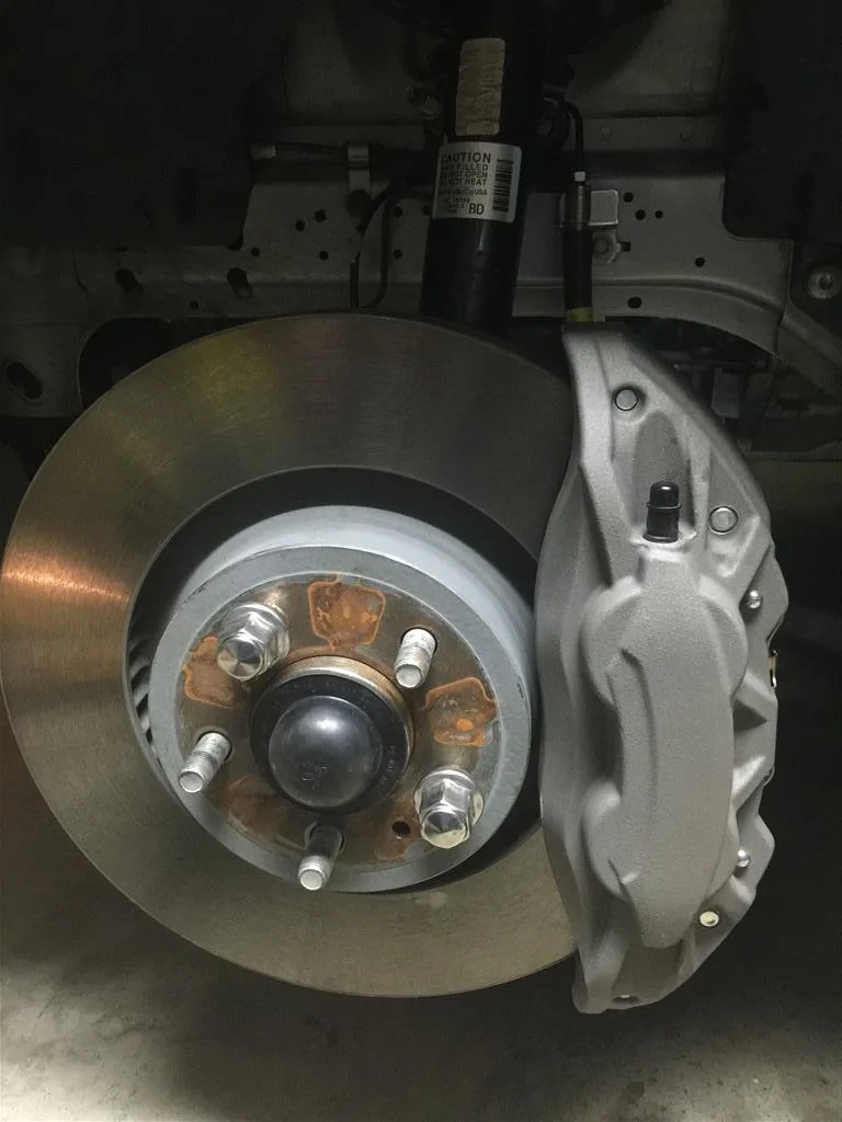

Guys I have more questions. First I picked up prestone synthetic dot 4 brake fluid is that ok to use instead of the motorcaft? Also I got the calipers and rotors I can't believe how big they are. I see the picture of the rotor above is that the one that came with the base model car or the 14 in base gt rotors? The ones I received are not the same as the pic above. But the ones in the pic above look like the ones already on my car with the regular base calipers. Do they have different types of 14in rotors? the 14in I ordered, the vents that go through the rotor are sealed off by the hub if that makes sense. In the pic above you can see they go all the way through for better cooling like the base model ones I already have on the car. I don't know how to upload pics so I hope you understand what I'm saying. Are you using the 14in rotors or the ones that came with your car?

I think they might be rotors from a 2014 mustang I just saw a install video for brembo Brakes and rotors they look exactly like the ones in that video by lmr
