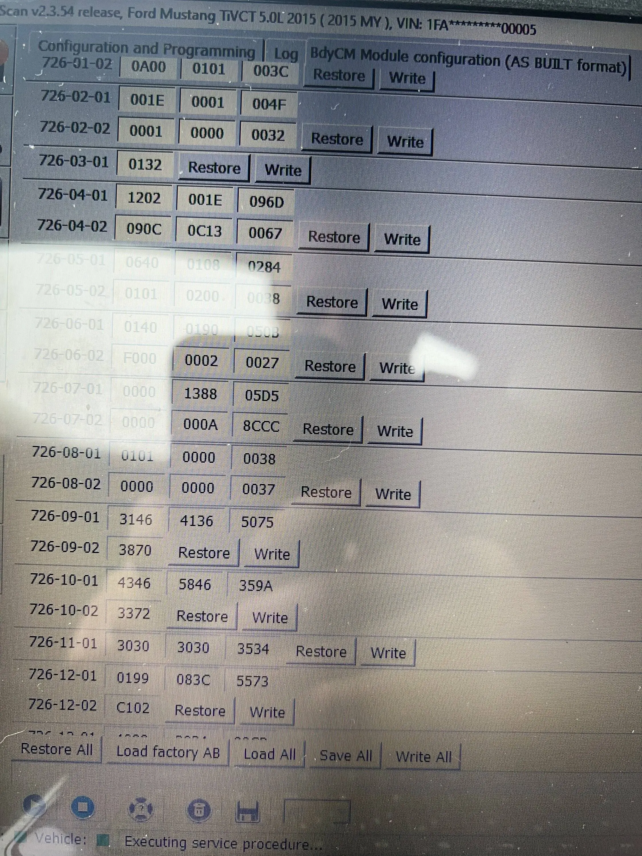

Just bought the car just over a month ago. Worked great, had the gears swapped from 3.31 to 4.09’s and now all kinds of problems :(
is there anything I can check or try with forscan while I wait for a tuners response?
thought this would have been an easy swap. So far it’s just been a nightmare.
I posted the hex codes and address in an earlier post. Try the code for 4.10
It's under the "as built"
726-12-01
Stock
014b
changed on the tuner and it changed to 0199 in forscan.
took for drive, same problem.
Loaded forscan change to 19A.
same problem.
Really stuck and don’t know where to go next.

Going to 1st thing in the morning. Running 265 35 20’s which are 27.3” tall. Verified it is running 083C in forscan.
Will try a 265 65 20 which will give me a roughly 3.33 gear. Which should be 0A1E
will try
from 726-12-01 014B-083C-XXX
to 726-12-01 014b-0A1E-XXX
