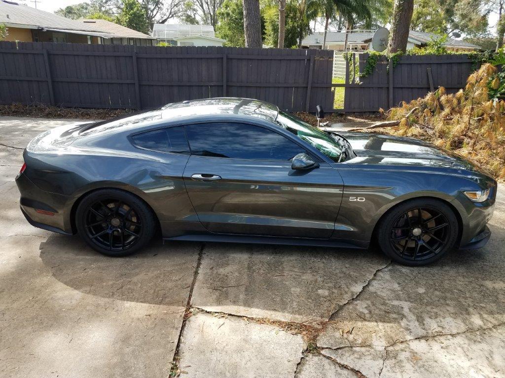

One question, though I suspect you would have commented, but any rubbing...namely at full lock or compression???

I haven't experienced any rubbing at all!

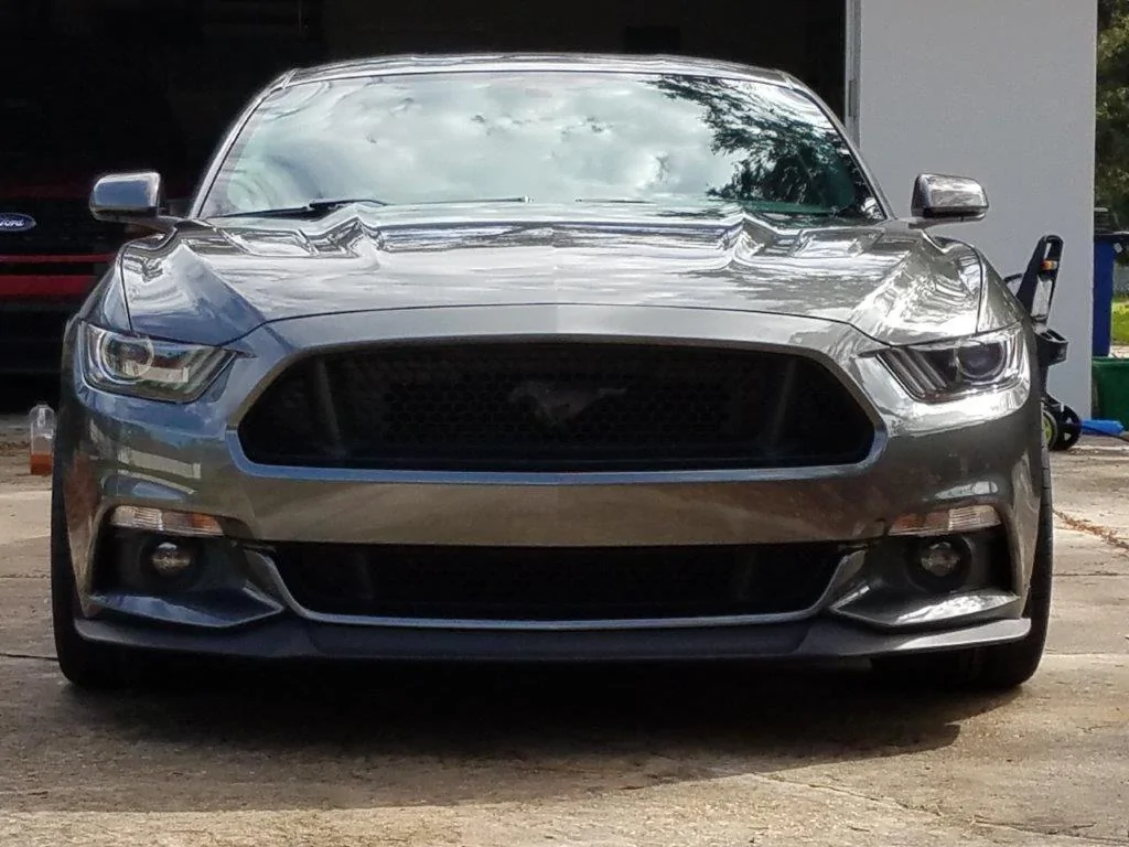

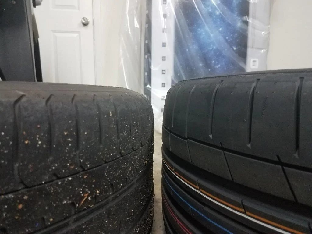

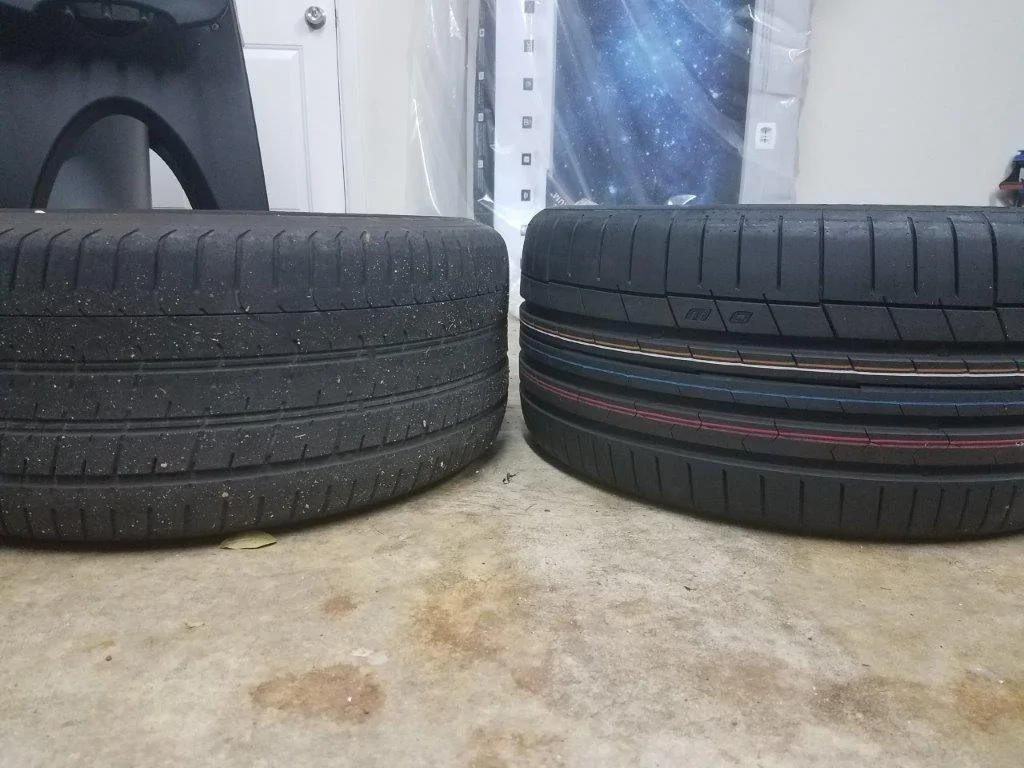

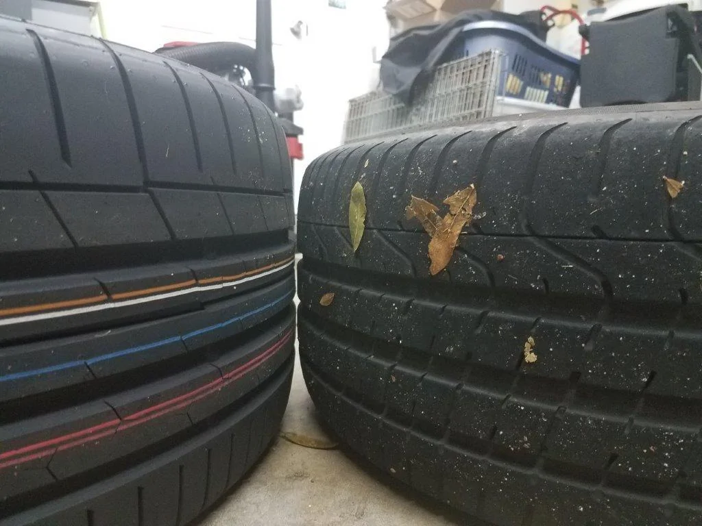

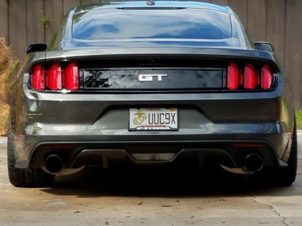

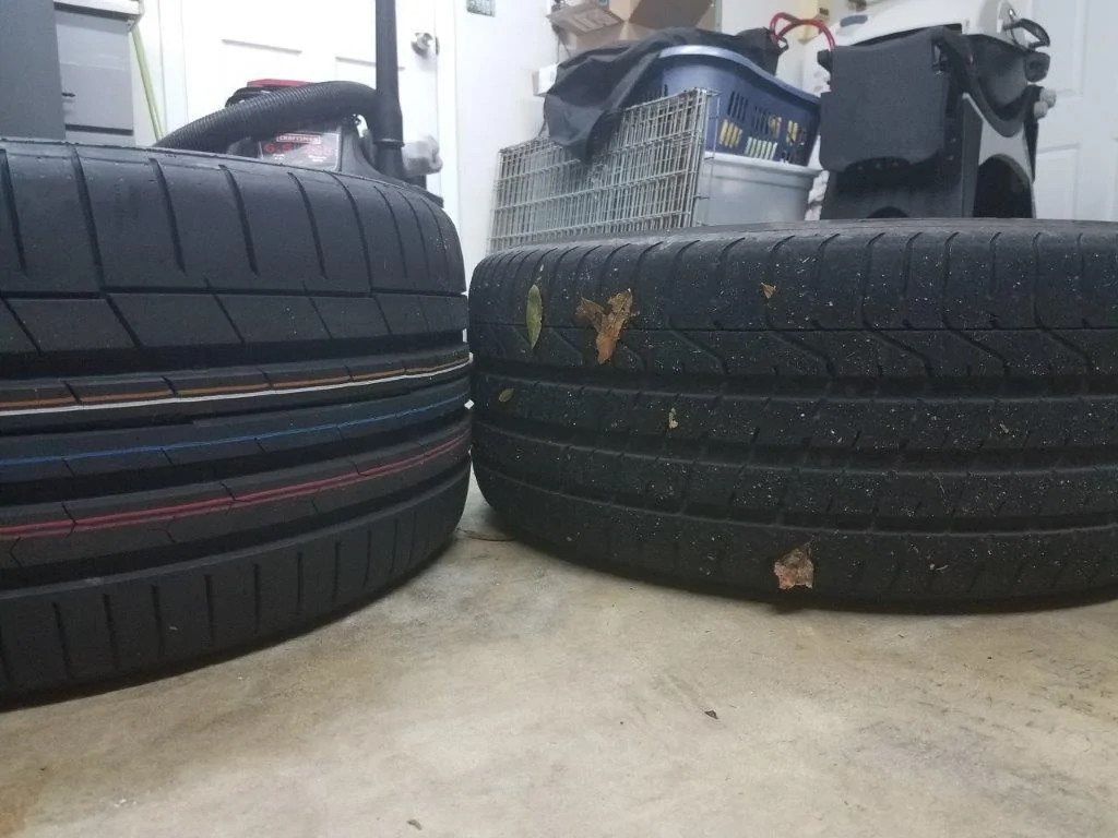

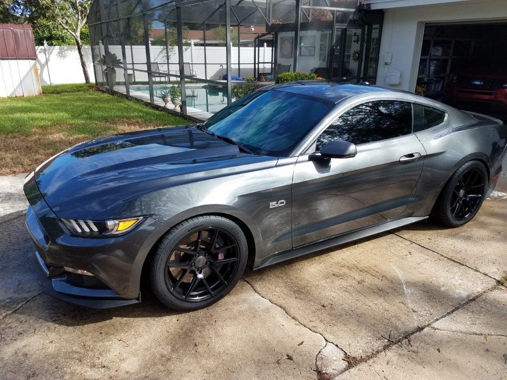

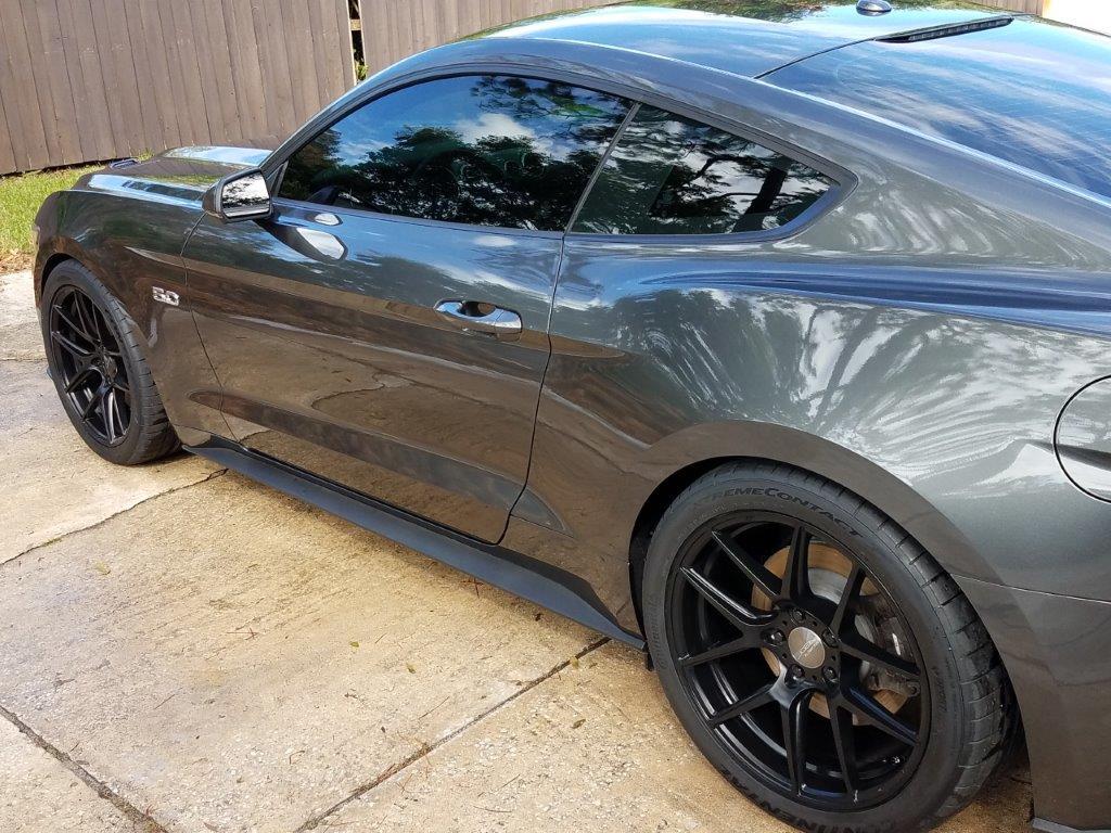

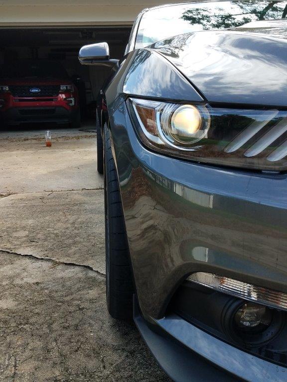

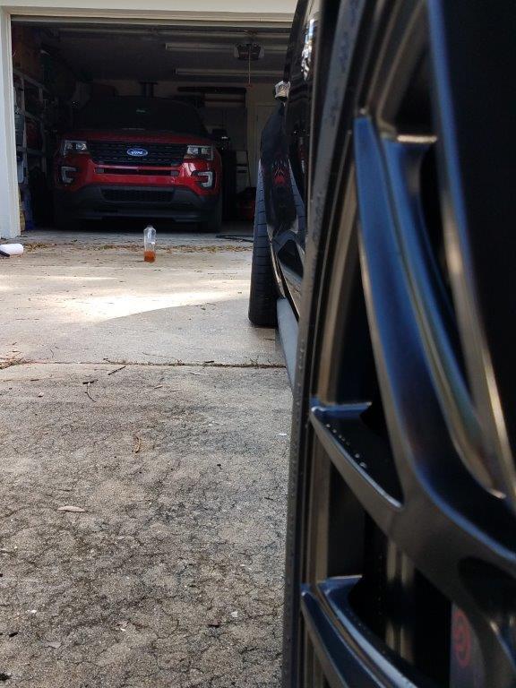

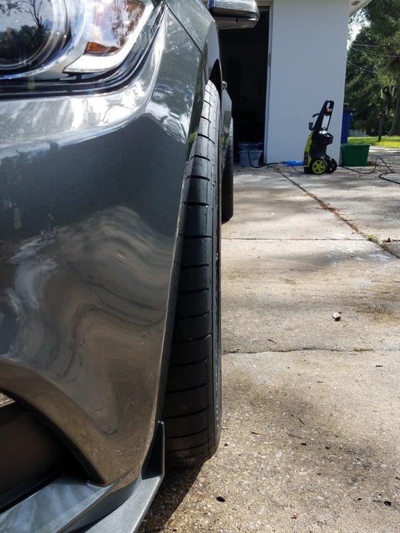

Here's my setup, with thanks to Paul@PKAUTODESIGN and PK Auto Designs. It was a pleasure doing business with him and I highly recommend for the knowledge, information, and quick service once you're ready to buy.
295/35-19 Continental ExtremeContact Sport
19x10 Ace Alloy AFF02 Matte Black 35 offset using 72/62 hubring
Weight:
Wheels only: 24.25 lbs per w/cap
Wheels with 295 tires sensor and wheel weights: 53.95 lbs per
Wheels were coated with Chem Guys Carbon Flex
Suspension: Steeda Linear Sport springs & Pro-Action adjustable dampers
Pics were hard to angle just right, but the fit is flush at the top of the wheel well and starts to poke about halfway down. ZERO clearance issues on the front with plenty of room to spare. It was dark, but looks like about an inch from the strut.
These Contis are 10.3" wide according to Tire Rack. Diameter is 27.1" which matches the stock front diameter, but .6 less than the stock rears. Revs per mile are 767.
Pardon the Hurricane Irma mess and try not to make fun of the stab wound on the bumper. I'm researching body shops to find a good one here in Orlando before I let them touch it.

Bringing this back from the dead. I see you were using the Steeda linears, did you have the camber corrected or are these pics with the natural camber after lowering?

I haven't been on site much lately, but yes the alignment was all corrected by Steeda. Added camber plates as well.
