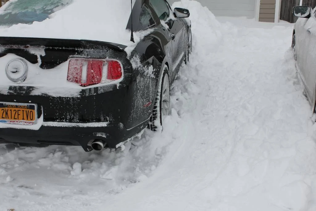

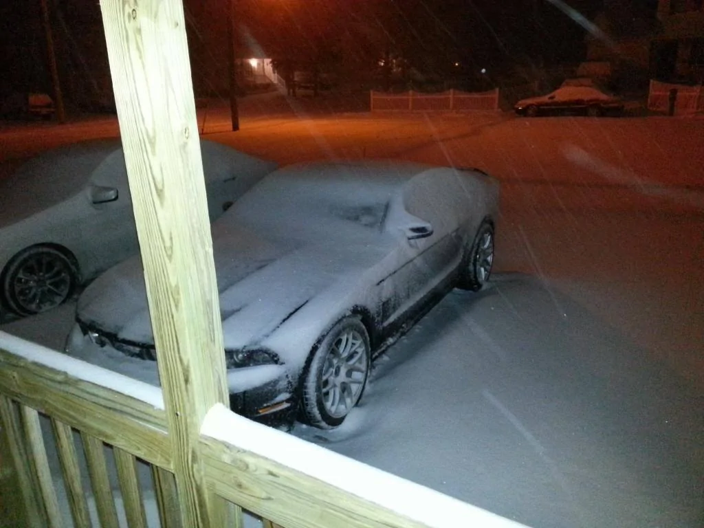

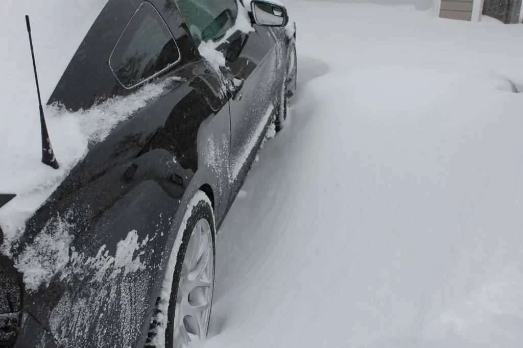

Kbreese
Sep 2, 2014
1,086
233
Long Island, NY
2012 Mustang GT Premium, Black/Saddle.
Nice photos and amazing car/wheels!
Do you drive in those snowy conditions?!
Thanks, brother! And yes, I drive the car year round, its my DD...I have 3 sets of wheels/tires. We had a bad winter last year and I got through it on these 19X9.5 RTR's and 275/40 Conti DWS :cheers:
