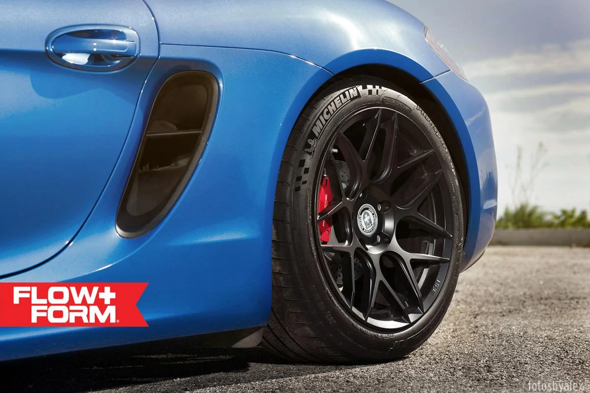

I have searched, and searched, and searched, and... well, you get the idea. It seems absolutely no one has ever run 265/40's on a 19x10 rim for the Mustang. A few 19x9.5's (like RTR Tech-7), but not the 19x10.
What I find interesting, is arguably a slightly stretched 265/40 will actually provide better handling. And I don't mean stretched like some ridiculous pimp-mobile. But instead, stretched by only a 1/2" over recommended width. I started a thread about stretched tires a while ago, but still no takers on trying a 265 stretched tire.
I've talked to some guys who track Porsche Caymans, and they all agree that with the stock 19x10 rims on the Cayman, the 265/40 stretched actually seems to handle the best compared to the 275/40's they tried in the past. All I can figure, is something about a very slight sidewall angle provides more tightness and support when cornering quickly....along with an arguably better contact patch. Not sure how that works though.
In fact, all Formula-1 cars have stretched tires for the given rim width by a good 1-2" on each side. This obviously is in the design to assist in handling to prevent excessive sidewall collapse when cornering.
Heck, i figure, if it's good enough for the Porsche Cayman, then maybe it's good enough for a Mustang. I think I may try this setup for my R350's.
Has anyone else even thought about giving this a shot with the S550?
Pic below is a Cayman with Flow Form 19x10 running 265/40/19

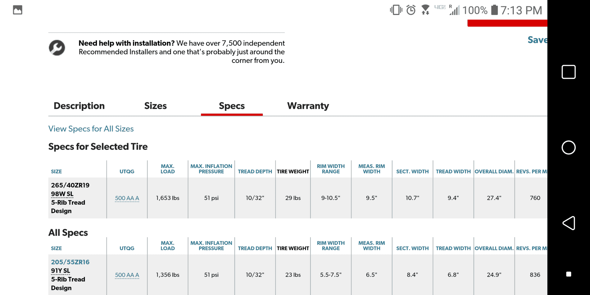

P-Zero Nero came stock on my car in 235's. In snow, they are "almost" useless. We got a terrible snow storm this winter, and if I hadn't grown up in Wisconsin knowing how to drive in snow, my life would have been.... well, fml. But I got home, none the less. I was really thinking about how much better my drive would have been if I had gotten the 265/40 Michelin AS3's instead.
This is basically a perfect fit for handling. See specs. Tread width is just about half an inch under the rim width.
Add to the fact that in that video, that guy got his best performance lap times on the wet track using the 255's squared up with a 3,300lbs car.
So, I'm thinking 265's squared on a 3,720lbs car will be just about perfect for handling in rain, which of course we get A LOT of here in the Seattle area.
