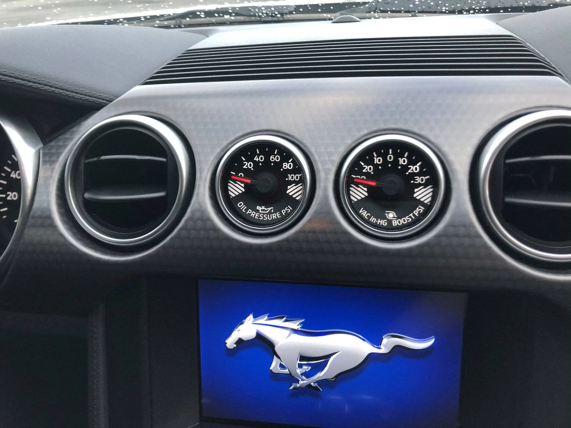

I have an EcoBoost boost gauge so I can see boost when driving even though it’s not mechanical. With the tune reloaded to fix the TB and the pill in, I’m seeing about 2 psi at just a stab of the throttle. Much better than before. I’ll probably experiment with different pill sizes before going with Lund. Thanks for all the great input.

Hey great how does the EcoBoost gauge install work can you do a photo?

Simple plug and play for PP gauge cluster. Just remove trim panel, disconnect wiring harness and remove gauge cluster from trim panel. Works like stock to include MyColor, etc.
