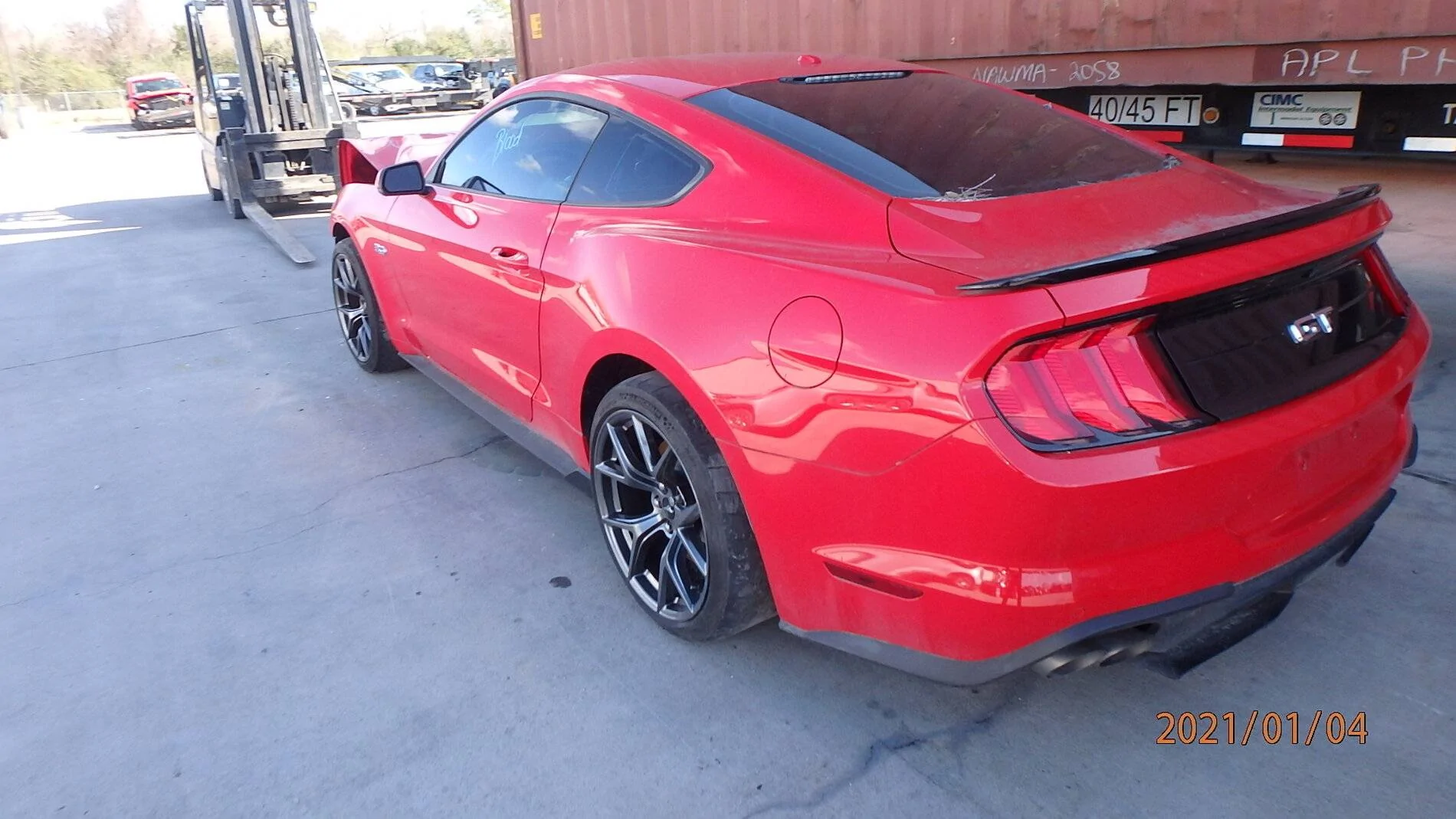

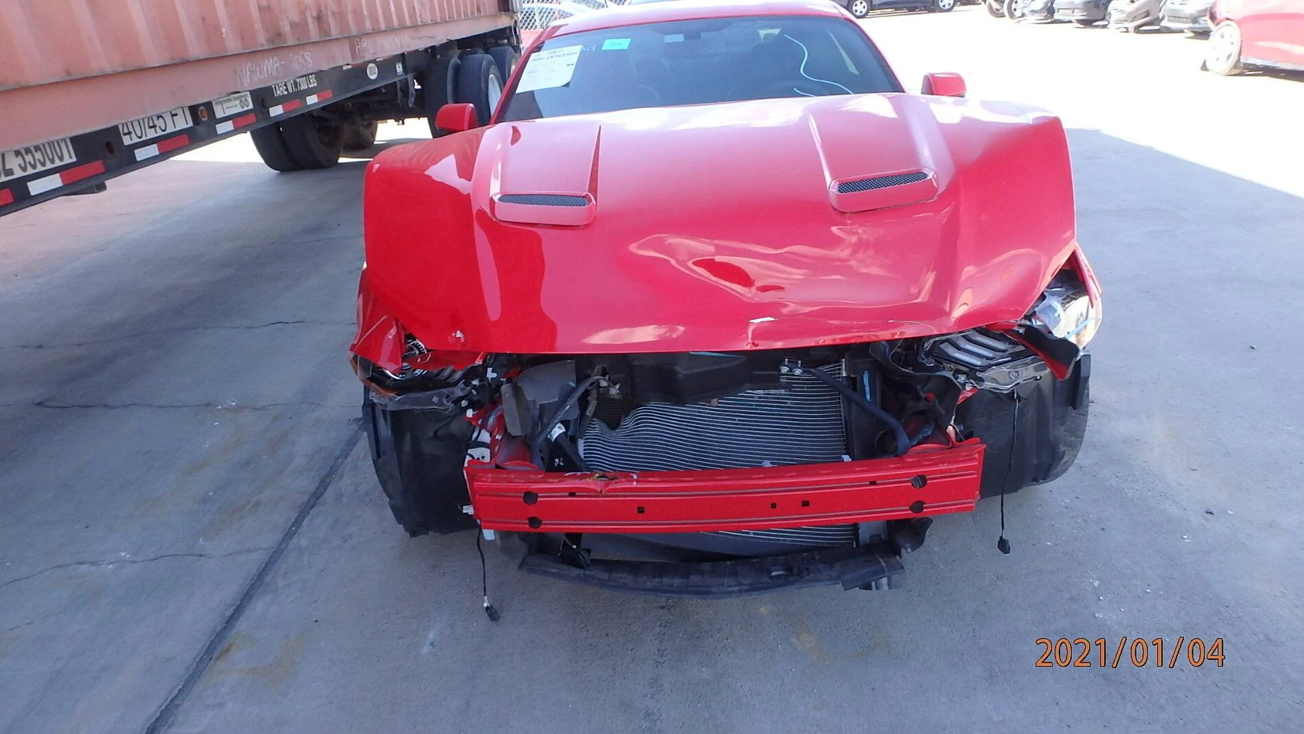

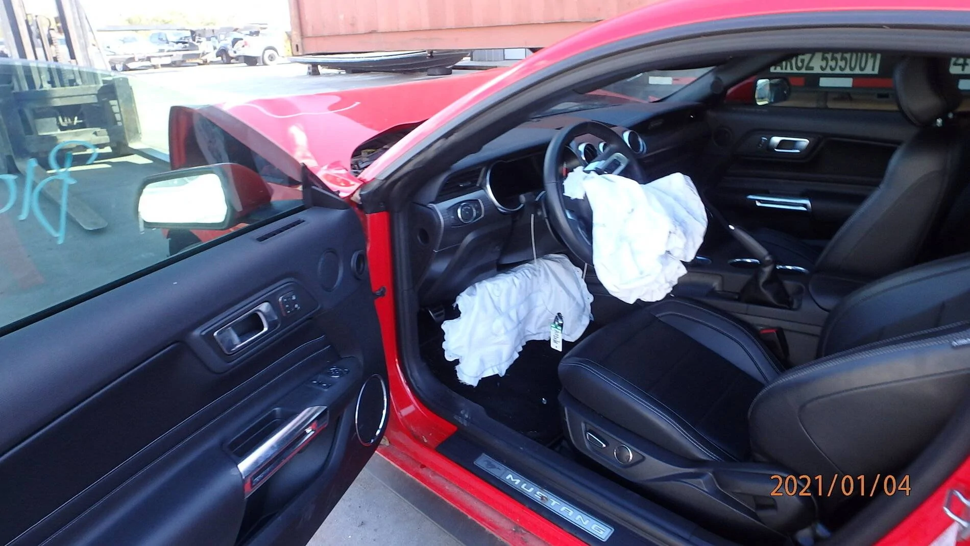

Hi everyone,
I just bought a PP2 at IAA auctions in Houston. This is my second Mustang, bought as a damage car. The first was the 2015 Black Mustang V6 from AT and rebuilt as a GT body look (separate topic). After a year, I started thinking about adding a turbo on my V6, but finally gave myself the chance to buy my first ever V8.
This red one PP2 had an accident in august 2020 in Alvin (TX)
Stang is now ready for shipment and expect that arrive during next few weeks.
I going to collect list of parts and starts to buying necessary part to rebuild that car.
Have heard that the PP2 has different parts, comparing with PP1, does he? Basically I'm not sure for cooling system (radiator) is the same or it's larger than normally? I can't find that simple answer, because in my country Ford doesn't provide the selling of this model!
Maybe you could me help to find the answer?
My car has a front collision, so... question and idea is to buying the Mach1 bumper, but this car is so fresh and you can't order spare parts. PP2 is similar to Mach1, does he?

As has been indicated here you should be able to find production numbers (not necessarily actual part numbers) which will in large measure map you to Ford part numbers with dealer. I have a race red 2020 PP2 with 147 miles on it waiting for warm weather as I sit here watching it snow outside. I'm happy to help you as far as identifying stuff you'll need to get yours road worthy.
I'd stick with keeping it PP2 authentic. So I'd put the correct splitter and fascia etc.
Rest of what you might need are possibly front suspension components if damaged be sure to use the correct PP2 parts where differentiated as Ford deliberately used those component parts in calibrating handling and suspension geometry factors for this package. Not that you can't tweak what was there but to me having the stock baseline is always a good place to start any build.... and PP2 is a pretty damn solid package from my experience.
And you'll have expense in evaluating making certain the airbags are of highest quality if they can't be packed with new clocksprings etc. That's all Ford factory tech and dealer stuff in my opinion.... I Never repair and install such safety devices with third party non factory Ford people when it comes to safety standards.

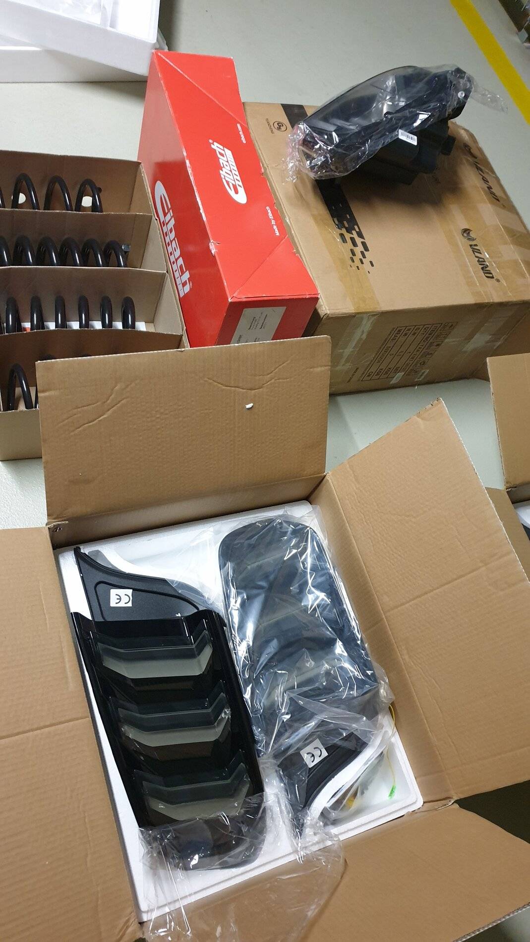

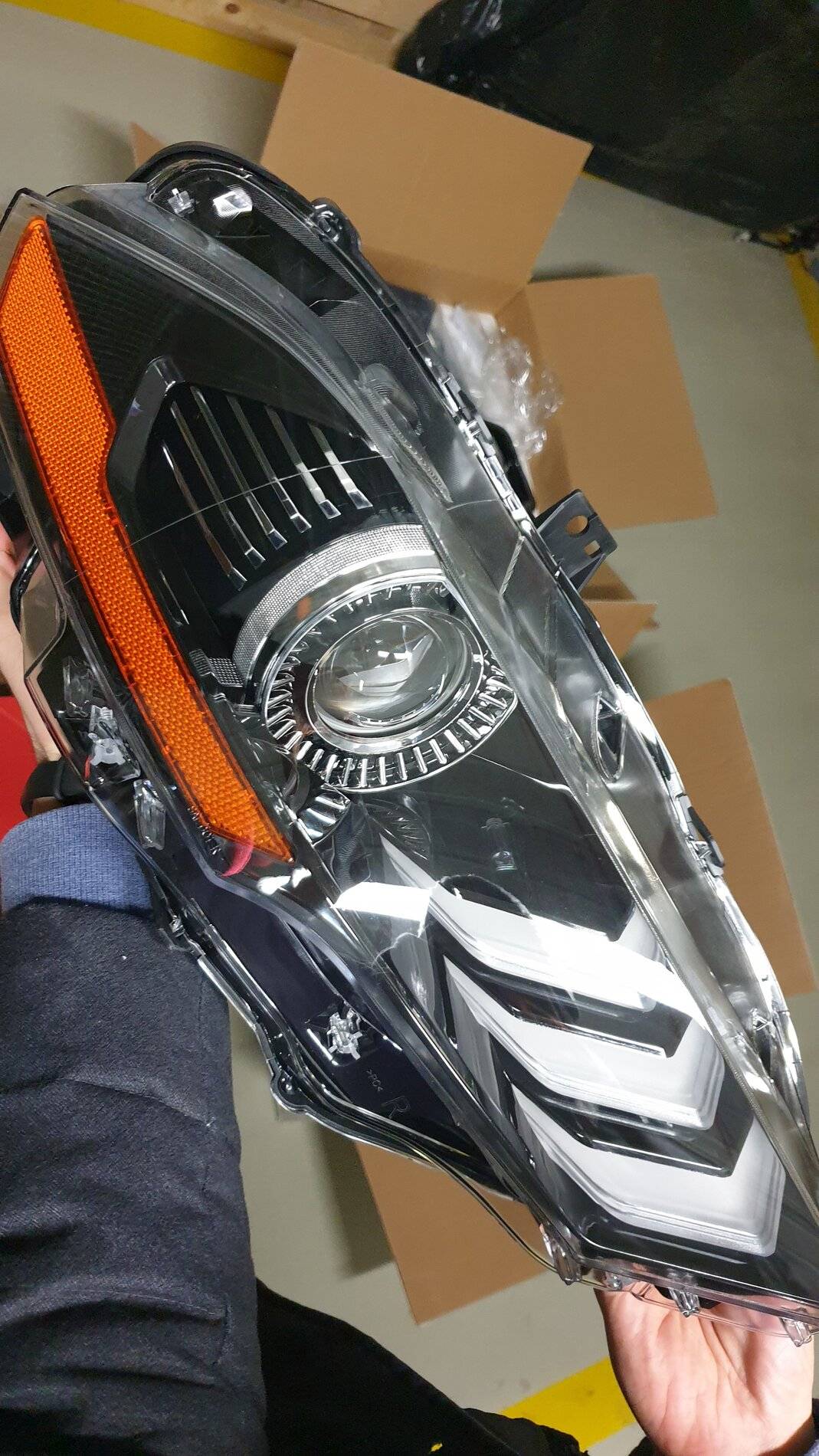

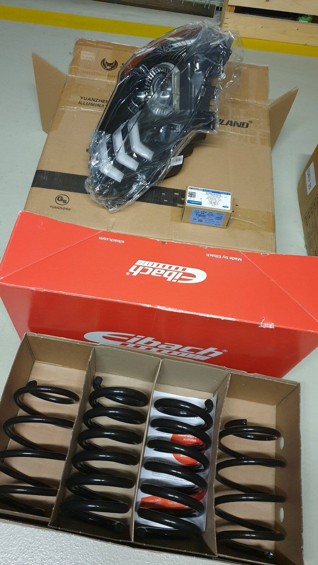

Thank you all for your activities!
The PP2 is in EU.
Just confirmed, that cooling radiator is the same like PP1 :)
Still have a problem with order the completely bumper from new Mach1.
Right now collecting the parts.
First delivery on picture.
Stay tuned!
