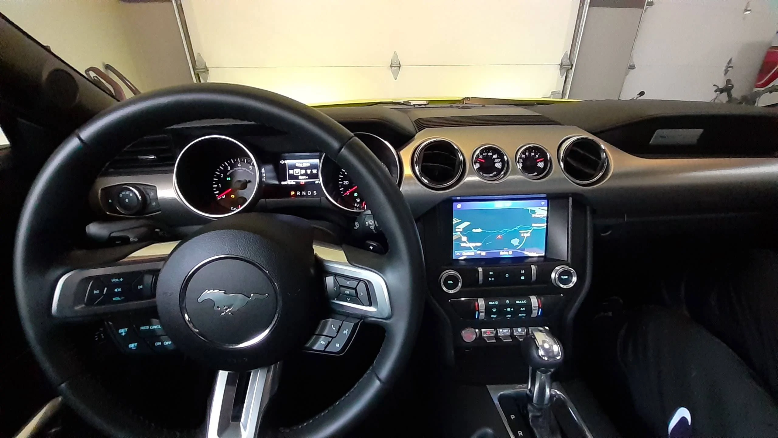

I swapped to an 8" and activated drive mode in my 2021 Mustang Gt non-pp auto from a 2021 Mustang. The hardware was plug and play and I made these three changes.
- ABS 760-02-02 xxxx-3xxx
- IPC 720-06-01 6C7F-8000-18B1
- BDYCM 726-41-01 2nd digit from 1 to 0.
