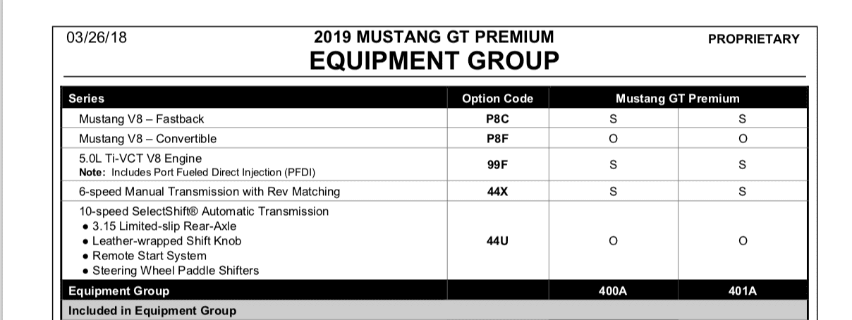

I'm guessing I'm reading it totally different from others. I understand it in the sentence/article you quoted as the author highlighting the performance of having the rev match and PP. I think many are reading to much into what the author is trying to say. Earlier in the article it states
Legend of innovation continues with addition of rev-matching technology for powerful 5.0-liter 6-speed-equipped Mustang GT
So it seems to me that it would be standard on GTs. Additionally, I just looked at the order guide and it's showing rev match is standard.
Bravo
Jul 26, 2017
355
76
New England
German Turbo Box
Thanks for posting that order guide photo :D I couldn't wrap my head around why Ford would only include the auto rev match with PP when it really just as much of a comfort feature as it is a performance feature.
