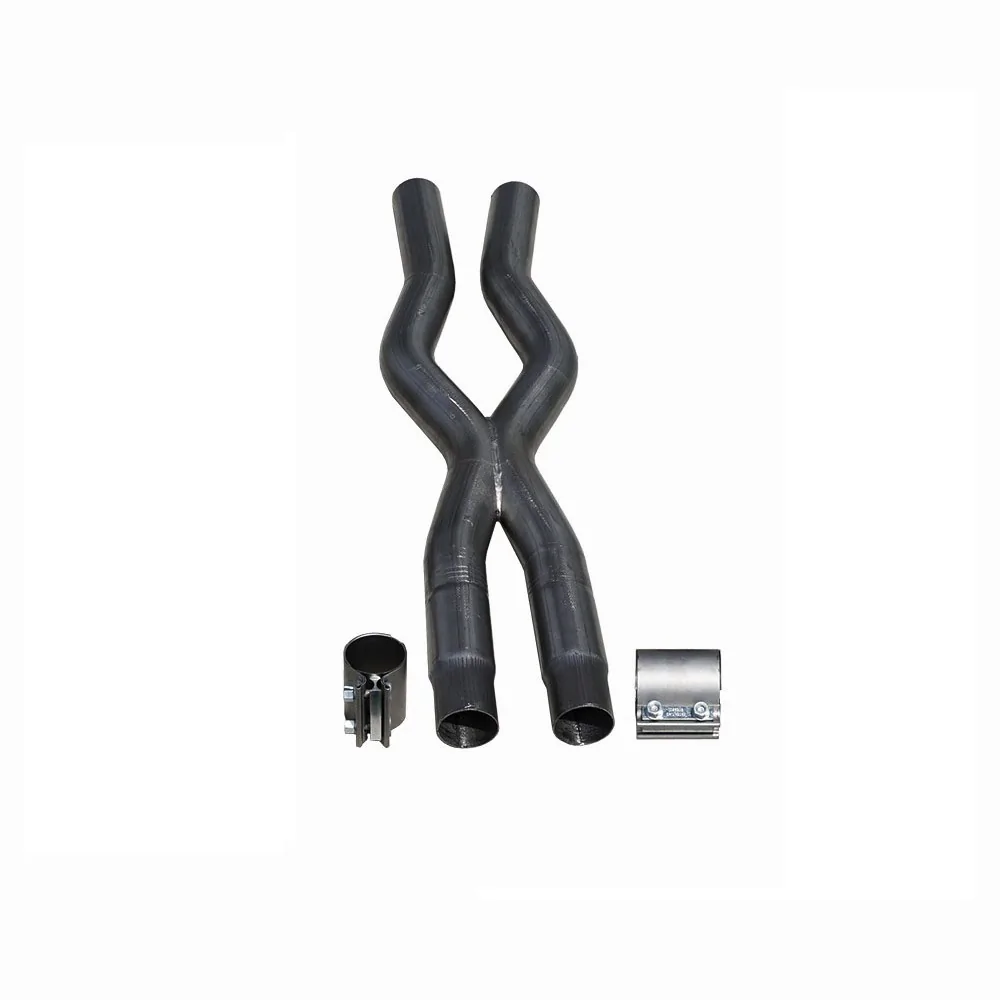

Thanks for the feedback. I ordered an SVE X pipe yesterday night. At $119 if it's too loud, it won't be a big deal...

I have the SVE, as the design is the same as most options and it is cheaper. I didn't see a point in an SS X-pipe, as the rest of the exhaust isn't SS. All the x-pipes that share the SVE design suck for sealing, and really need to be welded in. My only complaint, other than poor sealing, is the added rasp. However, I will likely deal with it for a year or so, then add a full exhaust with long tubes.

I just had the local shop fix another small leak on my SVE. Now that it is 100% welded, the sound is perfect. Much less rasp. IMO, you should have the back side welded in. Even a tiny leak greatly increases the raspy sound.

Installed my X pipe on my 2018 GT PP1 this morning
You were right at light loads and stabilized speed the sound volume is almost identical which is a relief. No drone.
At full throttle the exhaust note is louder inside the cabin, but not so much. From the outside though the car is a lot louder, especially with windows down.
Cold start is really noisy...My neighbours won't like it :ninja:
Not too bad, but I was expecting more at high rpm...
