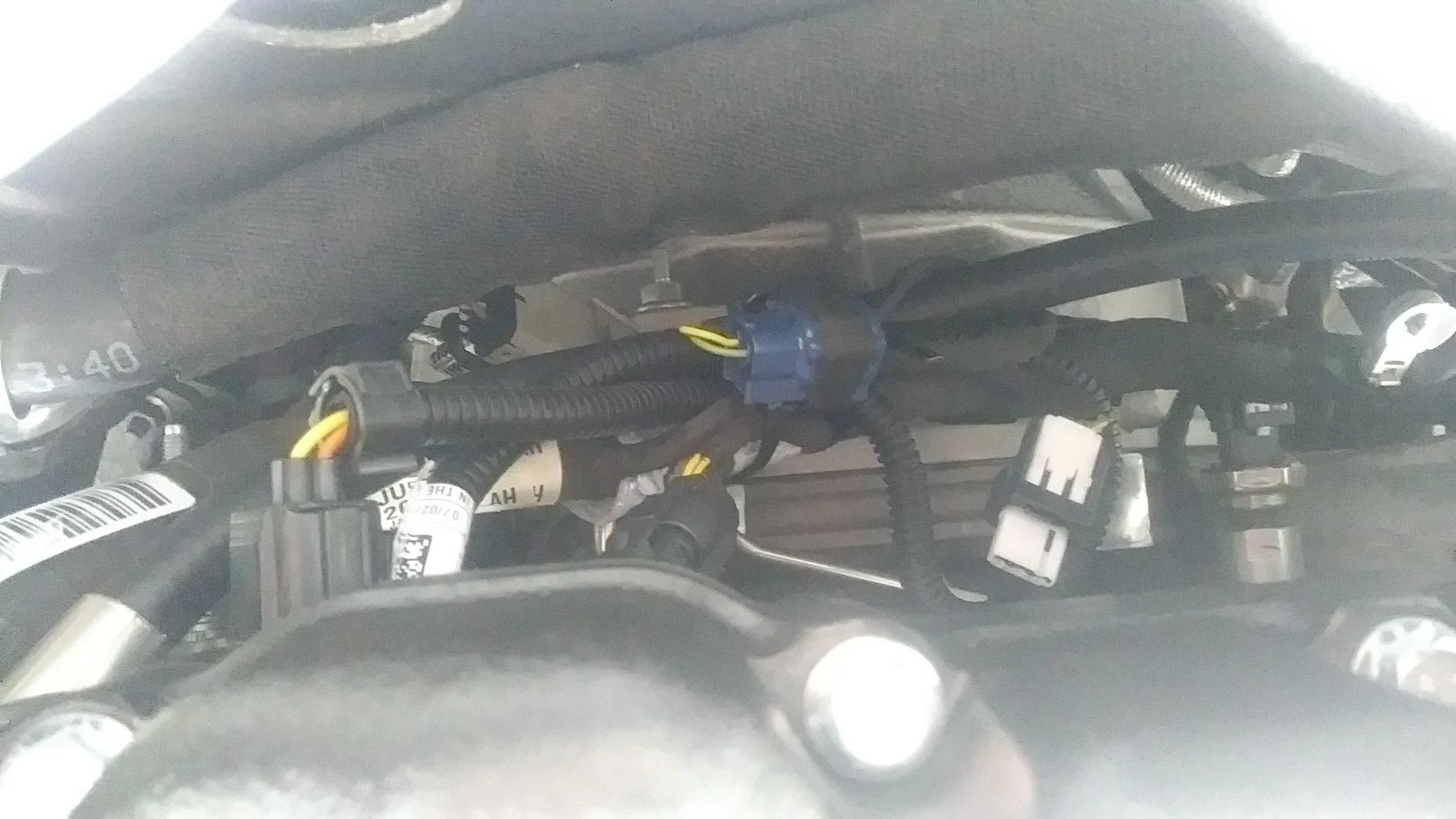

hey mike, here is a pic of the back if manifold, you can see the OPEN connector on the right, now the one to unplug is ???? I can send you a better pic if you need?? Let me know asap if you can. My son is napping , this is a good time for me to mess around.. Ya know.. Tha ks a bunch. Scott

Mike,, I am 99% sure I found it and switxhed it. The open one has a blue and white wire,, that is what Joe from whipple emailed me. I finally got a good look in there and saw it. I have now switched and am going to reflash the car and that will obviously tell me if I'm right.. Thanks for your help.

I GOT IT.. I reflashed the new tune and car runs PERFECT. I was reading what you advised along with the emails from Jeff at whipple and I finally was able to move the wires around ENOUGH to see the one wire that was BLUE with a white stripe and the I knew I had the correct harness from what one of the emails said. It was literally the ONLY ONE that had any type of blue wire, also from what you mentioned about following the connection from the blower, etc. And once I got on an open road and hit the gas,,, bammm! No throttle bogging! SUCCESS! THANK YOU SOOOO MUCH for your help! I was hoping someone out there had experienced this issue. Thanks again mike! .....Scott.. ...✌
