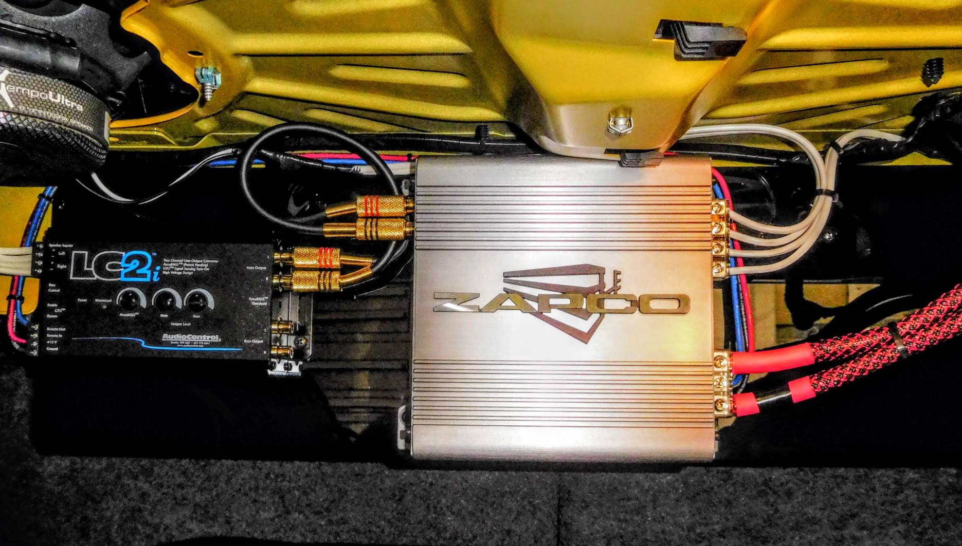

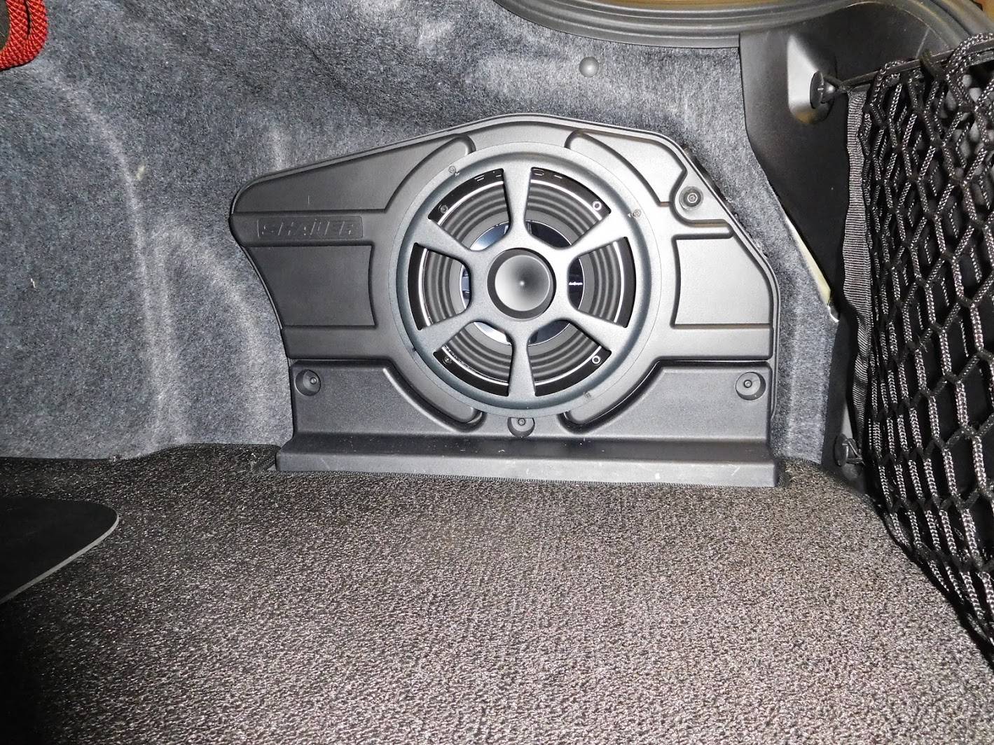

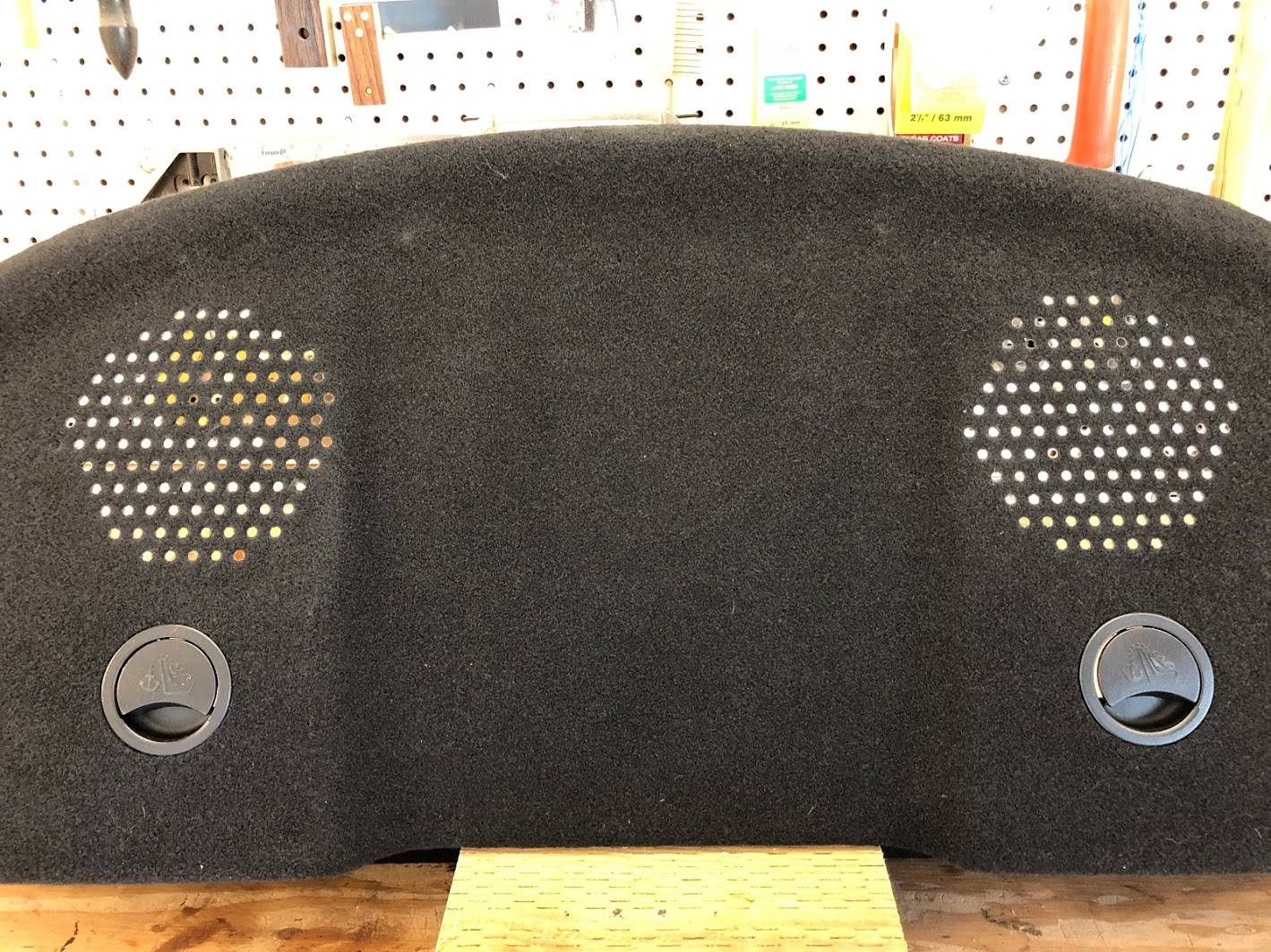

I upgraded the rear speakers to Morel Tempo Ultra's, added the LC2i DSP, a Zapco 2 channel amp to power the Morels and upgraded the OEM sub to a Rockford Fosgate and stuffed the sub enclosure with polyfil and perforated the rear deck lid to let the sound thru from the Morels.

looking at the image of your LC2I, where did you tap into power, remote and ground for the unit? In the image, it may be the way things are situated and the angle of pic, but it appears those wires from the LC2i are going into the amp to the right of it?
Is there any factory harness in the trunk to tap 12v power from for the LC2i or amp, or did you have to run up to the front of the car?

You got to run your power. You won’t tap that power anywhere in stock wiring.

The LC2i's power wires are landed on the amp as are the cables running from the battery (the big red ones) . You don't need a remote on wire with the LC2i as it senses voltage from the speaker input when the head unit is turned on and the amp turns on when it senses signal from the LC2i.
