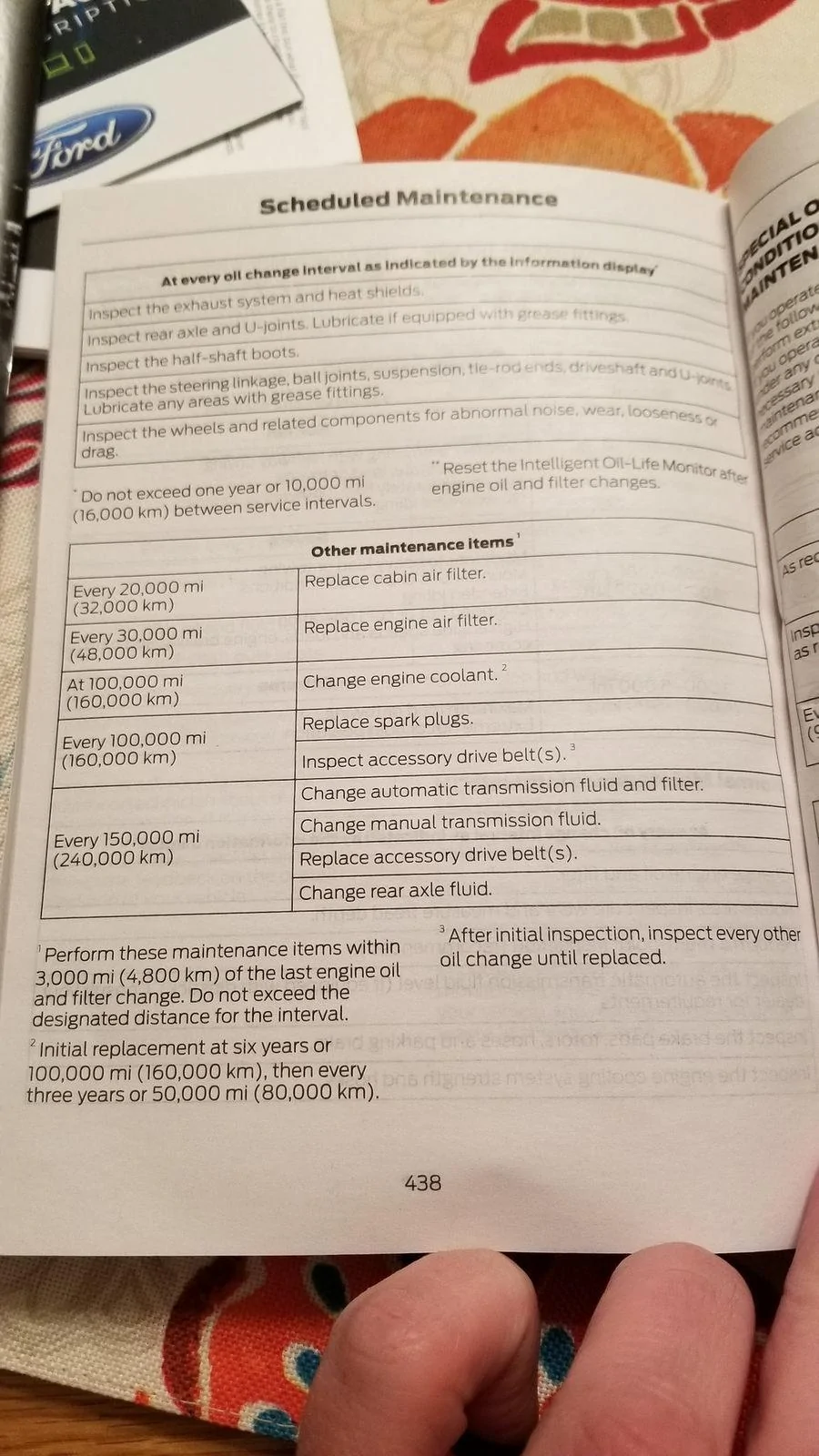

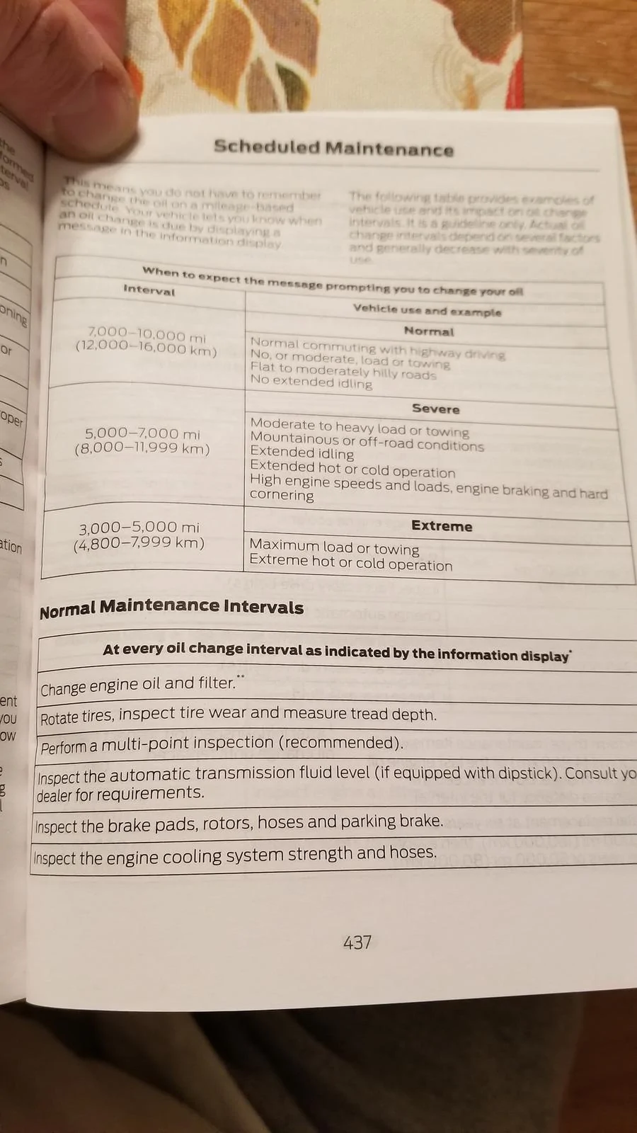

Does anyone know where to get a copy of the maintenance schedule for a 2018 Mustang? I was surprised that the car didn't come with a printed owner's manual (sign of the times?). When I found the pdf version, I couldn't find a traditional schedule that shows what is required every 10K/20K/30K, etc. All the other cars I have ever bought (Japanese and German) came with a detailed schedule of maintenance. I found the Ford service site site where you put in yr, make, and model, but the Mustang isn't listed. Strange.

Mine came with a paper owners manual. Let me go check if the maintenance sched is in it.

Thank you. Now I see that in the pdf as well. Must have been a brain fart on my part :headbonk:
