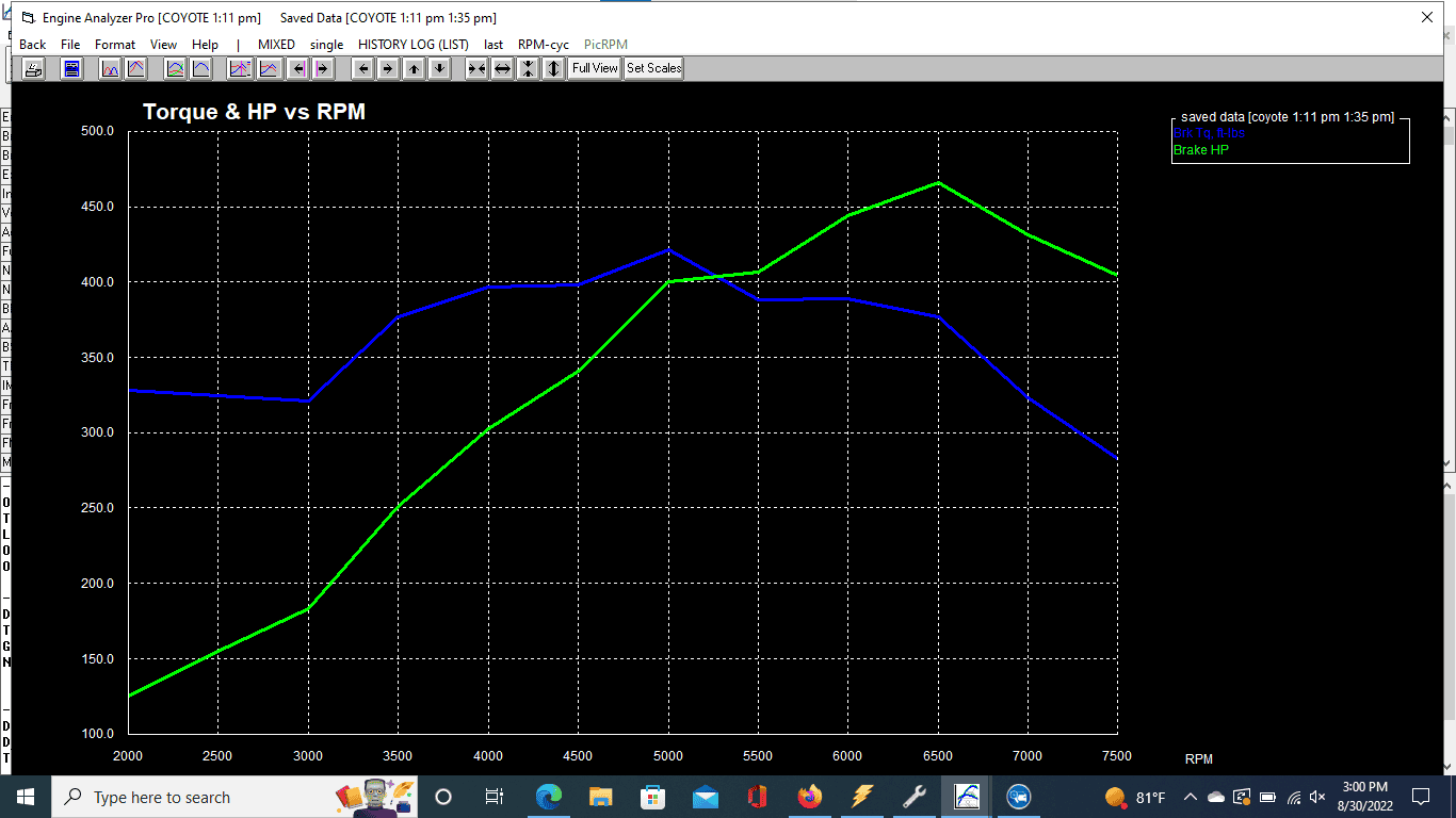

This is using GT350 manifold specs

How is the software accounting for vvt? They push the intake cam way back up top, like to a 135 centerline. Maybe that’s the only reason coyotes make power up top in spite of such long runners.
K4fxd
K4fxd
Apr 2, 2020
122
13,495
12,324
NKY
Dan
2017 gt, 2002 FXDWG, 2008 C6,
I can step it or ramp it in. I run 89 Intake centerline to 4000 then ramp it to 130 which is the max allowed.
-20 ramping to +20
The exhaust is happiest at 108 or 15 It does show slight gains moving it around, <5 HP. I might play with it on the drag strip
The CJ manifold works well in the model it aligns with some actual dyno curves I found floating around.

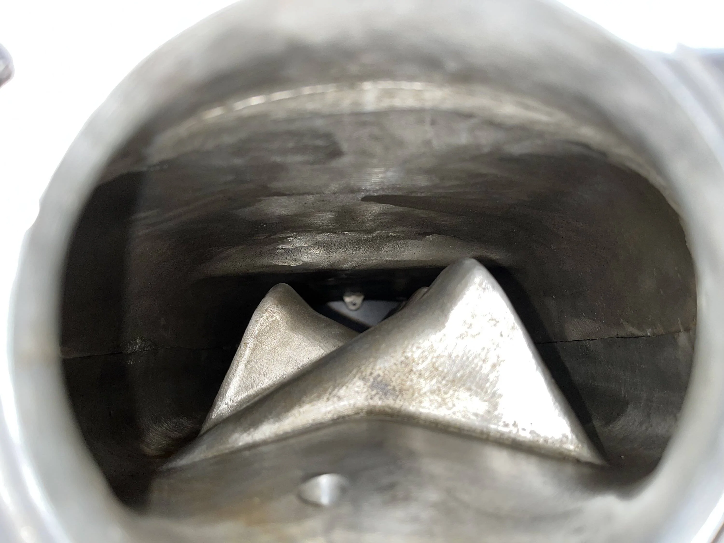

Hey @K4fxd, forgot about it yesterday but remembered tonight. Edelbrock Victor runners are 10.75” in length for the roof of the port and 9.5” in length for the port floor. It’s really a decent manifold base I think but, at least in my very unprofessional opinion, the plenum roof is too close to the top of the port entry and the entry isn’t enough of a Venturi. And once it came out at its high price tag Ford dropped the 18 which basically shares the same powerband, isn’t going to heat soak like aluminum and doesn’t have height clearance issues all for a much lower price
