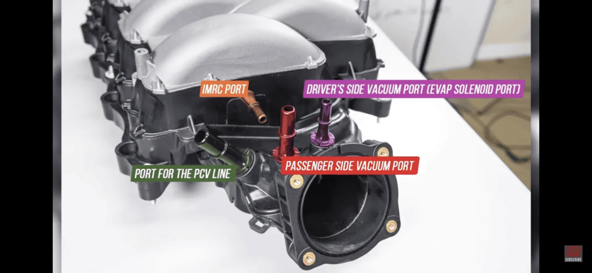

I have used the 2018 manifold on my 2015. I now have the boss both work about the same. You will have to change some vacuum lines around but no big deal. Here’s where they go
This applies the same if IMRC delete is added?
