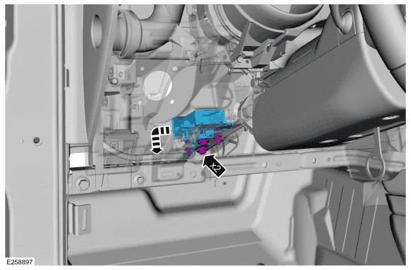

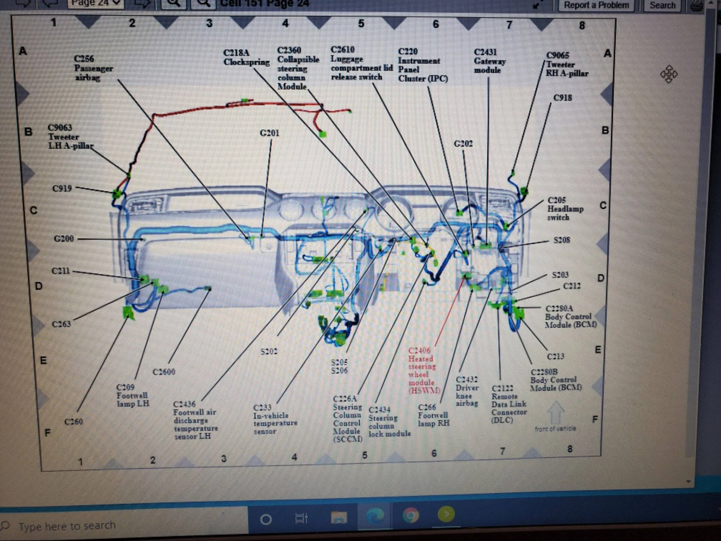

Hello,
Can someone please help me locate the Heated Steering Wheel Module HSWM on a RHD mustang 2018+???
Have have tried following the loom back from the wheel but no luck.
Assistance is very much appreciated!

Can anyone please let me know the location of the module??

On a left hand drive it is at the base of the steering column .

And on the rhd

Cheers guys!
