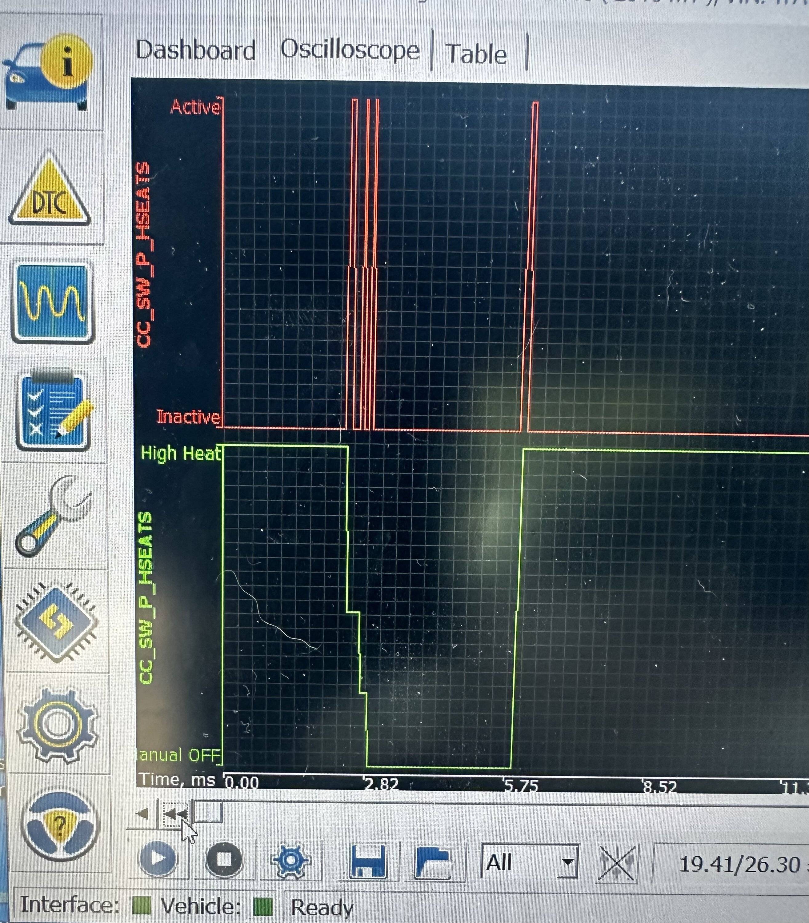

I did notice under the Oscilloscope that engaging either Heated/cooled triggers them from “active” and then immediately back to “inactive”, however the CC_SW_P_HSEATS value shows “manual high heat” so the lights recognize that they are on, but something in the controller disables them immediately while leaving the control lights on.
you can see in the image above each time the button was manually pressed to change the level.
