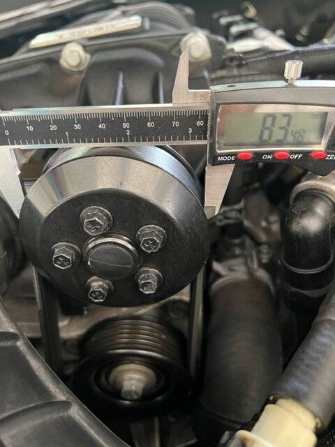

I bought a used car that had the above setup. Is there a way to set boost limits easily? I would imagine I have to somehow get into custom tuning the car, but I really don't know much about tuneing. I know the basics about how superchargers work, what mixuture and timing has to do to avoid detonation at high boost, etc. I just want to bulletproof this engine somewhat by limiting boost and I know the roush has a type of bypass, it would just be cool if there was a manual adjustment to limit it to say 9 PSI. Would a larger supercharger pulley be the way to go, like a griptec 3.2 inch or something? Current pulley I measured to 83mm OVER the belt.

Looks like the supplied pulley is 80 mm or 3.15”. Dropping to 3.2 would make hardly any difference. I think I’d be shooting for 3.4-3.5 in your situation.

Measuring the top side of the belt isn’t accurate. By mechanical function, the bottom of the valleys give the correct pulley diameter.
