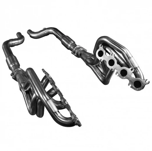

New to the Ford world- I'm not looking for top of the line or the cheapest either.
I'm aware that cat-less is the best way to go power wise but is a set up with cats worth it? I plan on getting an intake, headers, tune. I already have an X pipe and axle back.
Also- are both options "bolt on," or do they require cutting?

There are mid pipes available for both that make them bolt-on.
What are some reputable options/brands? Also, what is the difference in sizing? I'm assuming the bigger the better? Goal is to keep it NA, I know that makes a diff sometimes as well.

The headers offered with cats feature a high flow cat design that is much better then the factory for power. When I tested mine with and without cats I only saw a 1hp difference with cats on for example. Even the "Green Cats" which are supposed to be able to pass an emissions test will not rob the hp the factory cats do. I would caution you that there has been mixed results about passing emissions with most of the high flow cats out there. The tuner can turn off the rear o2 sensors to keep from check engine lights but the readyness monitors will not be complete. In some states this will cause you to fail an emissions test. The only way to be sure to pass is to use Mak cat delete pipes and reinstall the factory cats for emissions testing when the time comes. From my testing the cat delete pipes will make most of the power long tubes will but are not nearly as difficult to reverse for emissions testing.

Most brands available are really good and make about the same power. Just avoid no name ebay crap and you will be ok. Stainless works or performance (econo line), Texas speed, are some cheaper options. American Racing or Kooks are some of the best quality but at a premium price. I would go with the 1 7/8". They are proven.

We're running the Kooks 1-7/8" headers with offroad pipes on our 2018 GT. They went in without any issues and fit great. We picked up some great power with them and saw some great improvements at the track as well.
We also offer headers from ARH, MBRP, Corsa and JBA
Give us a shout and we'll be glad to assist you.
