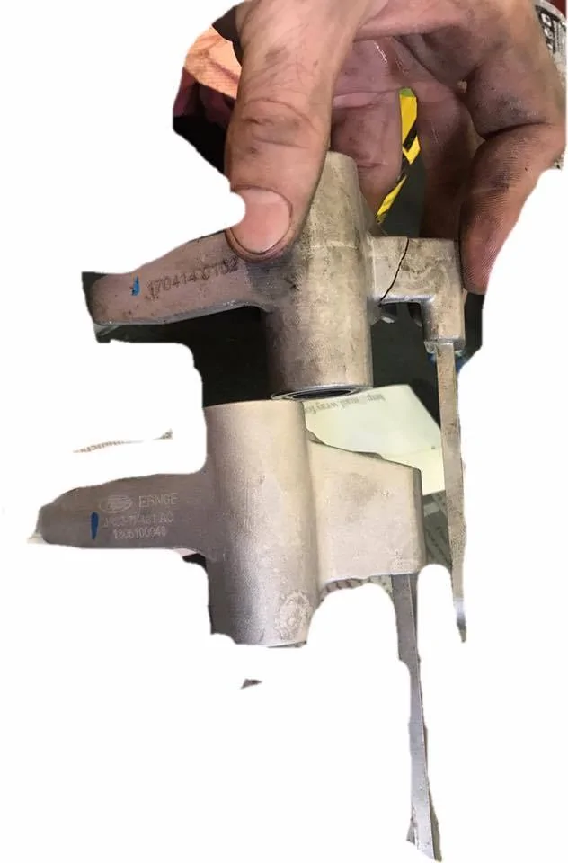

You're pointing blame in the wrong direction. The engineers who designed those aluminum forks is a good place, though. The gen 2 MT82 has no such issues with its steel forks. Designing something to be cast aluminum isn't impossible but requires a very different design. Also, cast aluminum is very brittle and not a good choice for something seeing high impact loads.
I saw this picture on Facebook from someone who had the repair done. The original is a joke. The redesigned part is definitely beefier but it still looks like a cast piece of garbage. I think a permanent fix won't come around until the aftermarket digs in and comes up with a better solution.
chrishammondx
chrishammondx
Aug 4, 2018
41
Hammond
www.facebook.com
Chris
2018 Mustang GT Base MT82
Geez! Thicc! Service guy told me it's revised and the part# has changed for it

That is definitely an improved design. It almost looks like an engineer did it...
