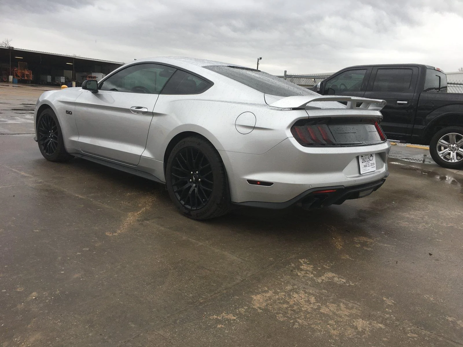

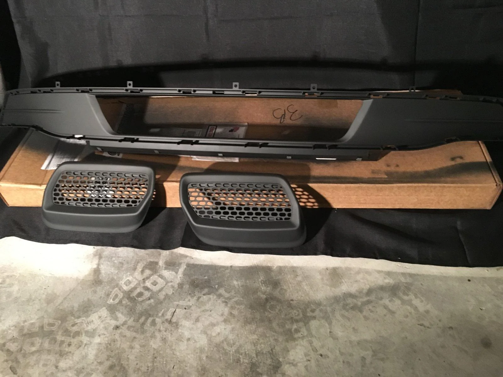

Picked up 3 weeks ago with ~1300 miles - 2018 300a pp1 a10 w/ Corsa sport cat bacK. The plan is to carry the gloss black theme of the upper grill and pp1 wheels through to the roof, RTR hood vents, lower grill and eventually front spoiler, side skirt moldings and rear valence. Here’s where I’m at so far....

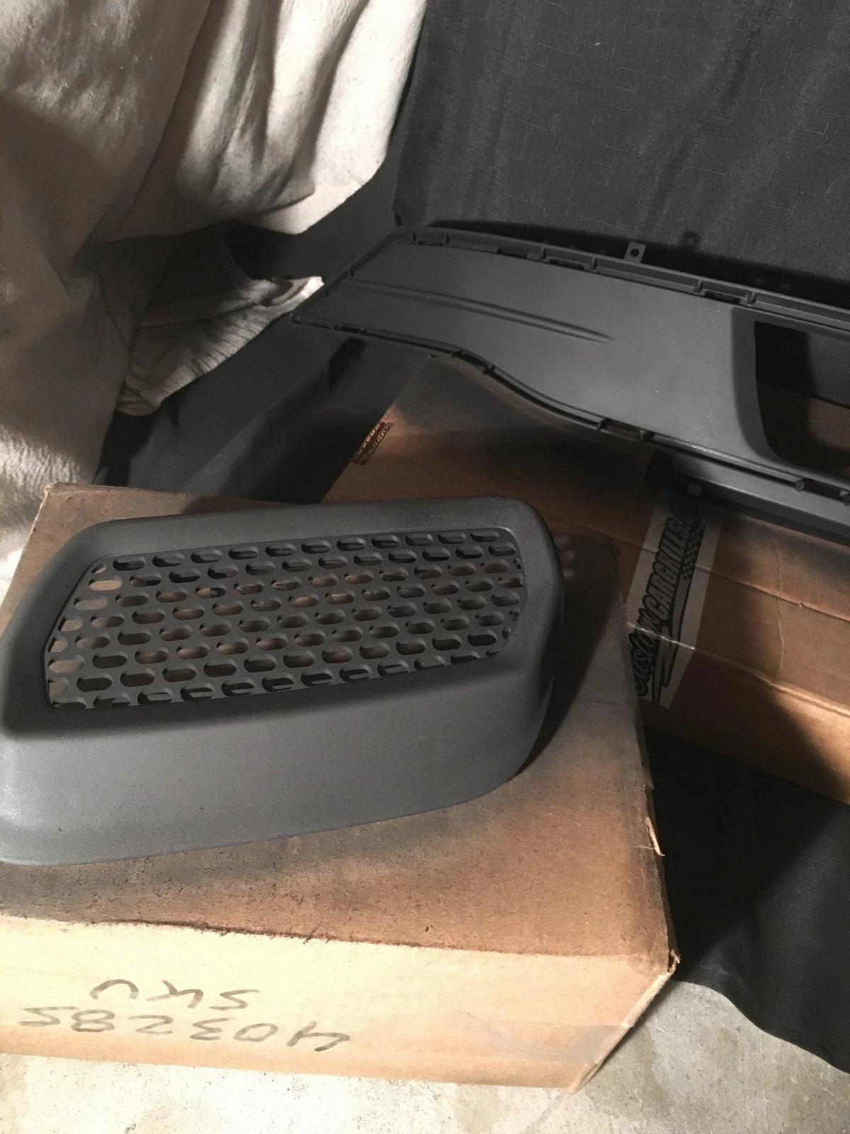

Yesterday’s progress....

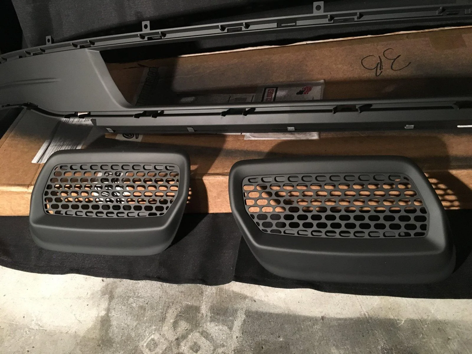

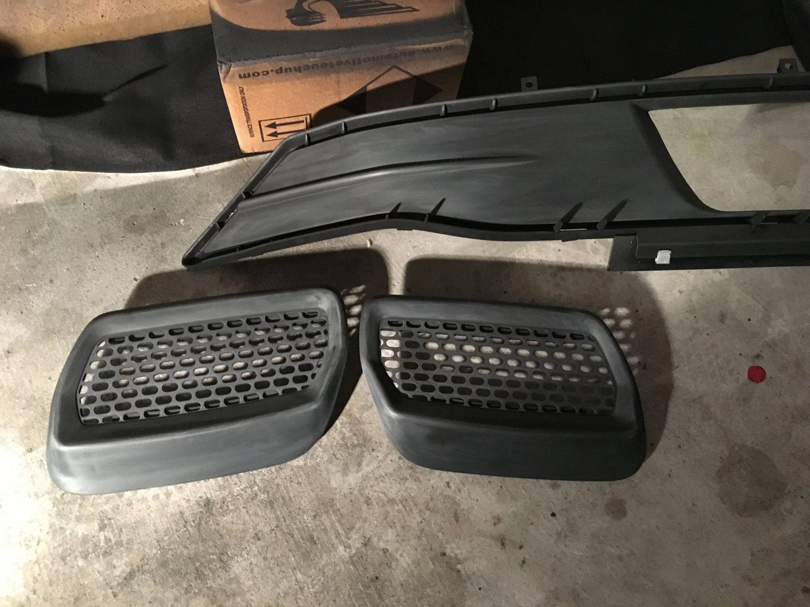

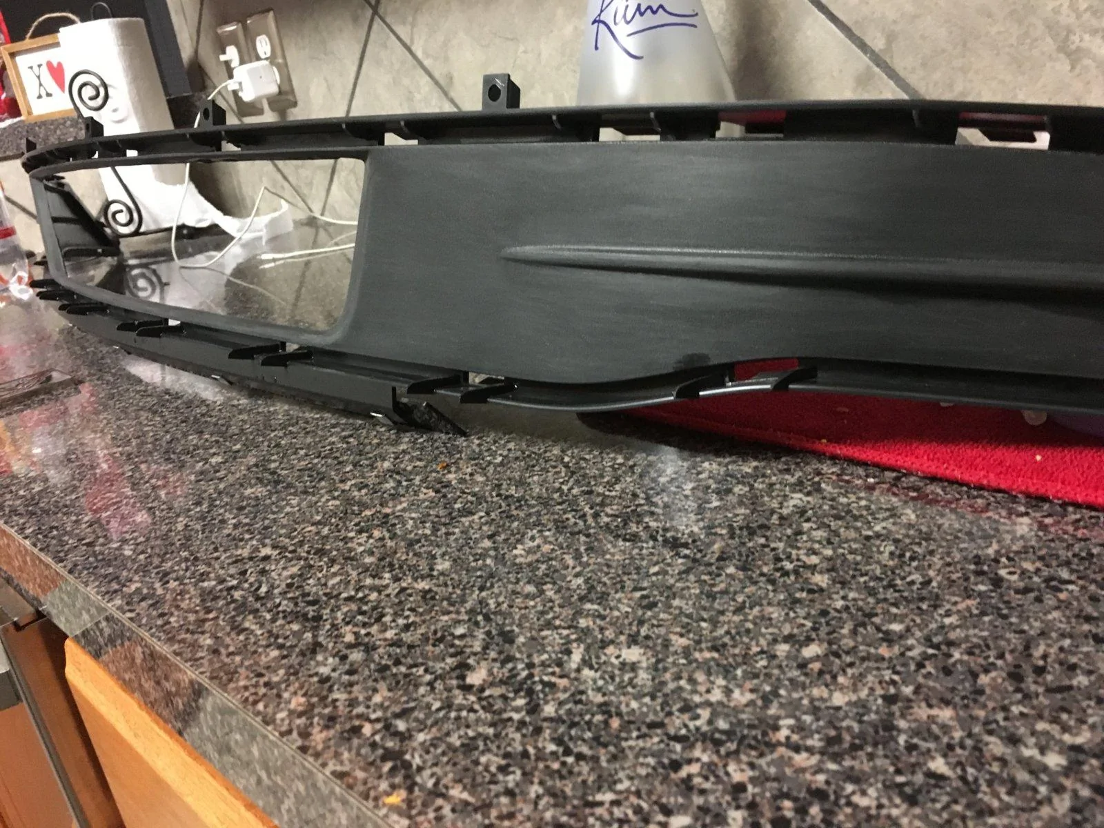

Today’s progress. Beginning to scuff up the RTR hood vents.
2 coats adhesive promoter + 2 coats primer. Base coat coming Tuesday when weather will be better. Rain all day tomorrow.

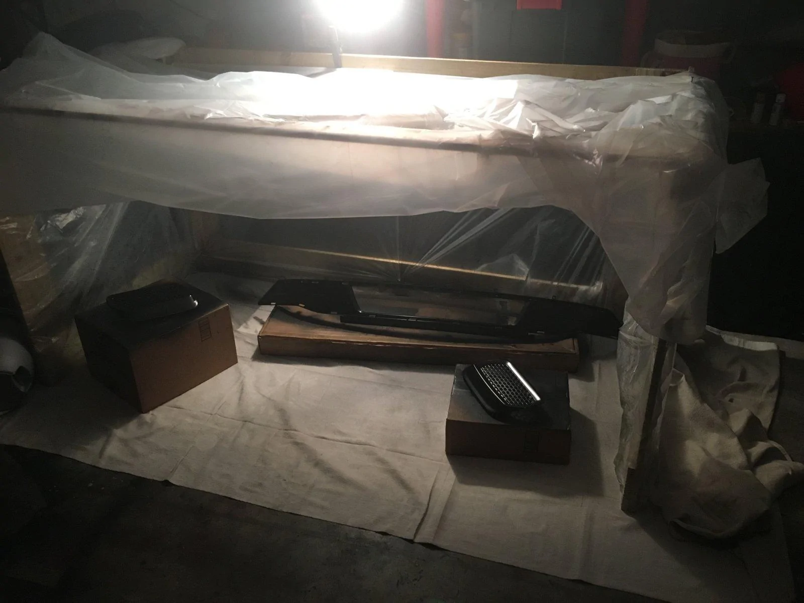

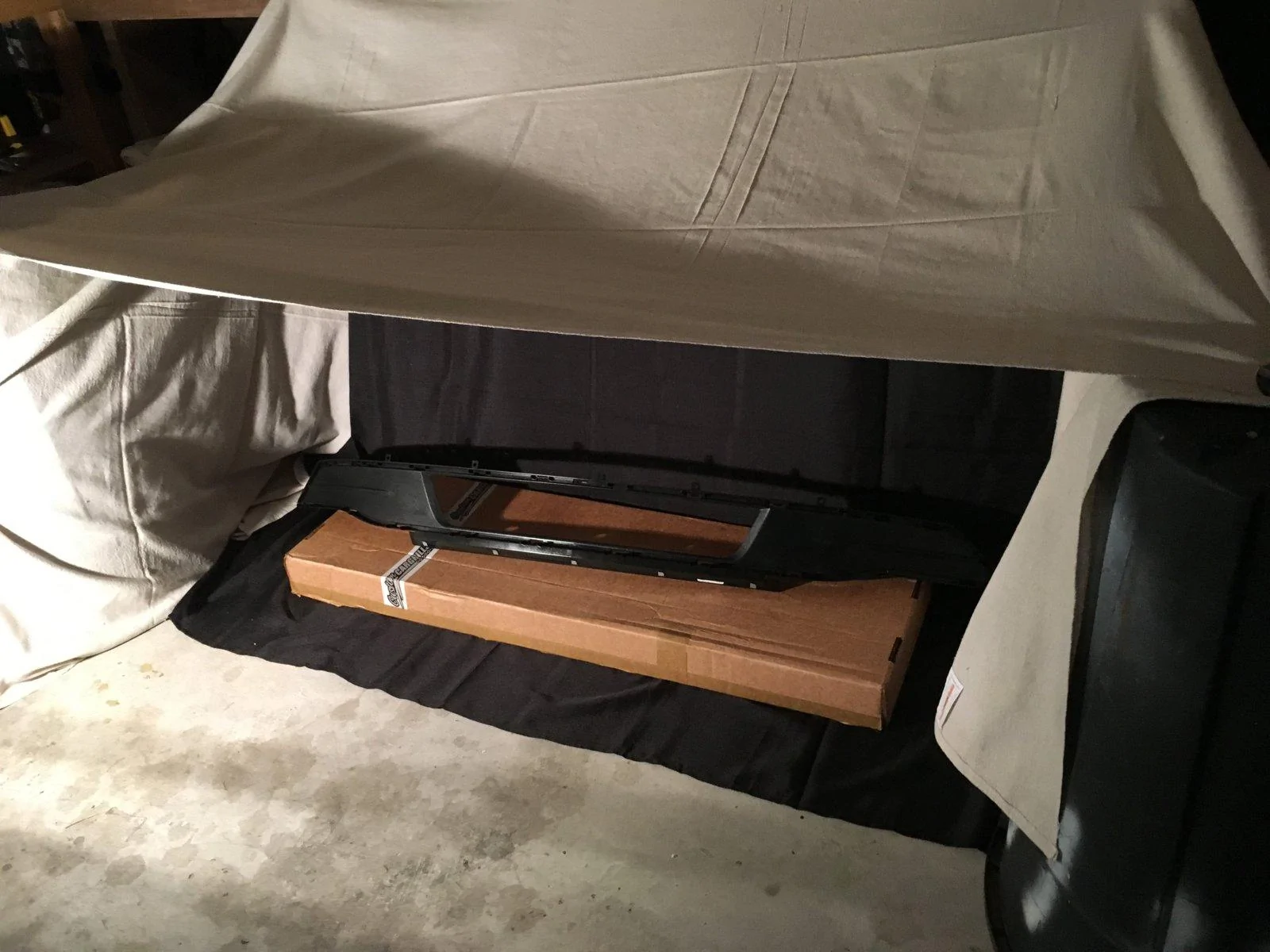

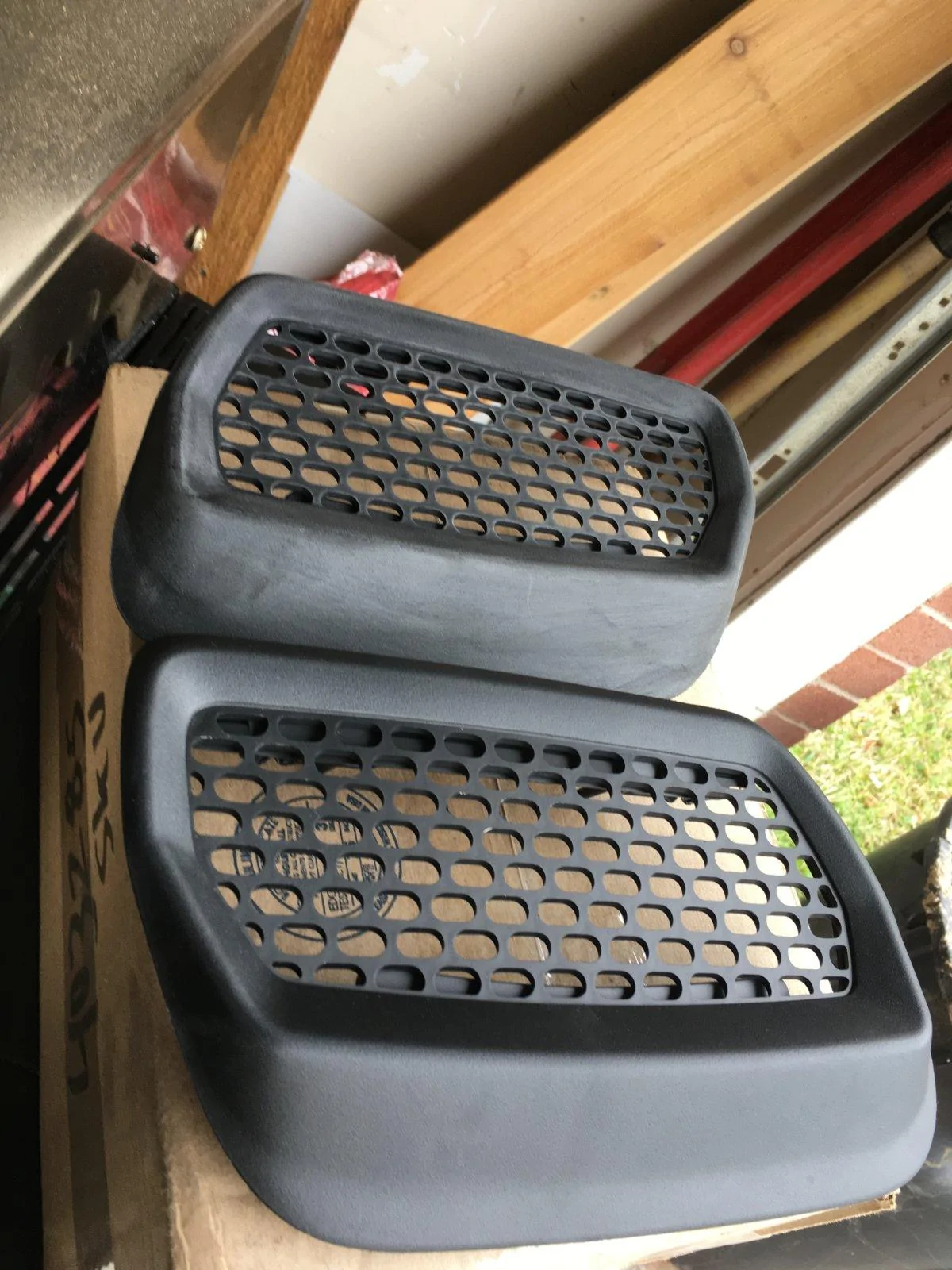

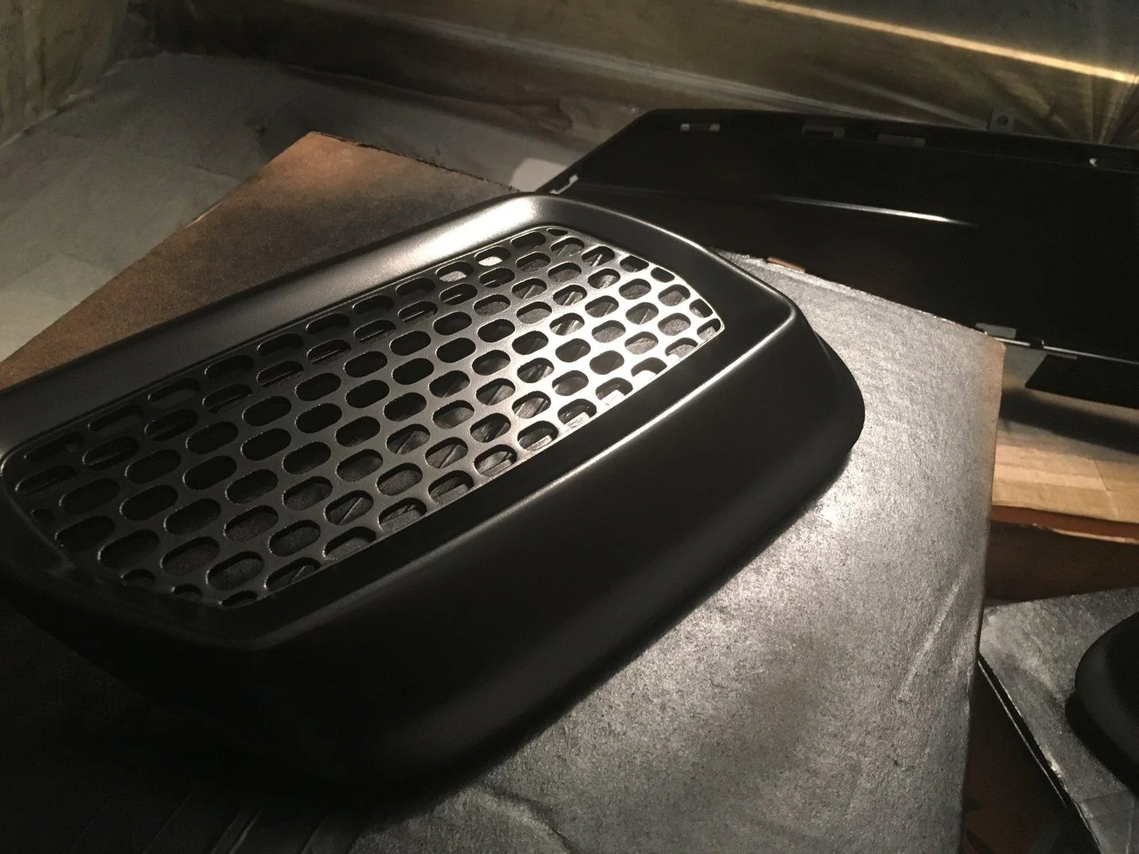

Got them all wet sanded tonight. The vents need a little more love in a few areas but overall I’m pleased. Plan is to build a small paint booth for the base and clear. Full disclosure, this was the “booth” I used to spray the adhesion promoter and primer hahaha.
90Notch
Jul 24, 2018
263
250
Houston
2018 Silver GT PP1 A10

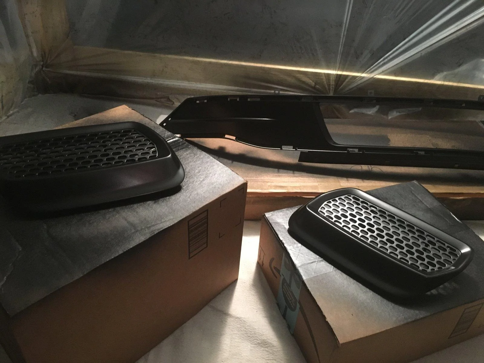

A little more wet sanding then a final coat or two of primer. Vents got 2, grill got 1 coat. Ran out of primer and didn’t want to end up with the grill all splotchy. Next up is a very gentle 500 grit wet sand and a proper spray booth. Bought the supplies today. Hoping to build it by Friday.

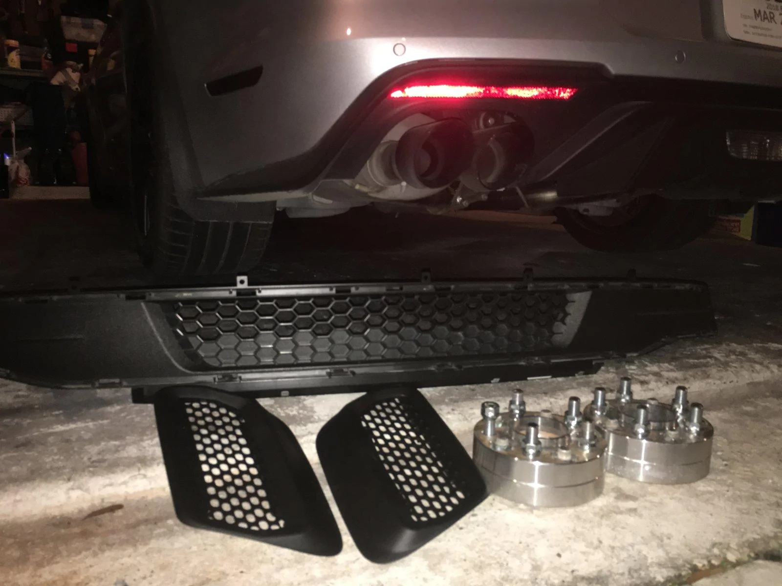

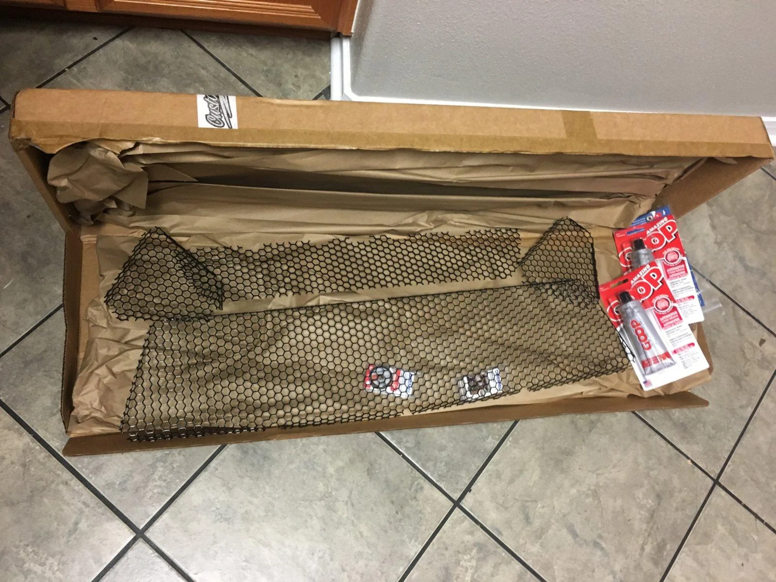

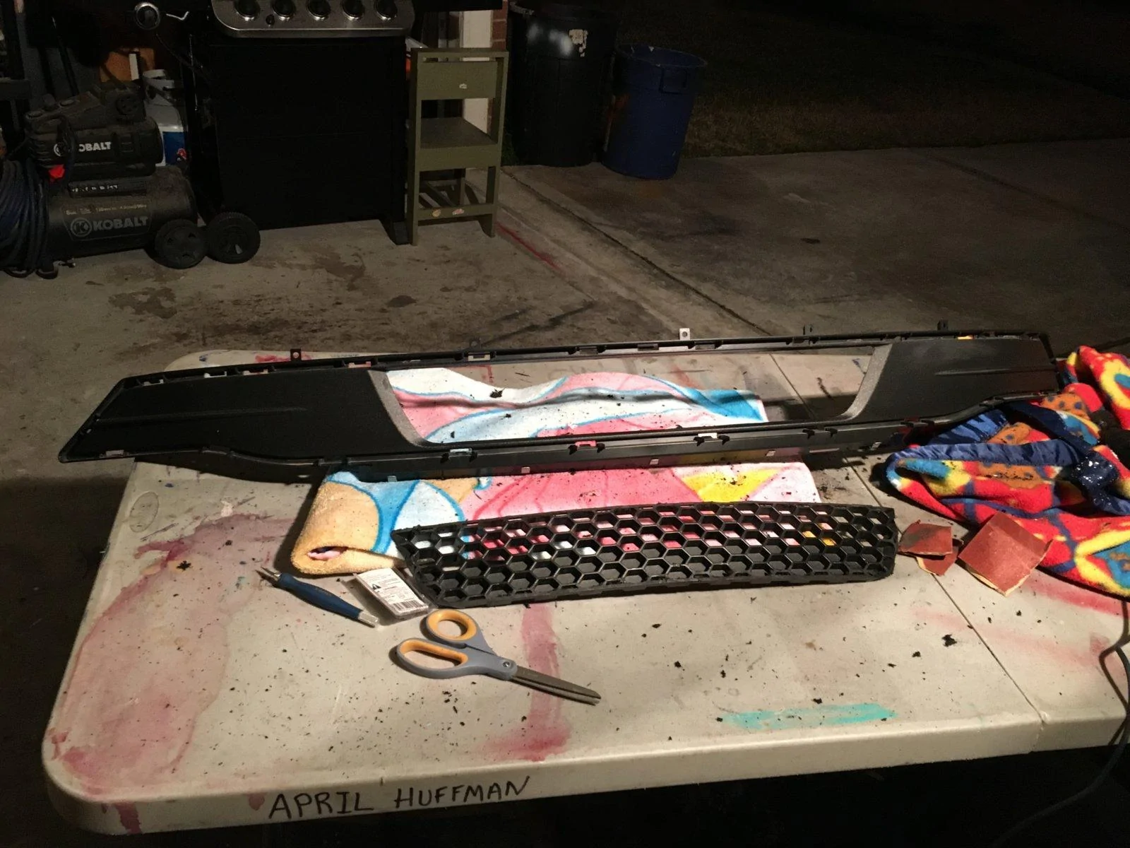

My original plan was to just pick up a spare lower and paint it glossy to match the upper grill. I started looking at mesh and ended up getting a deal on this kit from Matt at Custom Car Grills. So, now I'm going to cut the upper out and install mesh in both grills after I finish painting the lower. You can see pics of the mesh in the first post.

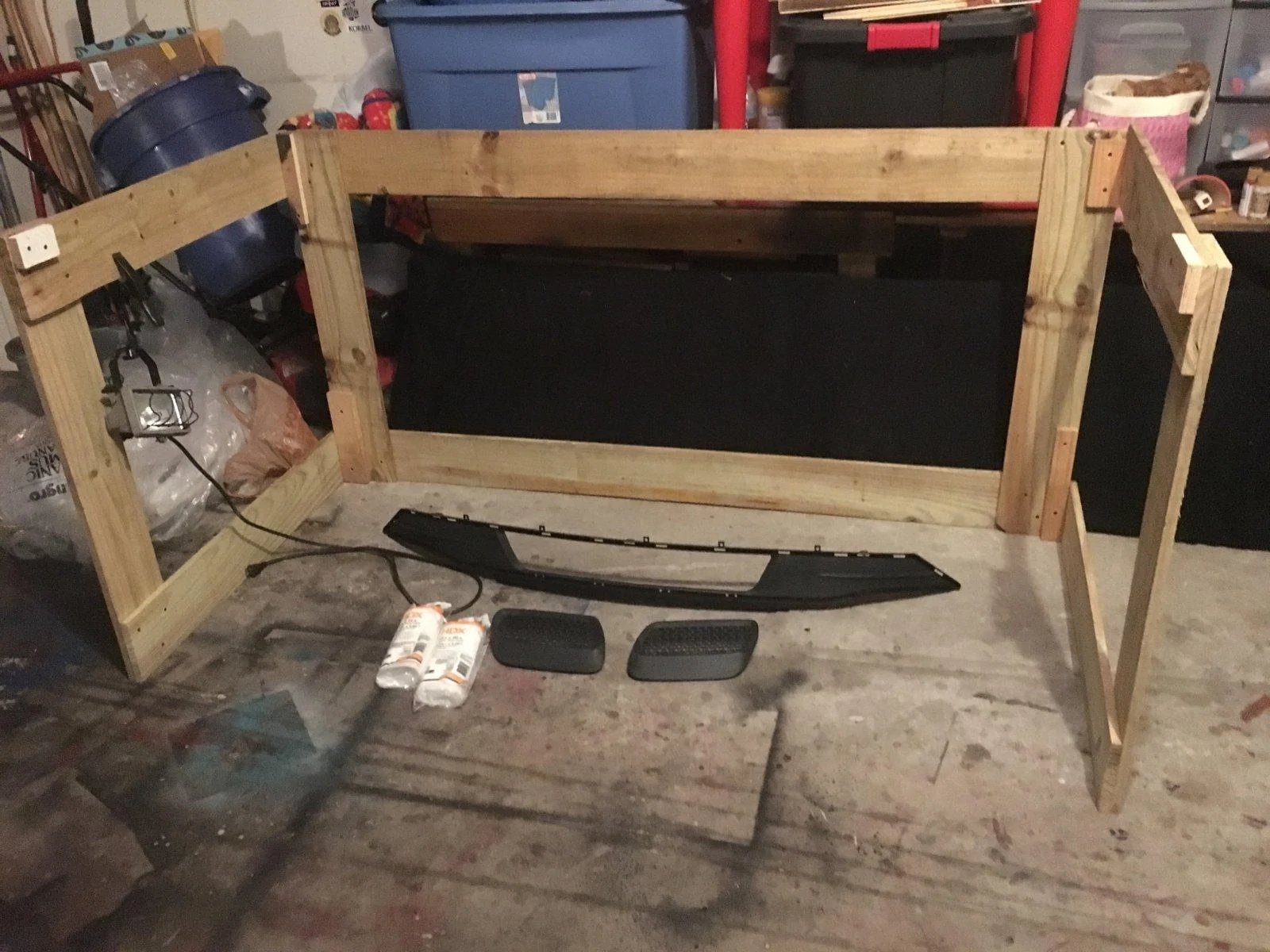

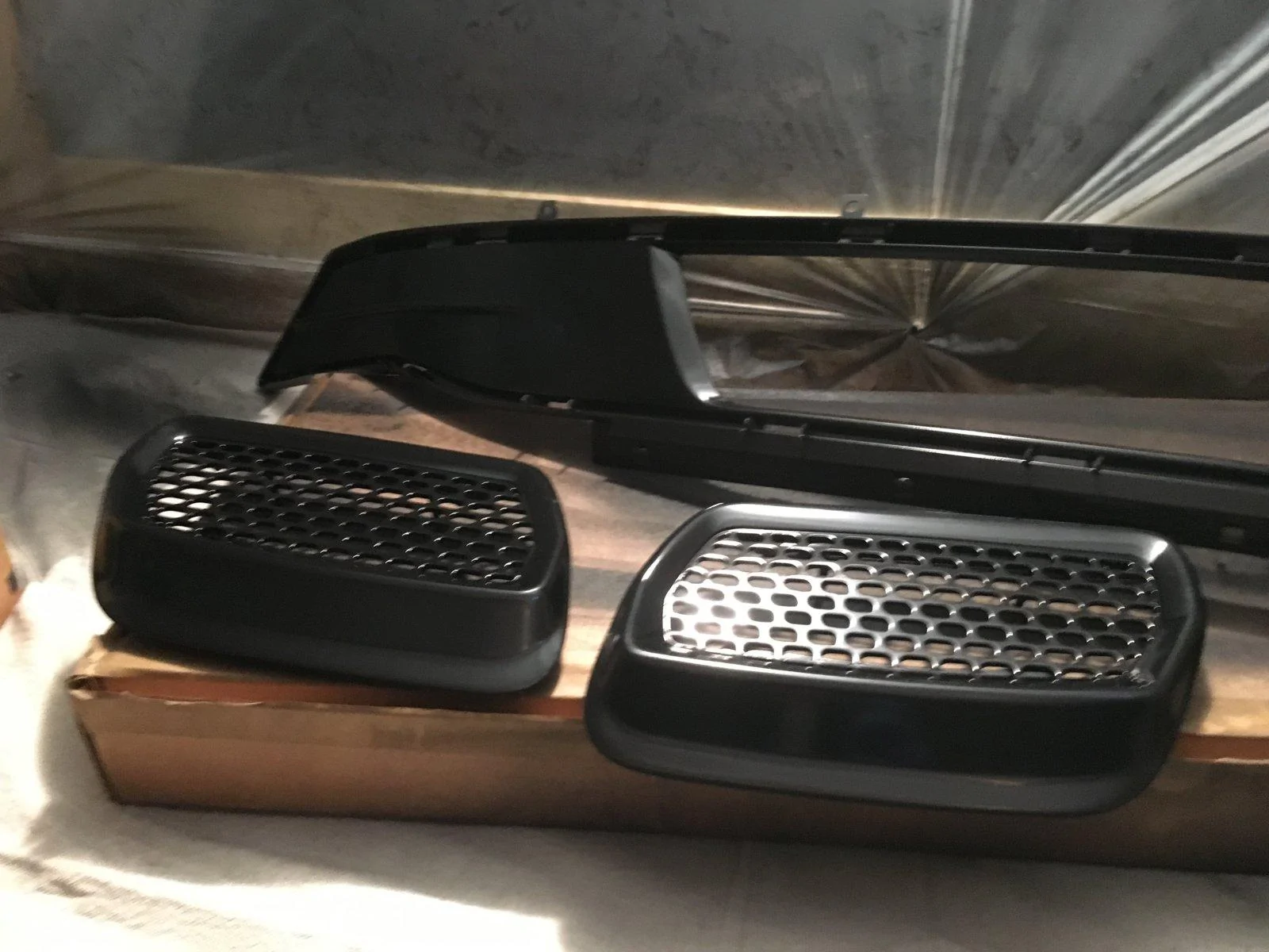

A little progress today - wet sanded with 600 grit so the parts are ready for the black basecoat. I also made the frame for the paint booth. I’m one plank short of finishing. I need the front cross bar. Then I can line it with the plastic sheeting and I’ll be ready to spray.

Very pleased with how the base coat turned out. I had one spot where a tiny hair or something got in it. I tweezed it out and sanded with 1200 grit. The spot is not noticeable unless you’re right on it. Clear is coming tomorrow hopefully, Sunday at latest.

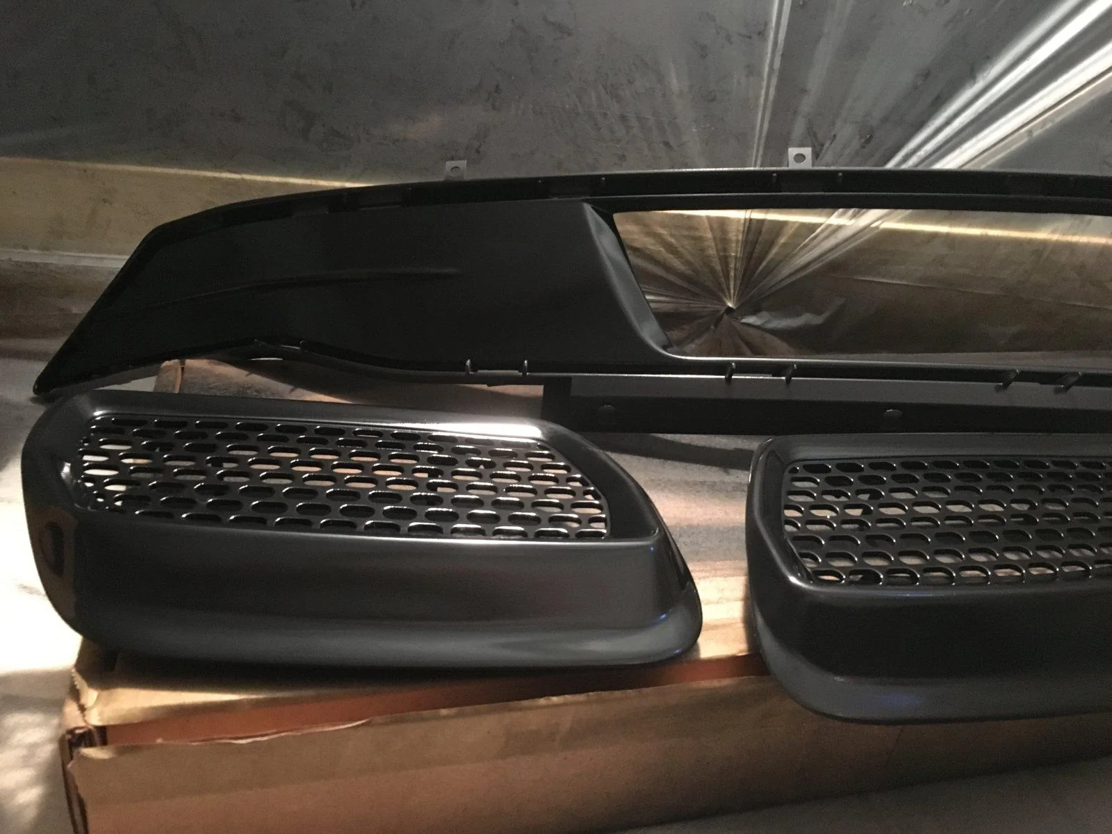

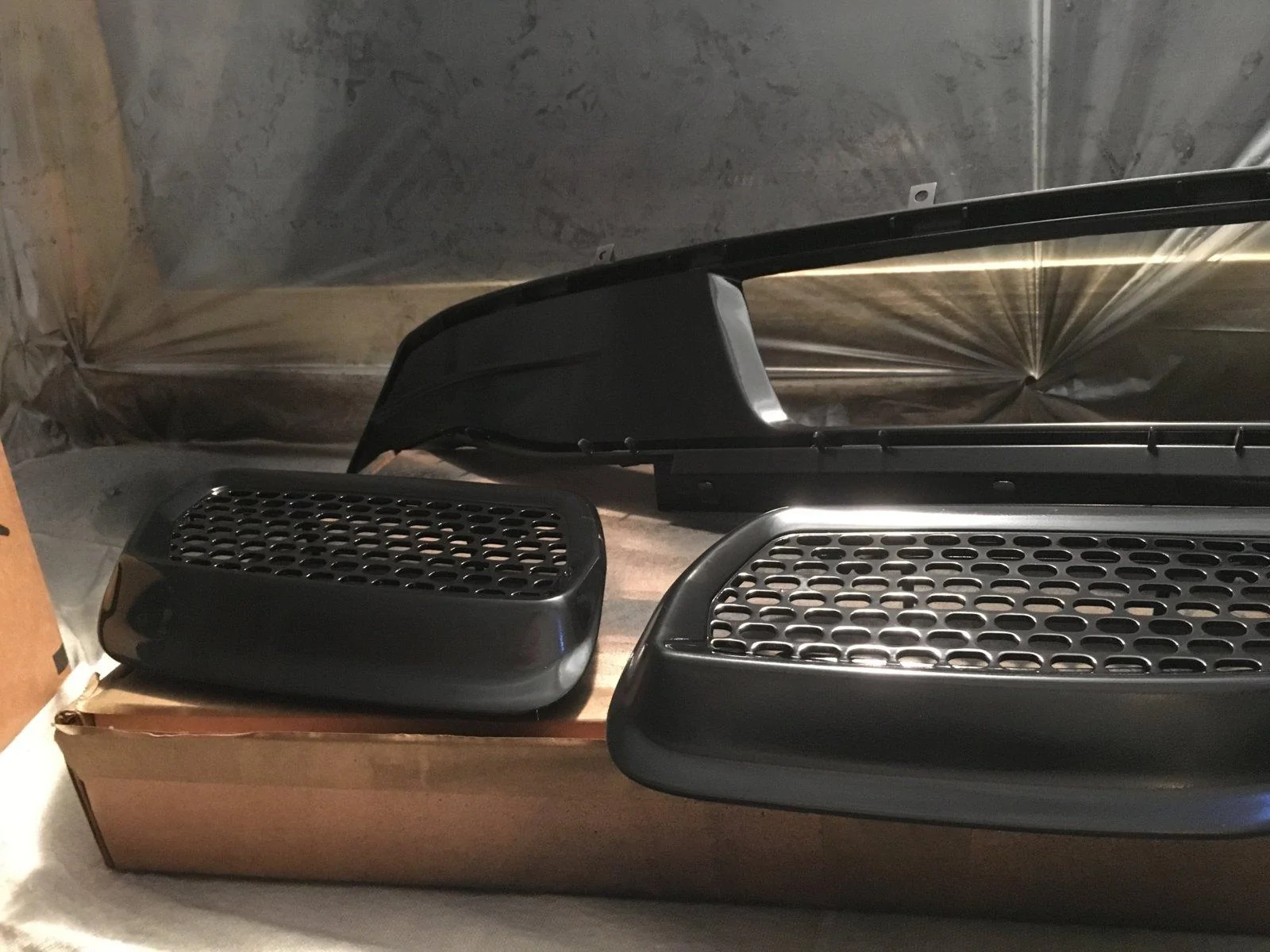

Success! Did 3 coats of clear. Then I realized the can said 4-5 but they look so good I think 3 heavy coats are fine. Couldn’t chance getting any dust in the last coat. Doesn’t look like they’ll need much in terms of polishing. Very pleased with the Automotive Touchup products and my makeshift paint booth.
