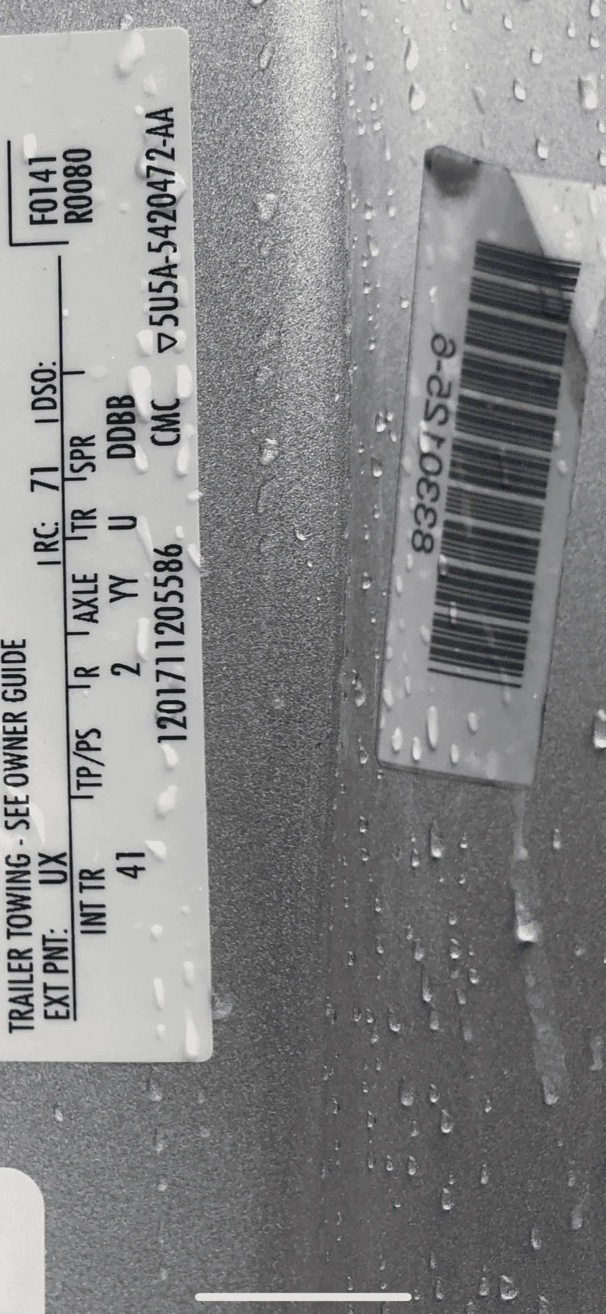

Mario_5ohh
Mario_5ohh
Apr 13, 2020
Mario
2018 GT
Mario_5ohh
Mario_5ohh
Apr 13, 2020
Mario
2018 GT
It depends on a couple of factors. Is the GT Premium equipped with either of the available PP's? Is the GT a manual or automatic?
1. A10 Non PP: 3.15 gear ratio is the standard factory...i.e. no cost option (YY factory code); 3.55 is optional (DD factory code non Torsen differential). $795 cost for 2020 A10 GT's
2. A10 PP1: 3.55 gear ratio (Torsen differential) No additional cost, as the 3.55 gear ratio is part of the PP1 package.
3. 6 Speed Non PP: 3.55 gear ratio (Non Torsen differential)
4. 6 Speed PP1/PP2: 3.73 gear ratio (Torsen differential). I think BB is the axle code for 3.73...but, I am not 100% sure.
Linkster1666
Jun 28, 2019
716
607
AZ
Link
2019 Mustang GT Premium Orange Fury PP1 A10 401A 3:55
So, your YY code says you have a 3:15 rear gear.
