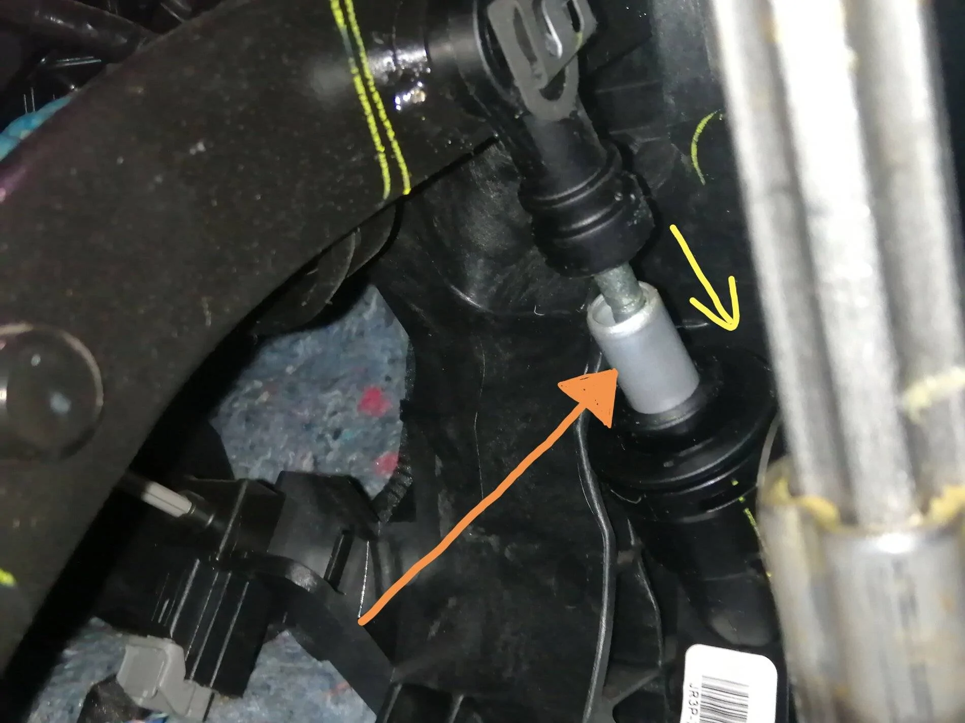

I have noticed when i push in the clutch its very smooth over the first 80% of the travel, then it hits a little point of resitance, the final 20% feels rougher, like its rubbing on something. You can hear it if you press the clutch with the engine off, its not loud by any stretch, but its not silent like the initial travel.
Further investigation suggests its the metal cylinder (highlighted orange) which when pushed inside the black plastic housing (highlighted yellow) rubs a bit against the inside.
Was wondering if this was normal? Doesnt seem to be any issues when driving it, goes into gear ok etc.

I feel that in my 2019 Bullitt, although I haven’t inspected the cylinder thatā€˜s shown in your pic.

Thanks, sounds like its just the way it is, weird that i suddenly noticed it....
