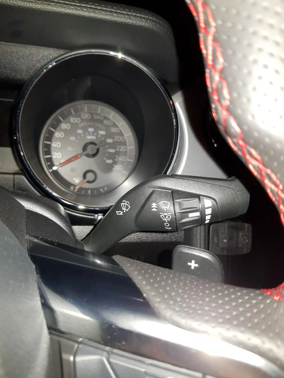

Oh so you have adaptive cruise and auto wipers? Then you are supposedly to get the -AA part. Though It doesn’t really matter which one you get for wipers. I’m pretty sure the SCCM is the same it’s just the wiper stalk writing that’s different.
[MENTION=29356]breeves002[/MENTION] I don't have Adaptive Cruise, just auto wipers. The photo below shows how my wipers switch looks like. Can you please confirm that I need to order the JR3Z-3F791-AA (Auto Wipers) part? Thanks again :thumbsup:

Oh interesting. In the US you can’t get auto wipers without adaptive cruise. You need the AA part yes.
