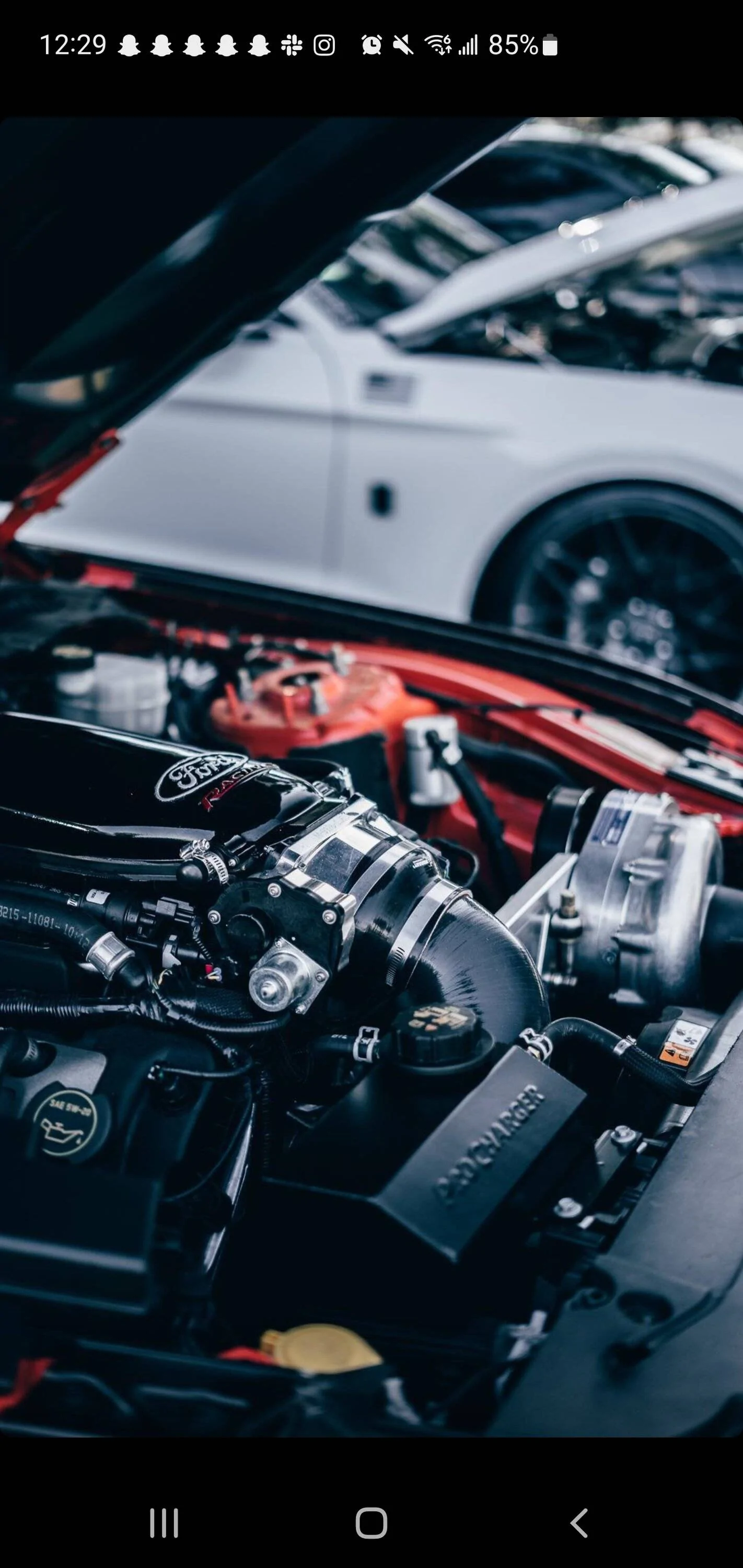

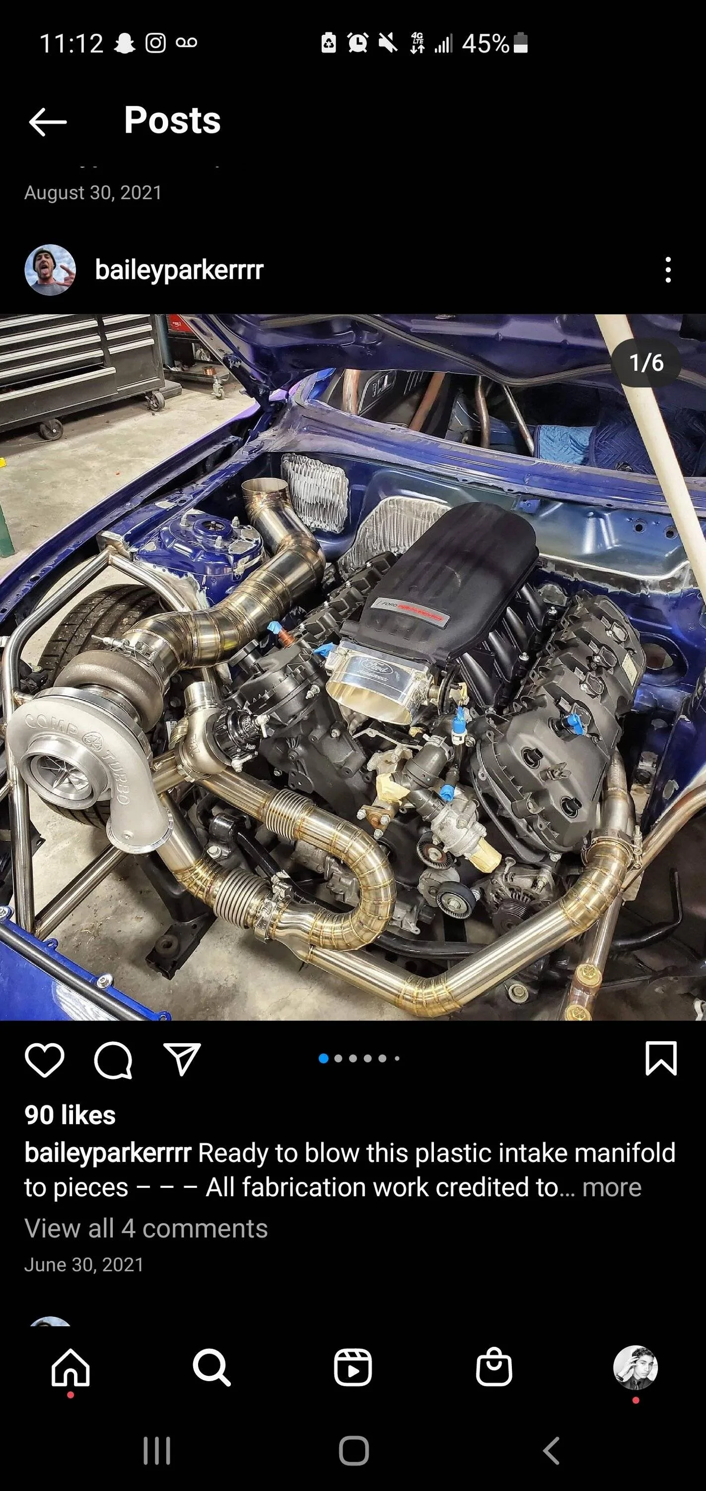

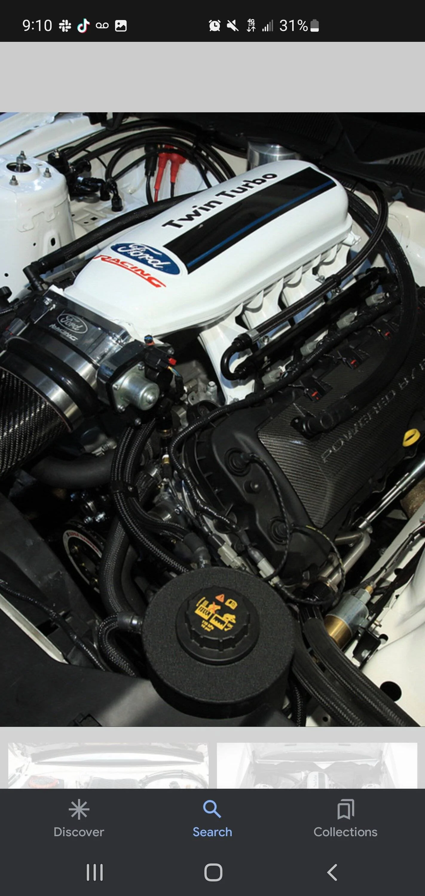

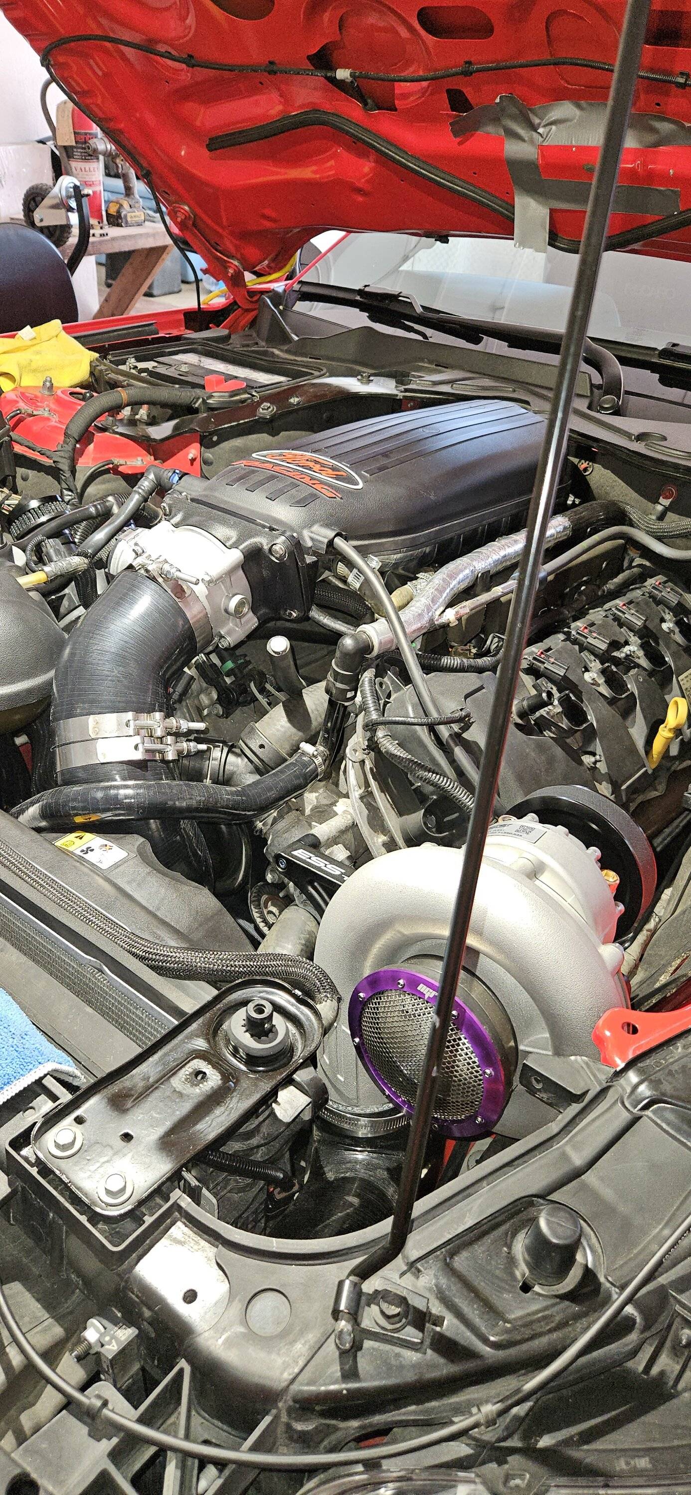

Lemme share a secre, you do know you could use the oval theottle body right? Who said you need a single one, as long as you use the Dual 65mm throttle body from ford racing your gucci, dont use the monoblad those are ass, I used the duel throttle body 65mm for a hot min before switching over it works great , lund tuned it. Theres many turbo cars with the CJ oval that run great

Hope those photos gave you some encouragement that its possible 🫶
