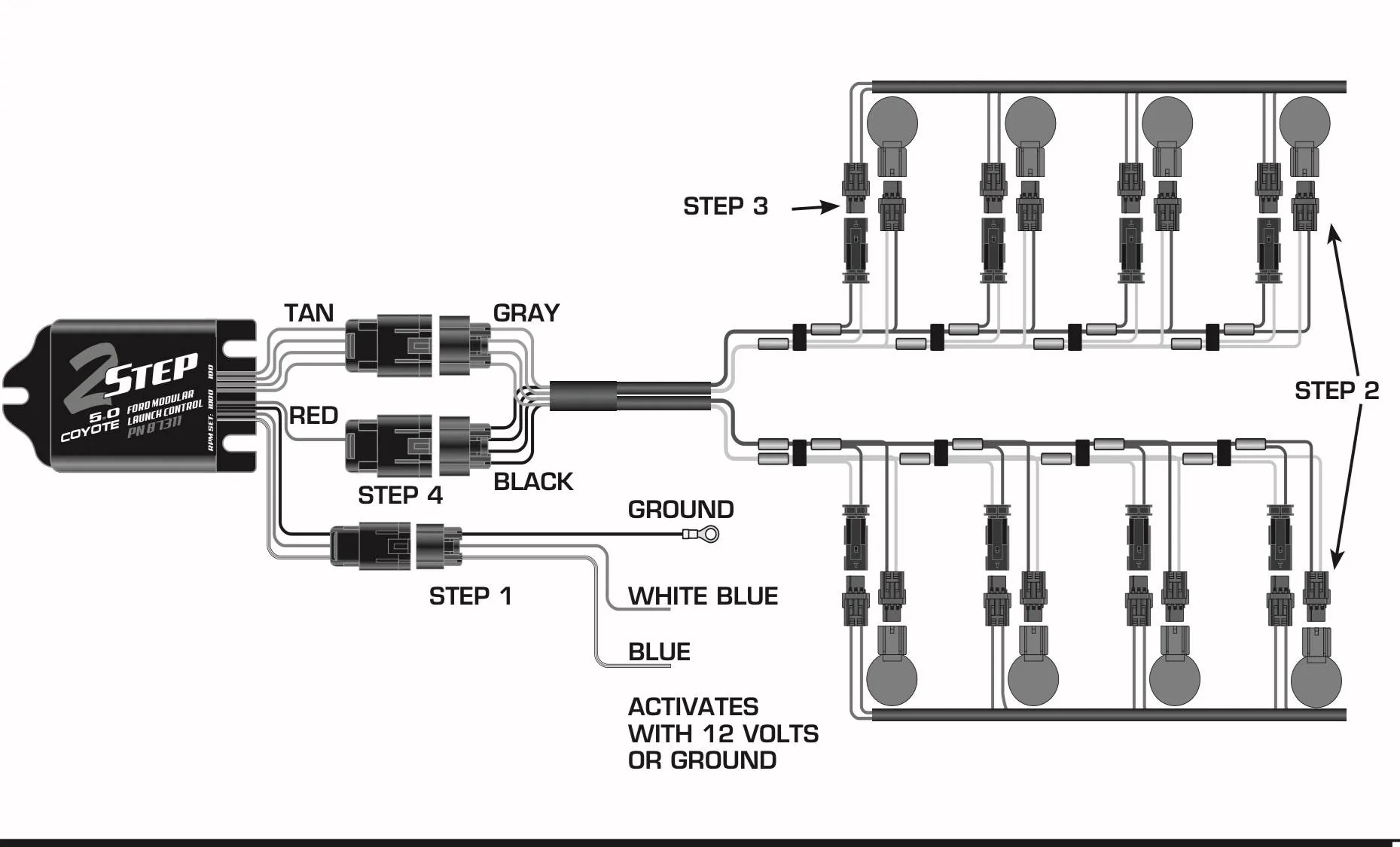

Recently I got the MSD 2 Step Rev limiter for my 2017 Mustang GT. I hooked everything up how the diagram showed and the engine runs normally. At first I had the wiring harness backwards which made the engine feel sputtery and it threw a CEL. So I flipped the harness and engine feels smooth now (hallelujah!)
The main problem I am having is with the switch wire to activate the MSD module. Now I did everything it says by seeing if the LED on the device is on while the ignition is on (not with the engine running) then it shows that it is wired up correctly in the engine bay. My problem is, is that I have a manual transmission and I’m trying to tap the activation wire to the clutch switch. I don’t know which wire it is because both on the clutch switch itself don’t seem to work. The black/white (I think that’s what the color is, it’s too small for my eyes lol) when the engine is running doesn’t seem to turn the LED on when I’m fully on the clutch like it’s supposed to. The other wire, the blue wire, always seems to keep the light on which is causing the 2 step to always be on which throws the CEL.
Any help from someone knowledgeable or with a 2017 that had this same problem? Would love to get this figured out and back on the road. I will put a picture of the diagram from the instructions with this post for reference.
EDIT: So I figured it out. I attached the blue wire from the MSD into the blue wire from the clutch switch (since it’s the ground wire in my car) and everything is working perfectly now except I still have the CEL on. Will that go away on it’s own?
I am trying to install the 2 step on my 2017 gt
did u have to flip the coil connections Or did u put them in the orientation that they supposedly go on?
there’s a video of a guy on YouTube flipping the connections which is confusing me at this point. Thanks!
