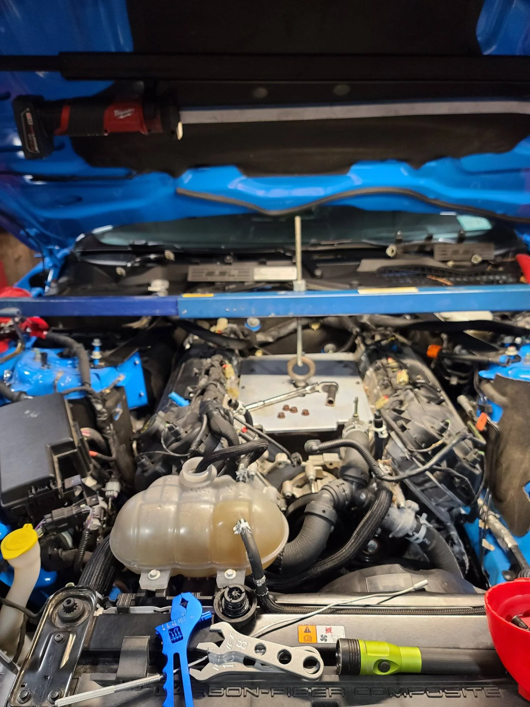

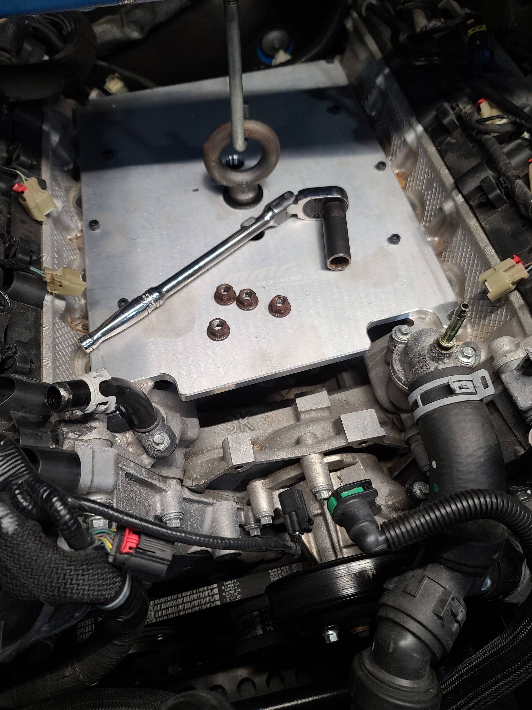

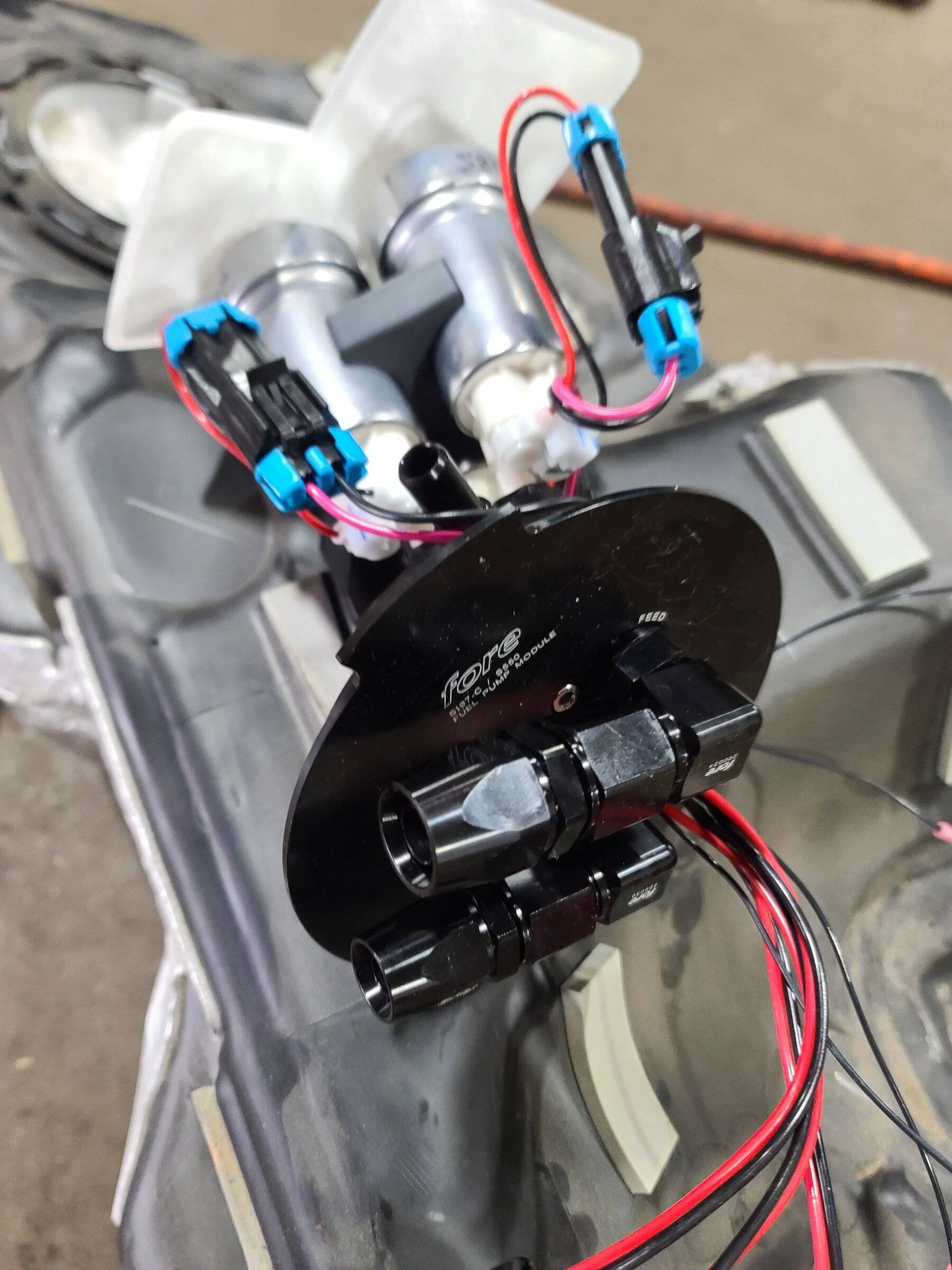

started my teardown today worked on it for 6 hrs today feel like I'm making good progress will answer as many questions as I can

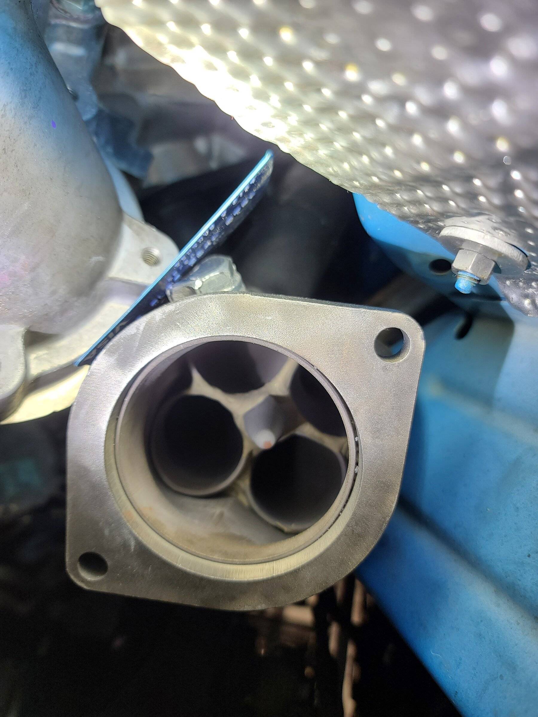

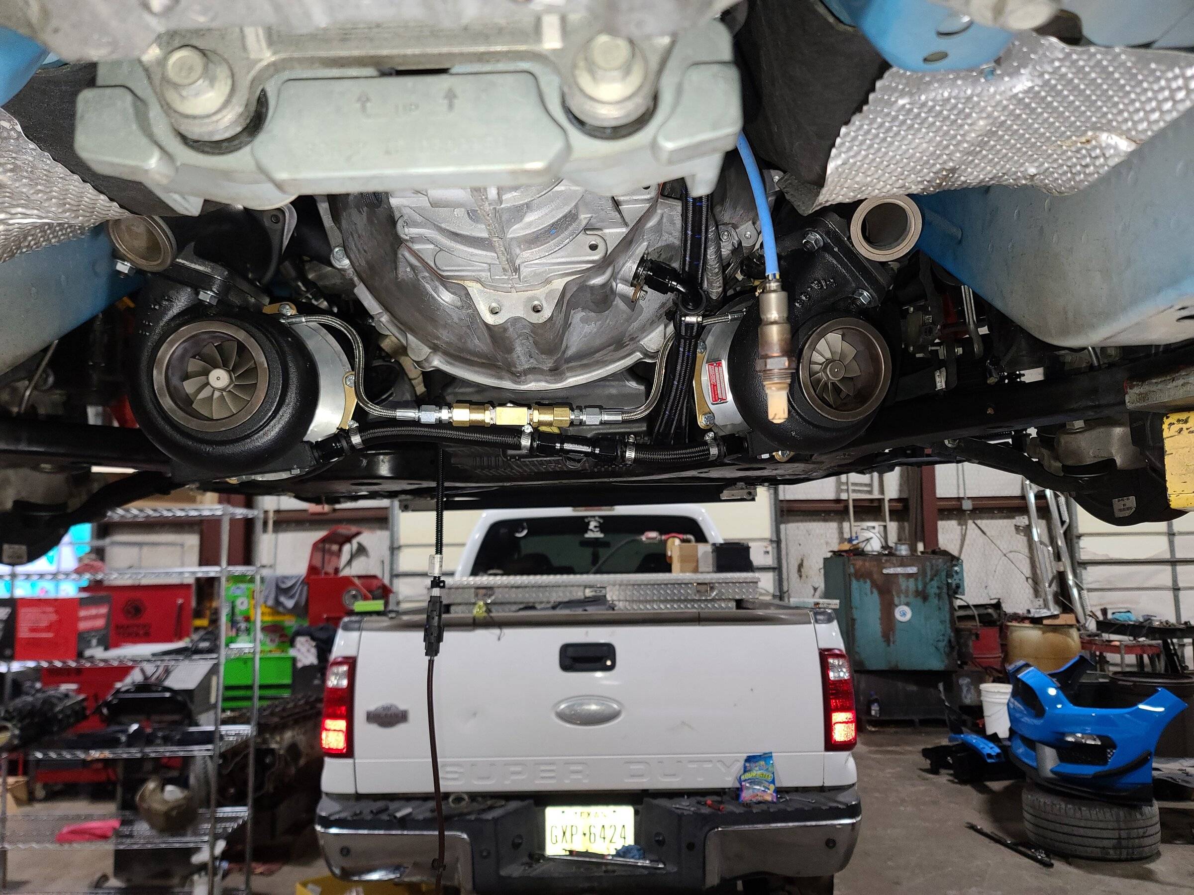

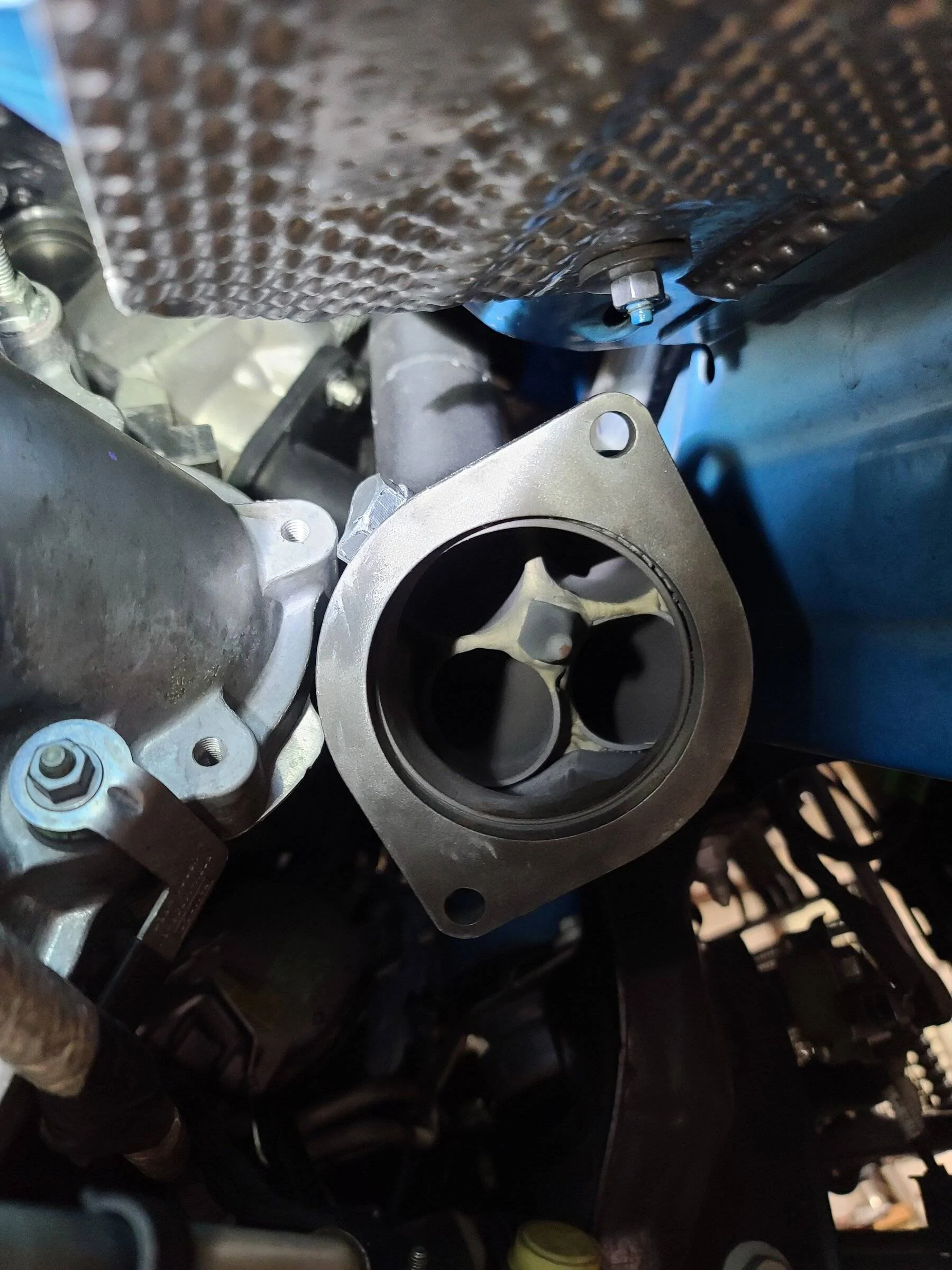

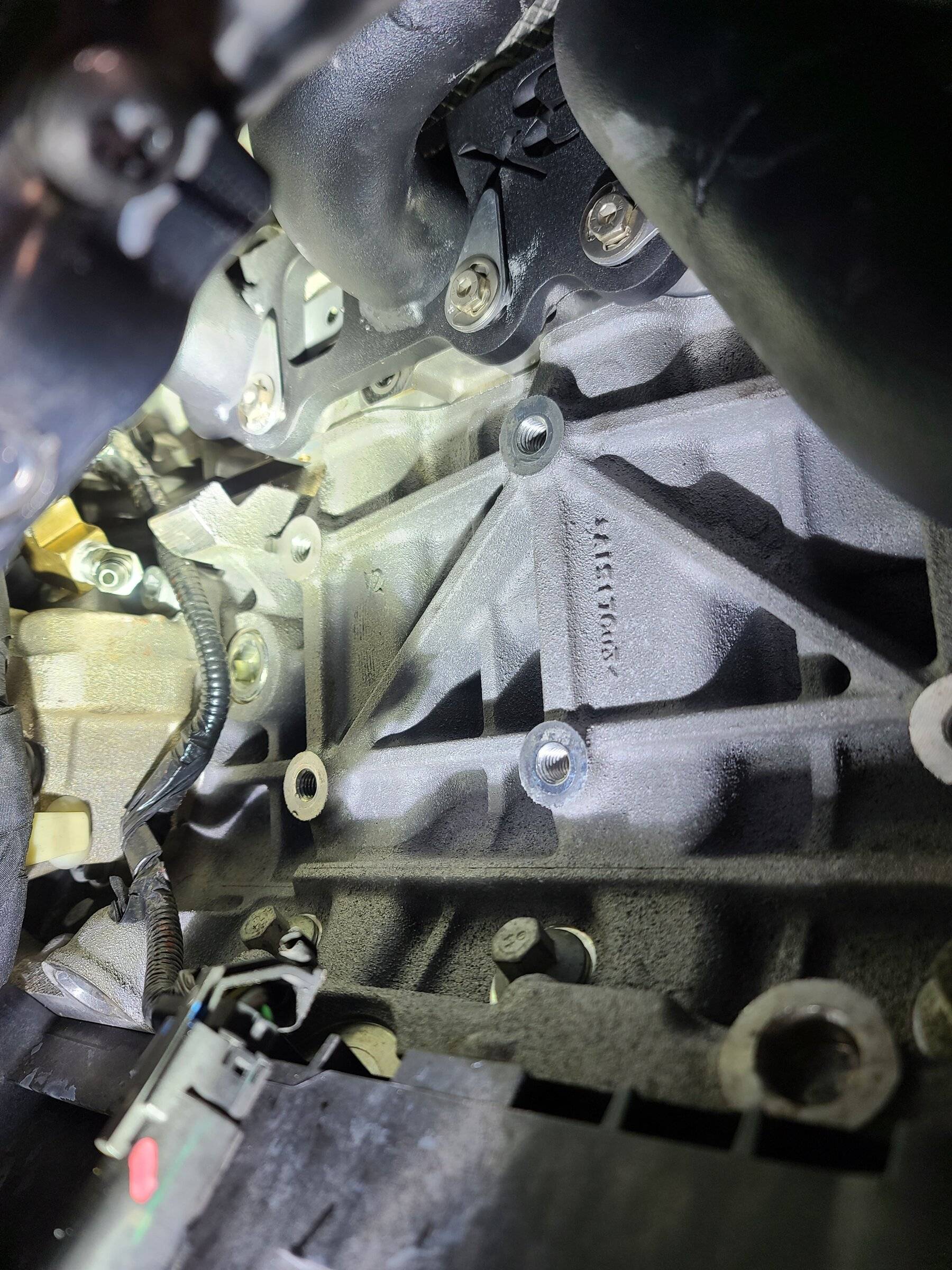

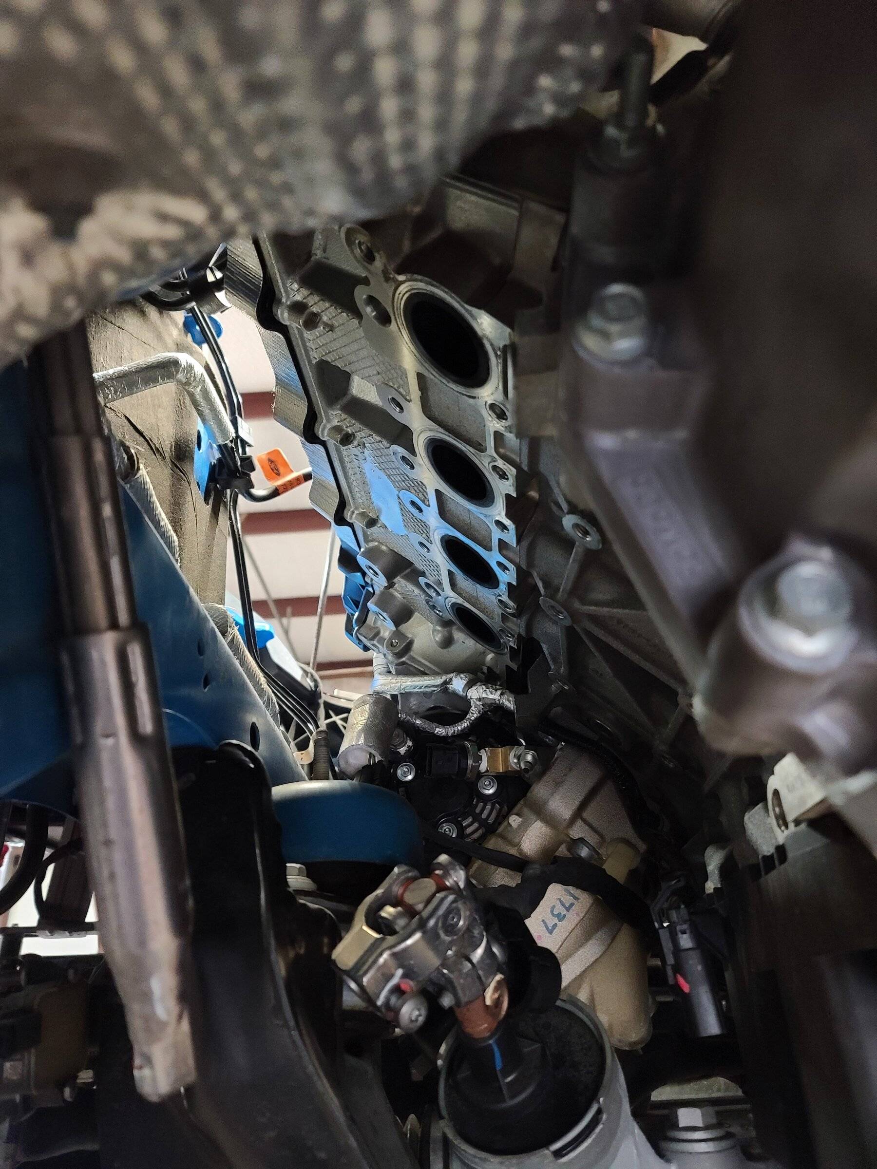

2017 GT350

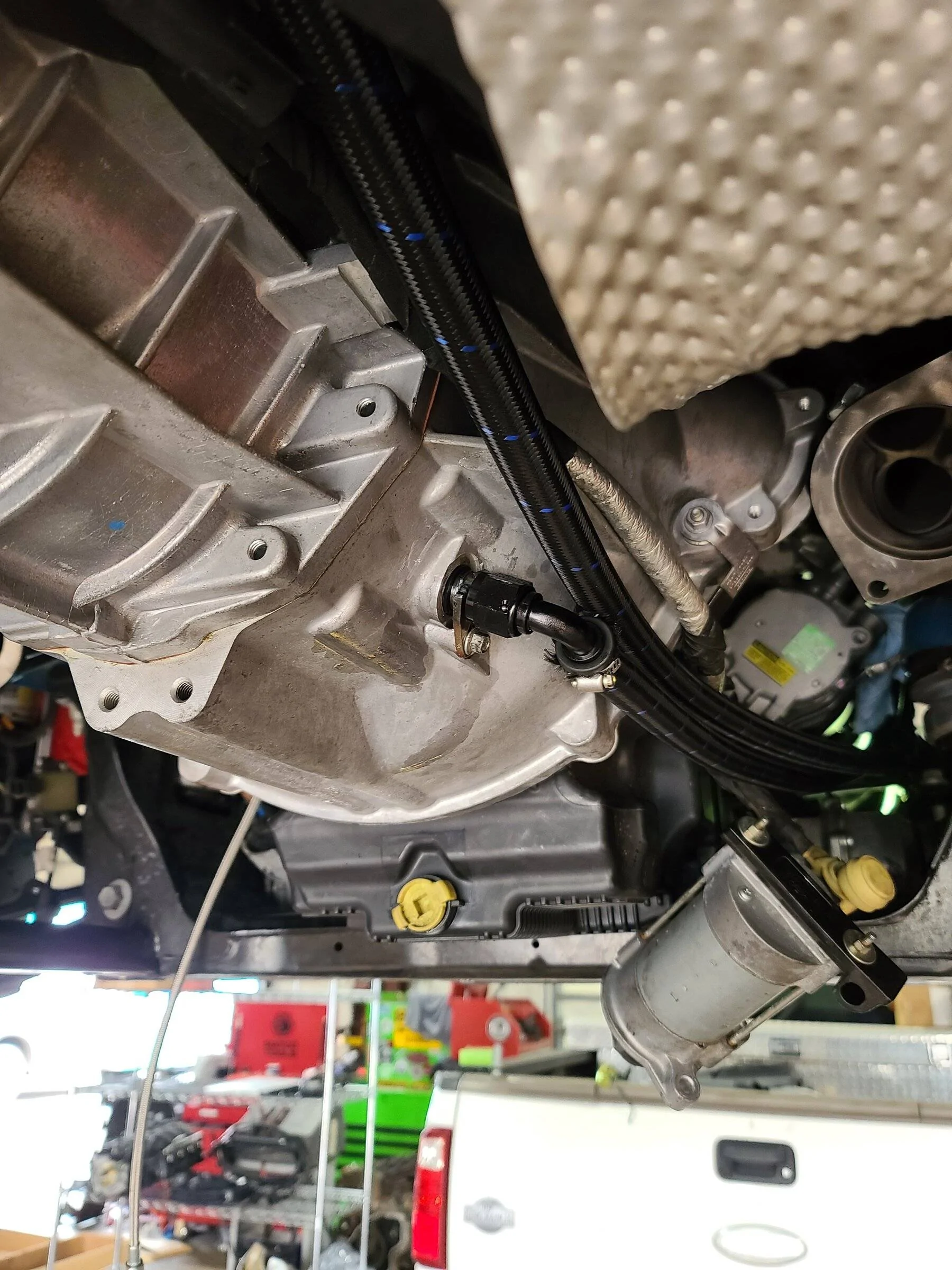

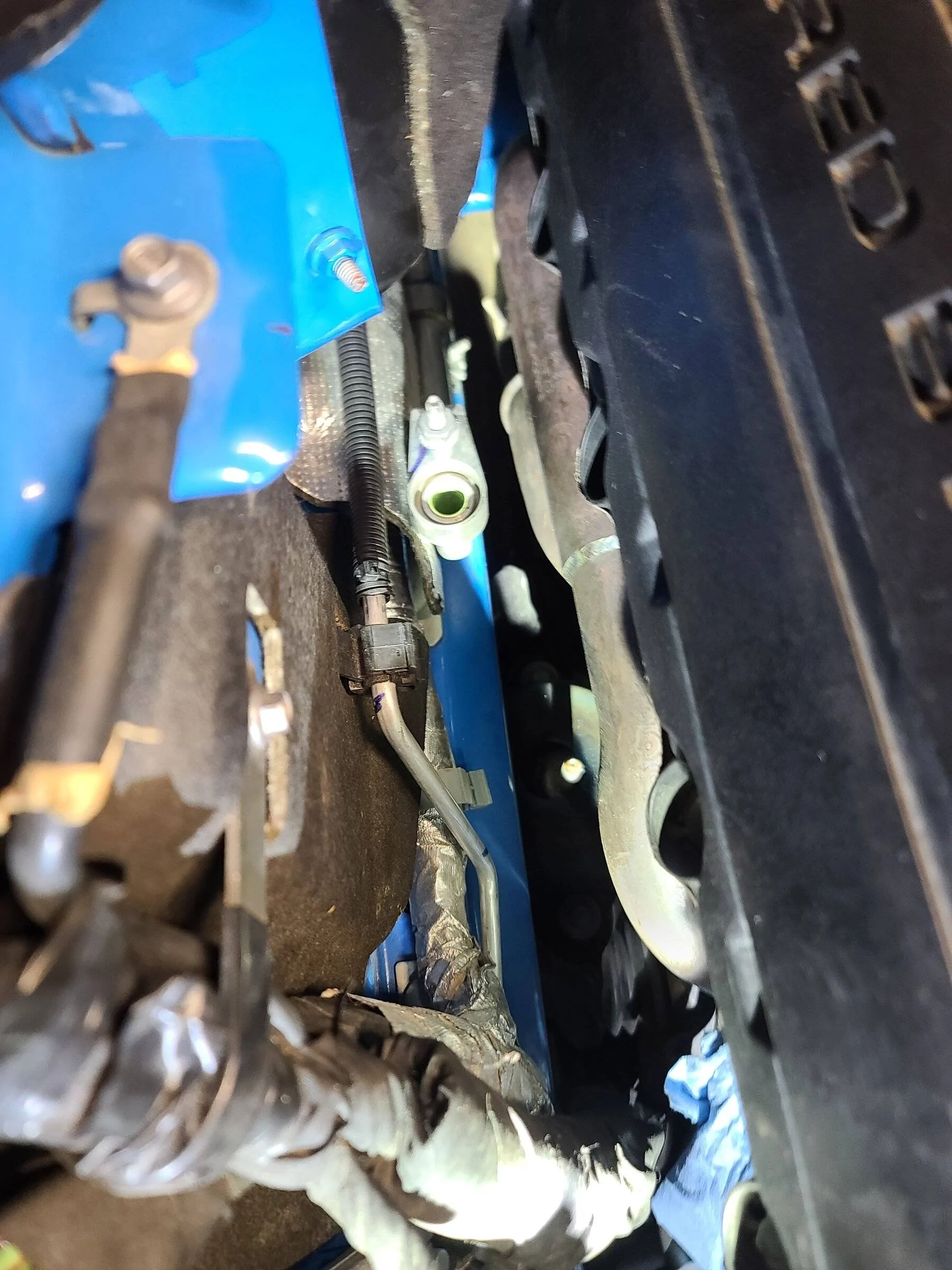

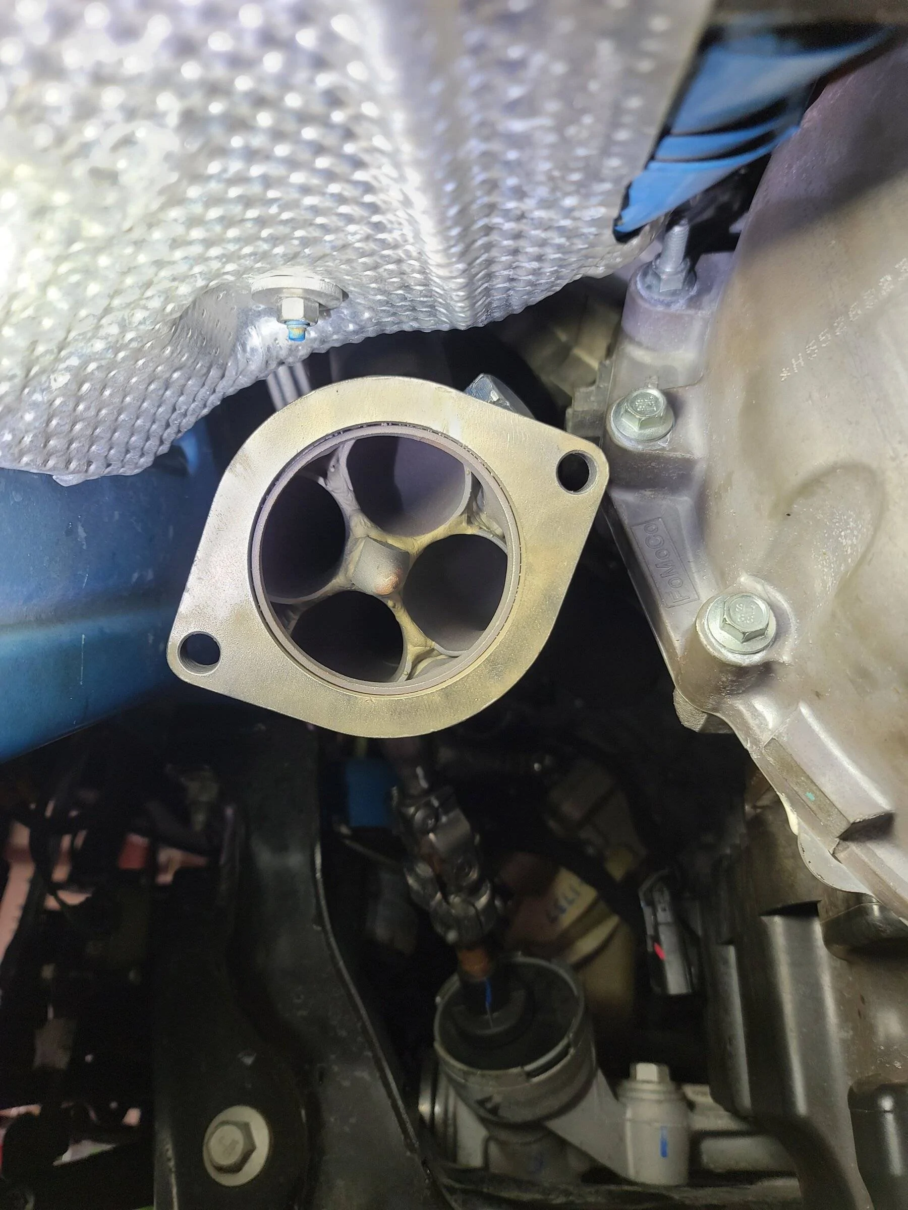

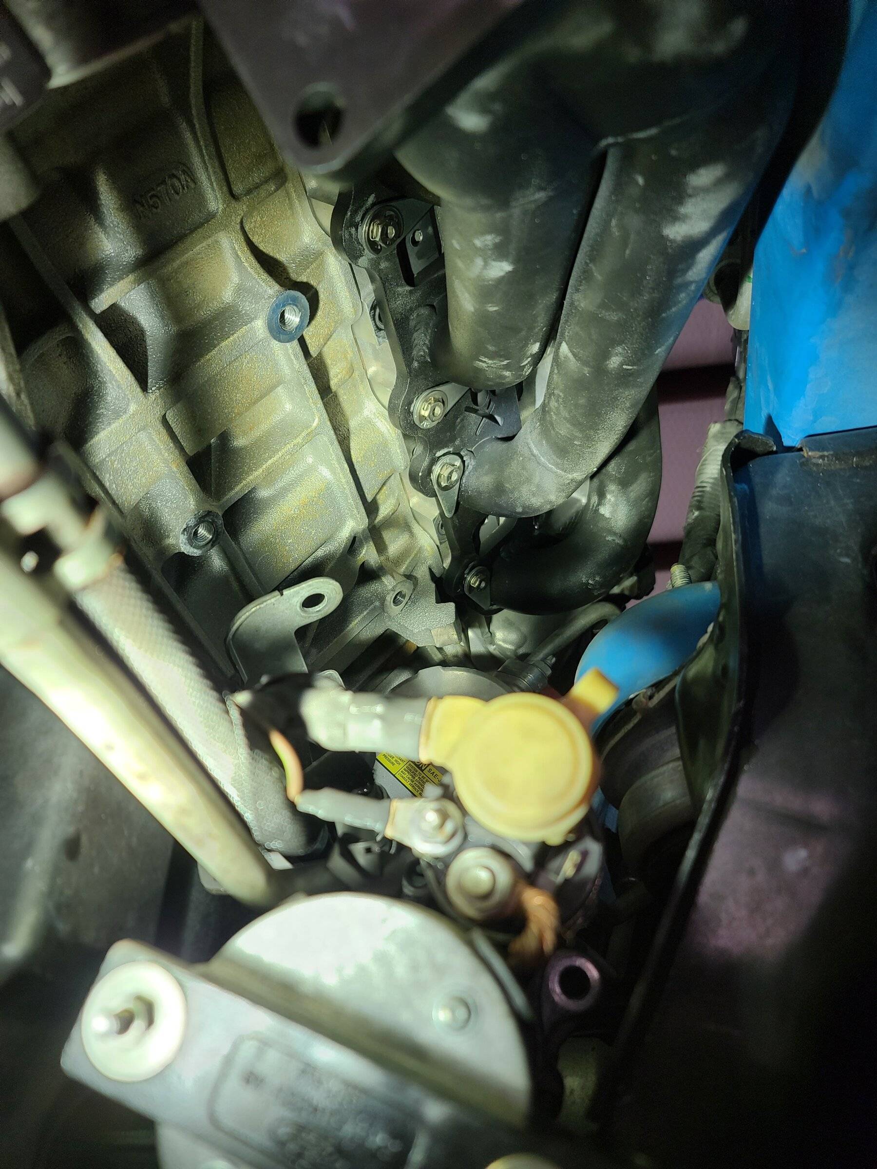

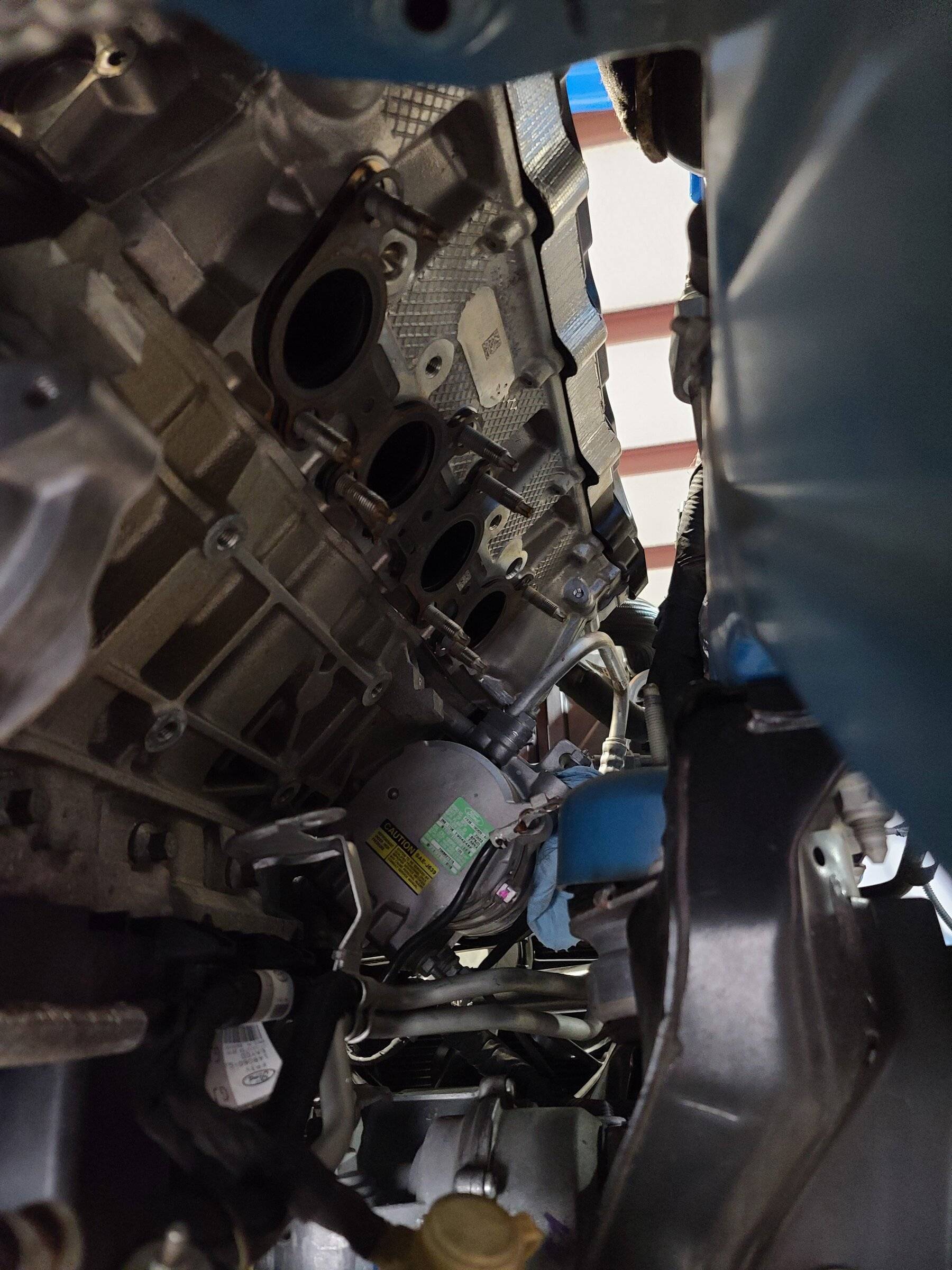

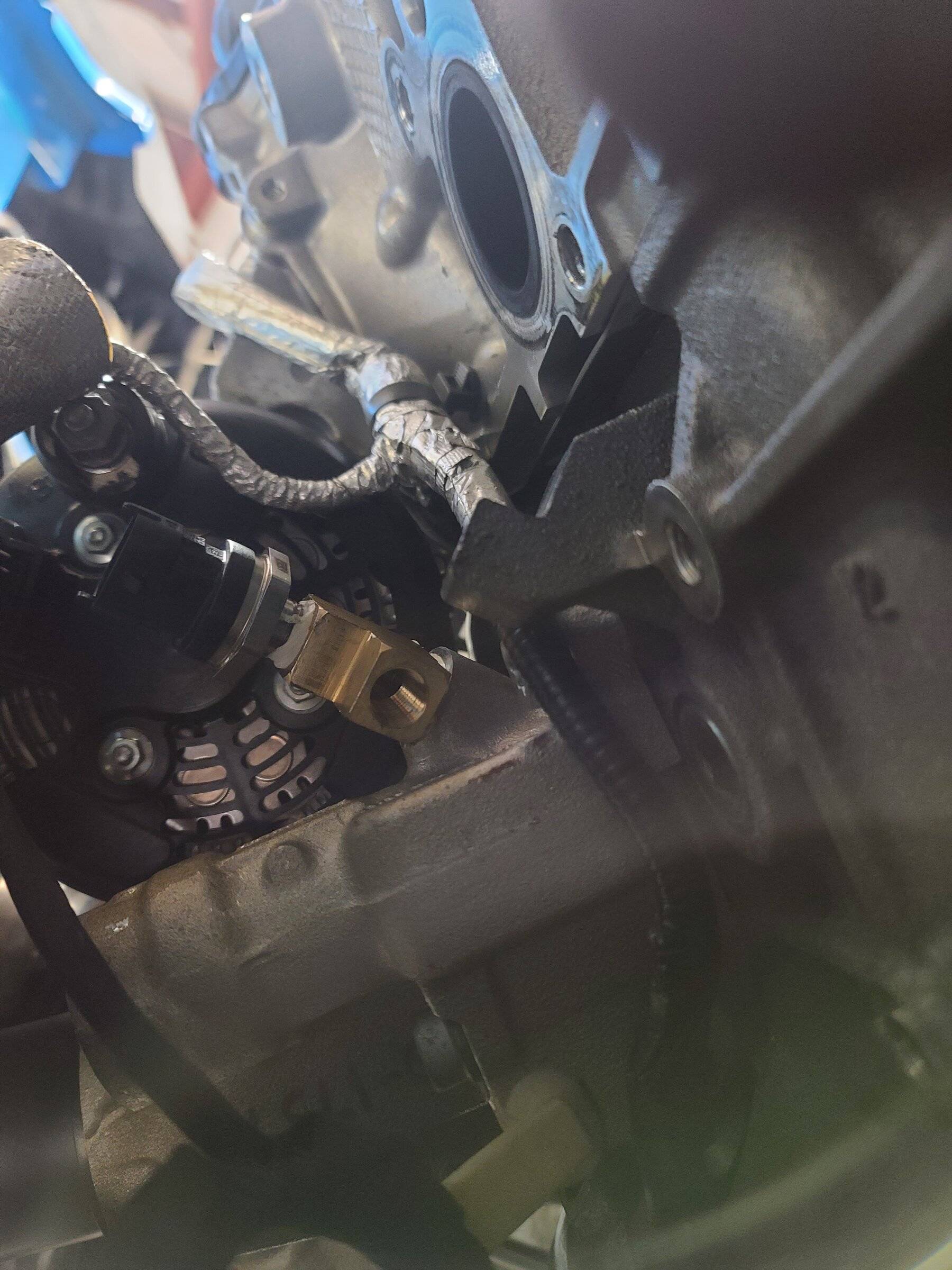

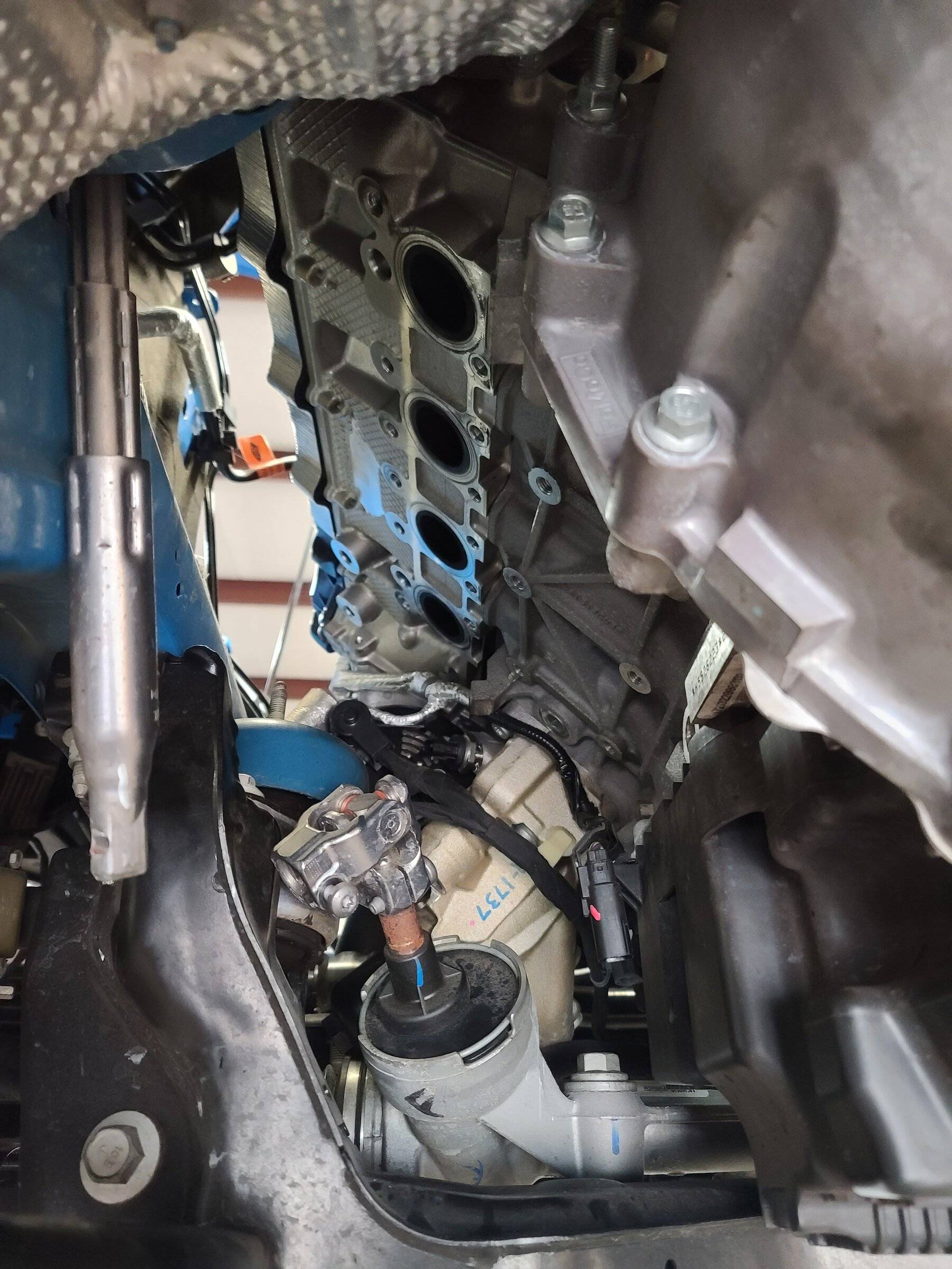

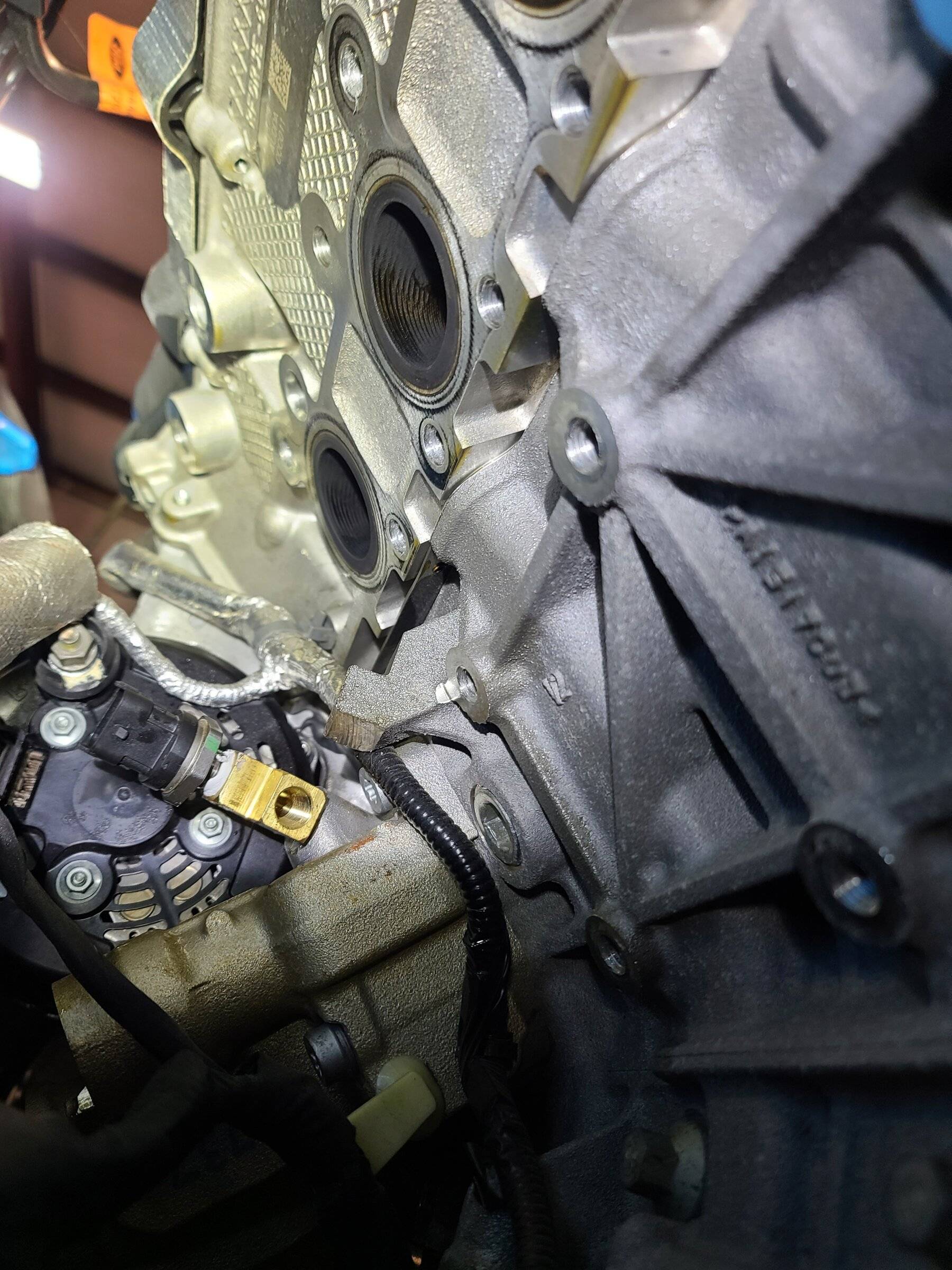

got the turbos on today I opted for the hellion 4 into 1 manifolds and used the stage 8 locking header bolts to hold them on installing the headers was pretty easy there was a clearance issue with the o2 sensor block off plug on the passenger side hitting the transmission bell housing so I ground off a little of the plug everything else was a pretty good fit I did evacuate the a/c and pull the low pressure line off the compressor to get the top exhaust manifold bolts on and off and did pull the motor mounts to get the headers in and out

excellent, exciting. i'll be following.
which turbos did you go with? who's tuning?
using gen 2 68/70 precisions got the turbine housings down pipe adapters and headers coated with jet hot 2500 series so they should keep the heat in. palm beach will be tuning using rtd
