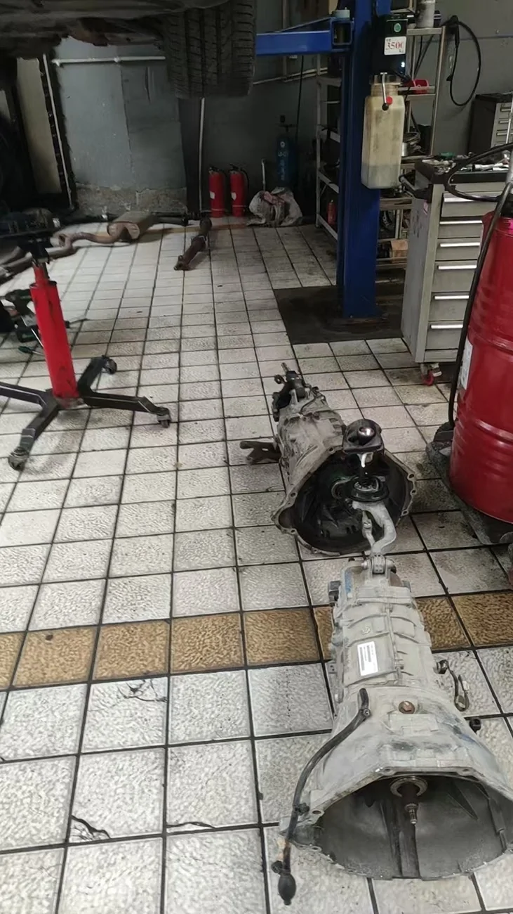

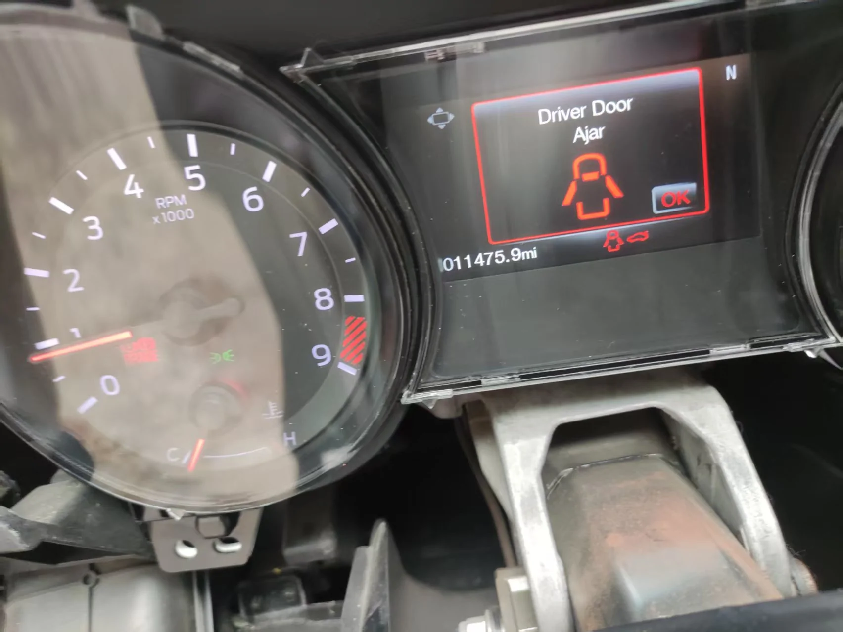

what happened at that day
1, I swapped a gt350 guage to my car.
2. i found the mileage is incorrect, so i swapped my gt gauge back to my car.
3. I pulled the MT82 off my car
4. installed the tr-3160, two mt82 pigtails were plugged in
5. drive, the speedometor works correctly.

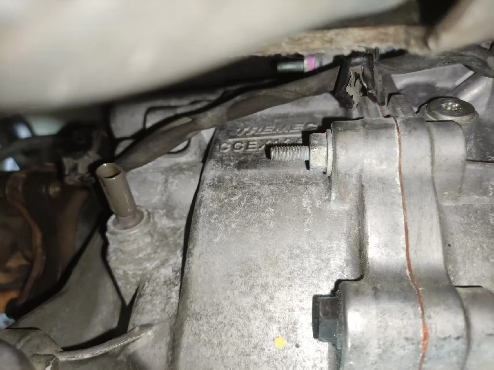

I personally suspect that
there maybe are different microchips in the speed sensor in MT82 and tr3160, once i plugged the pigtail to the tr3160, it enabled some features in BCM.
I am planning swap a MT82 speed sensor to tr3160, i ordered a new MT82 speed sensor, it is on it's way.
