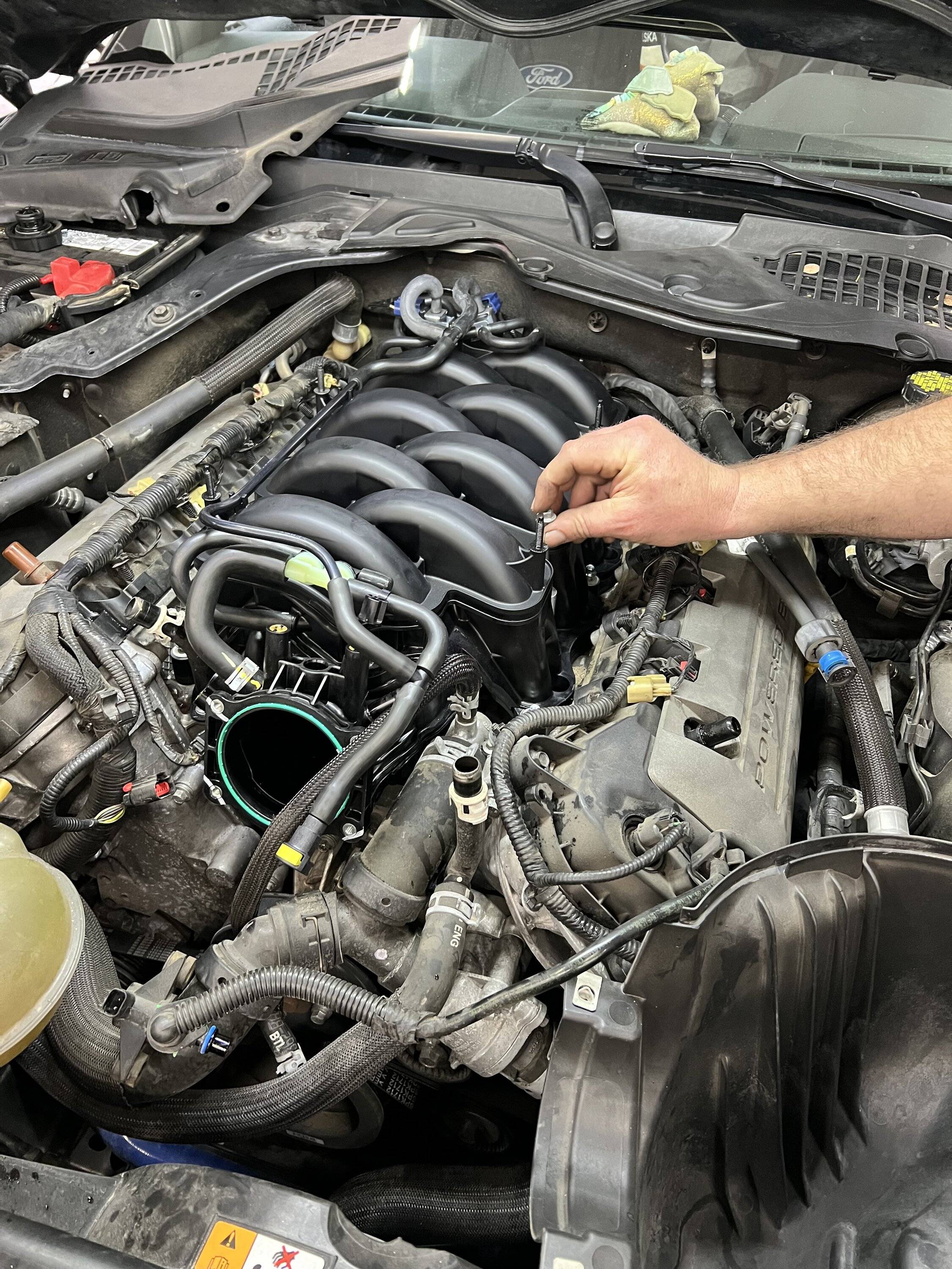

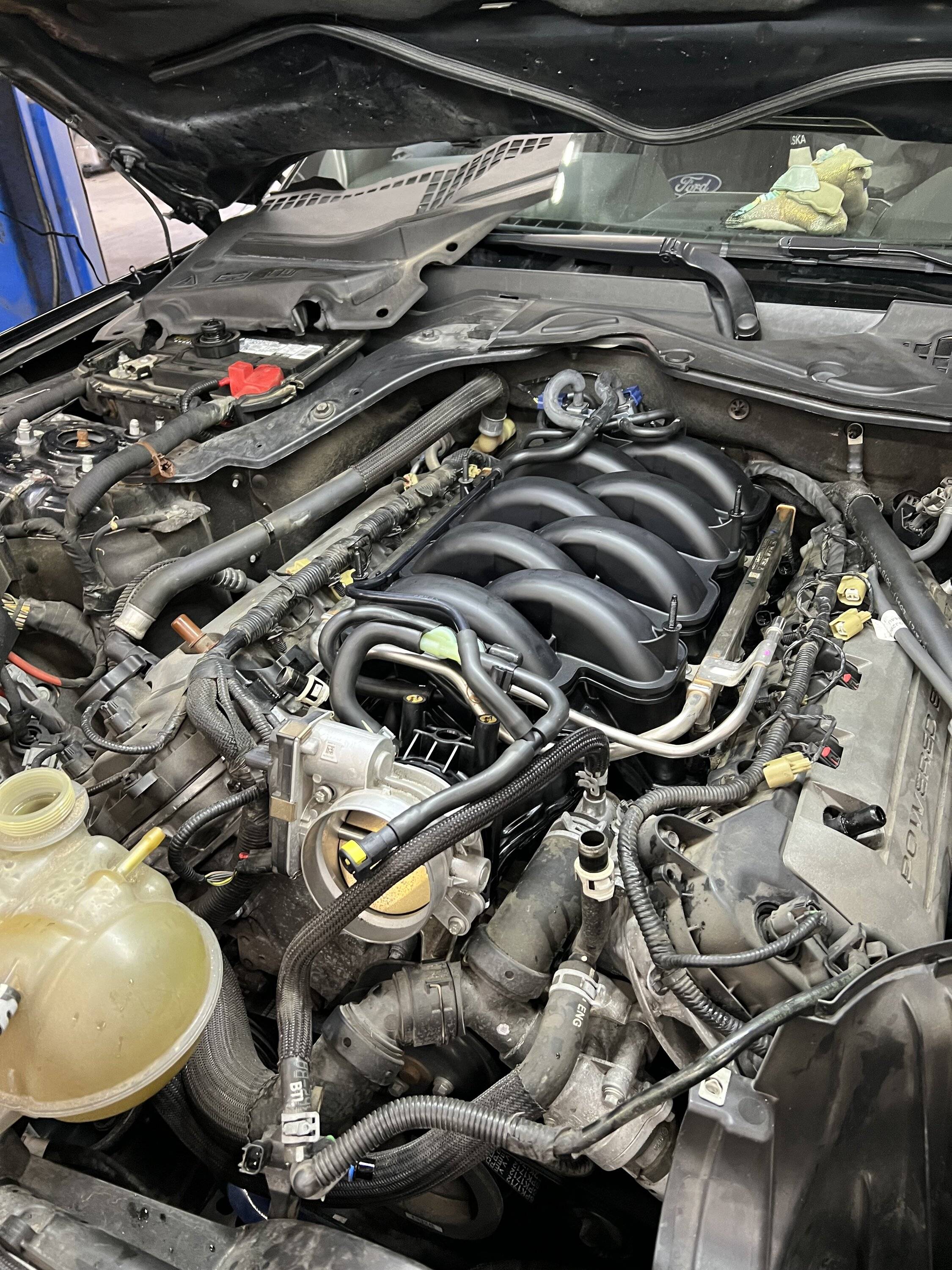

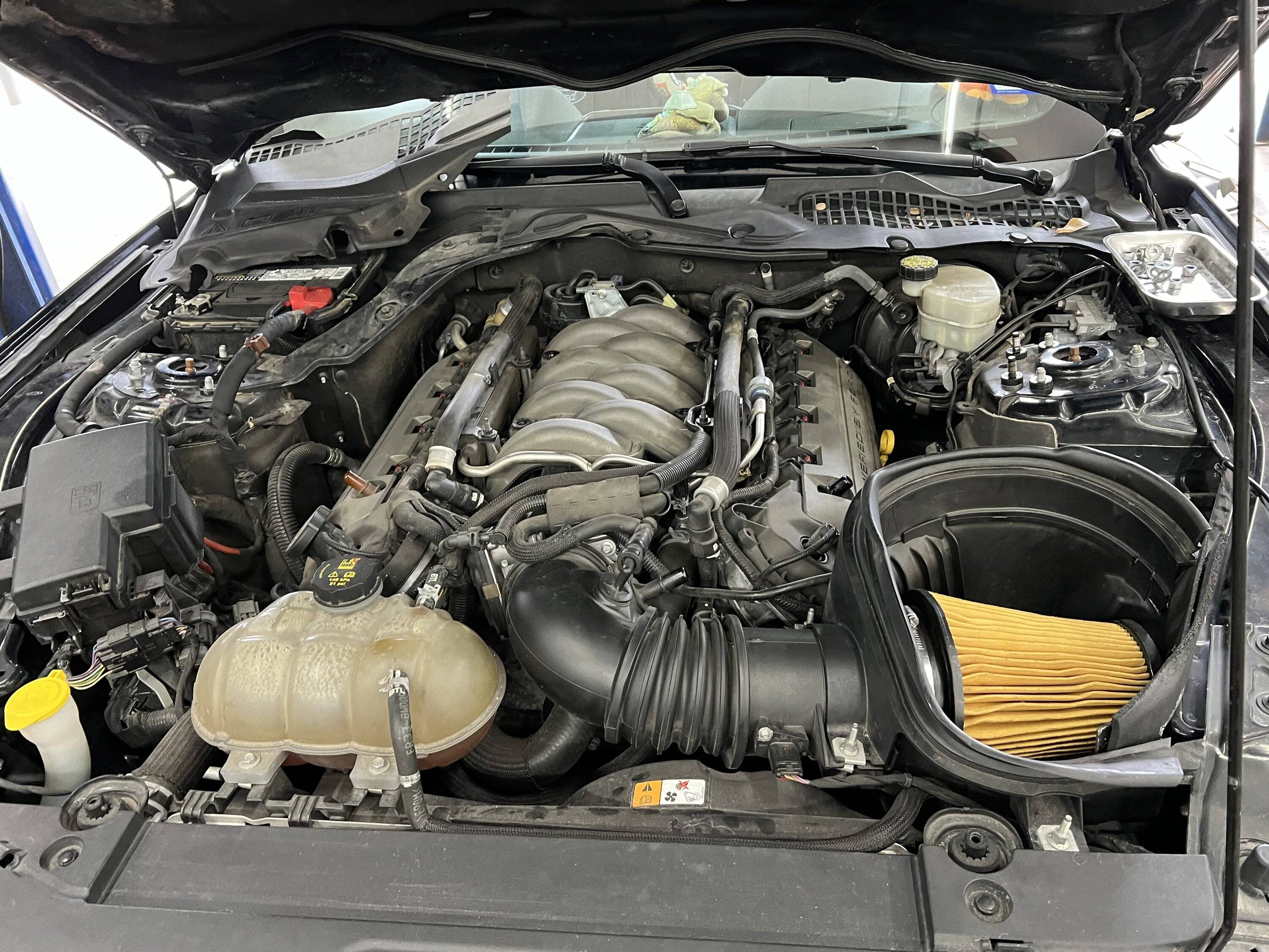

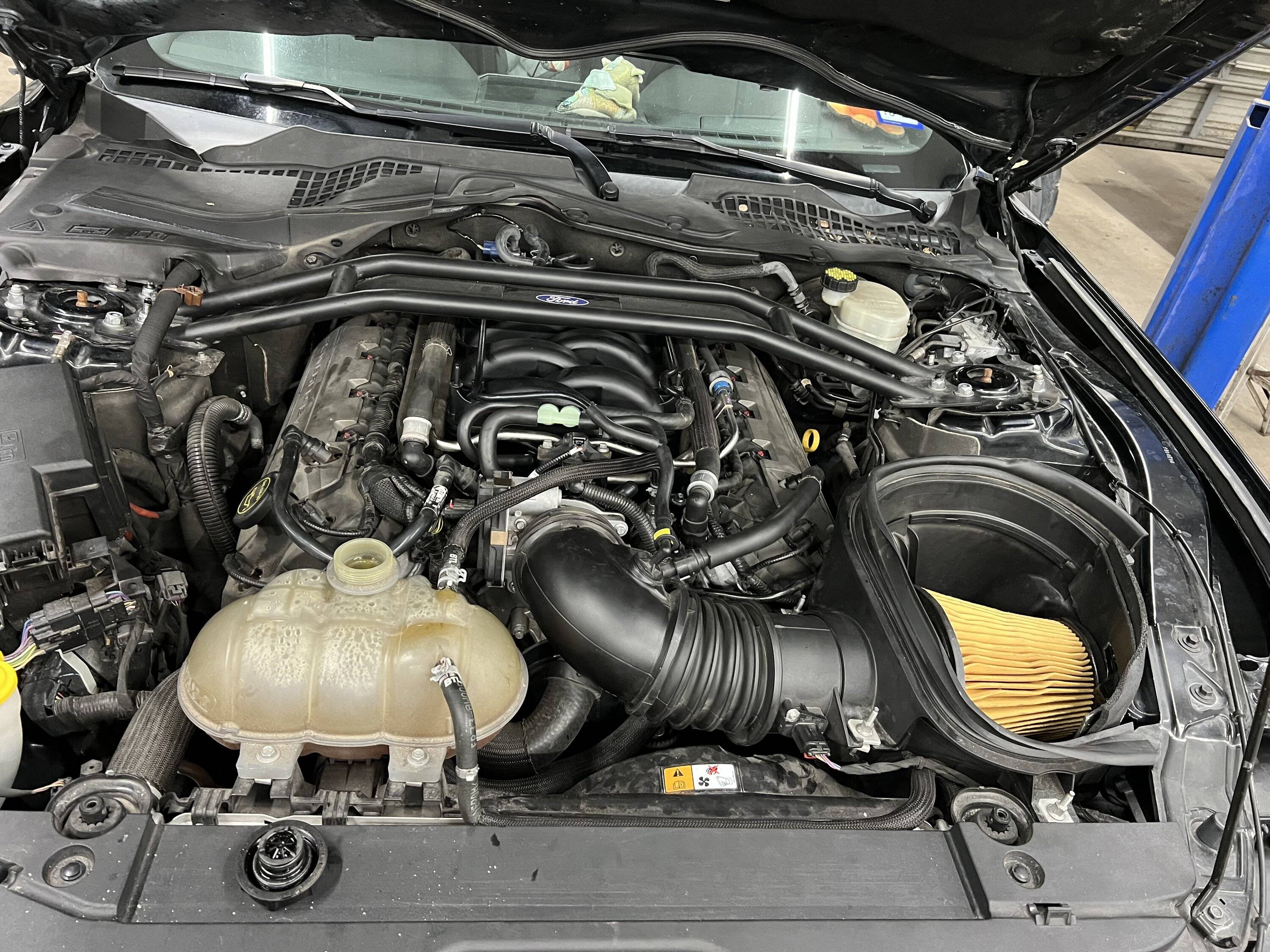

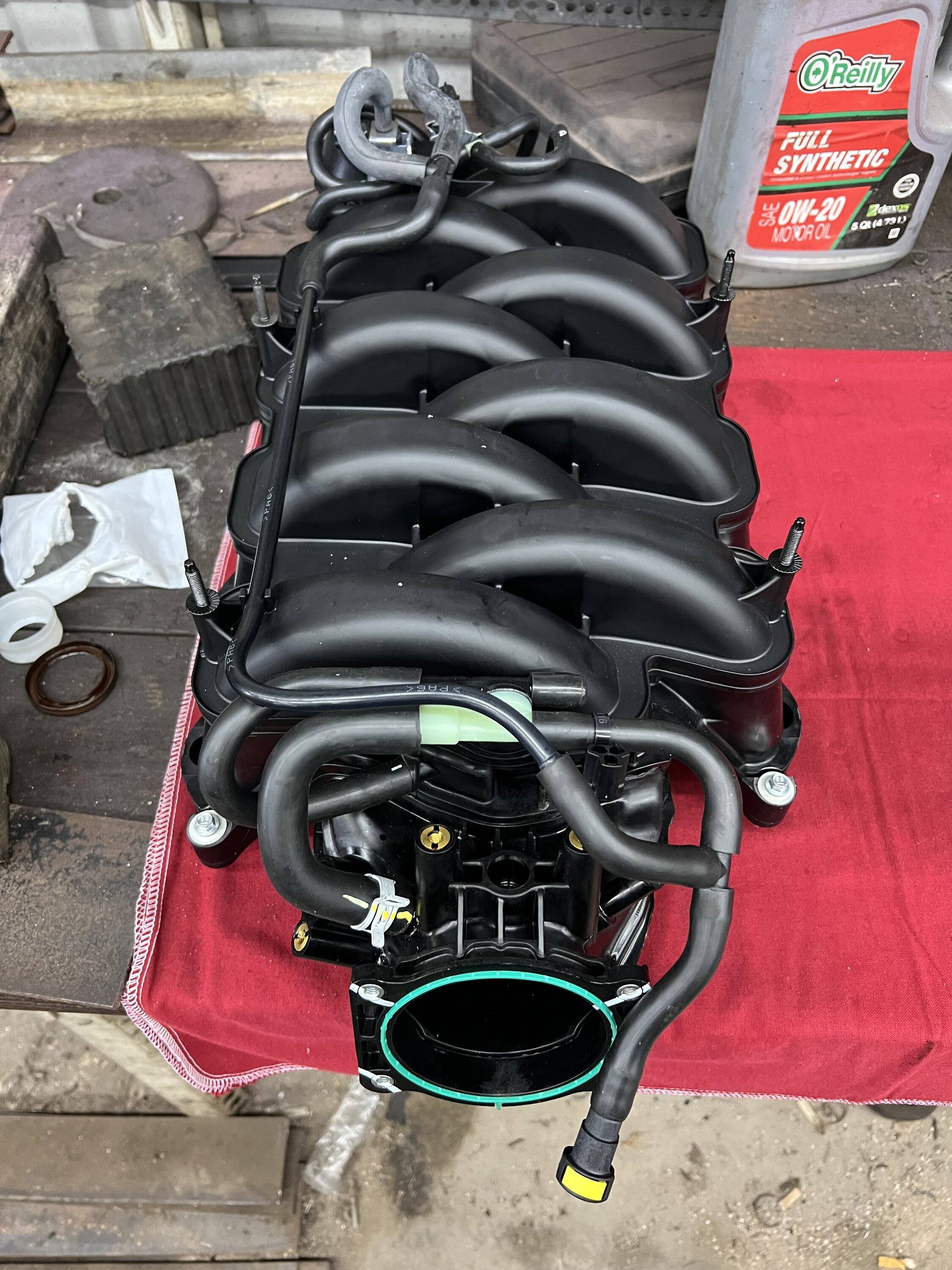

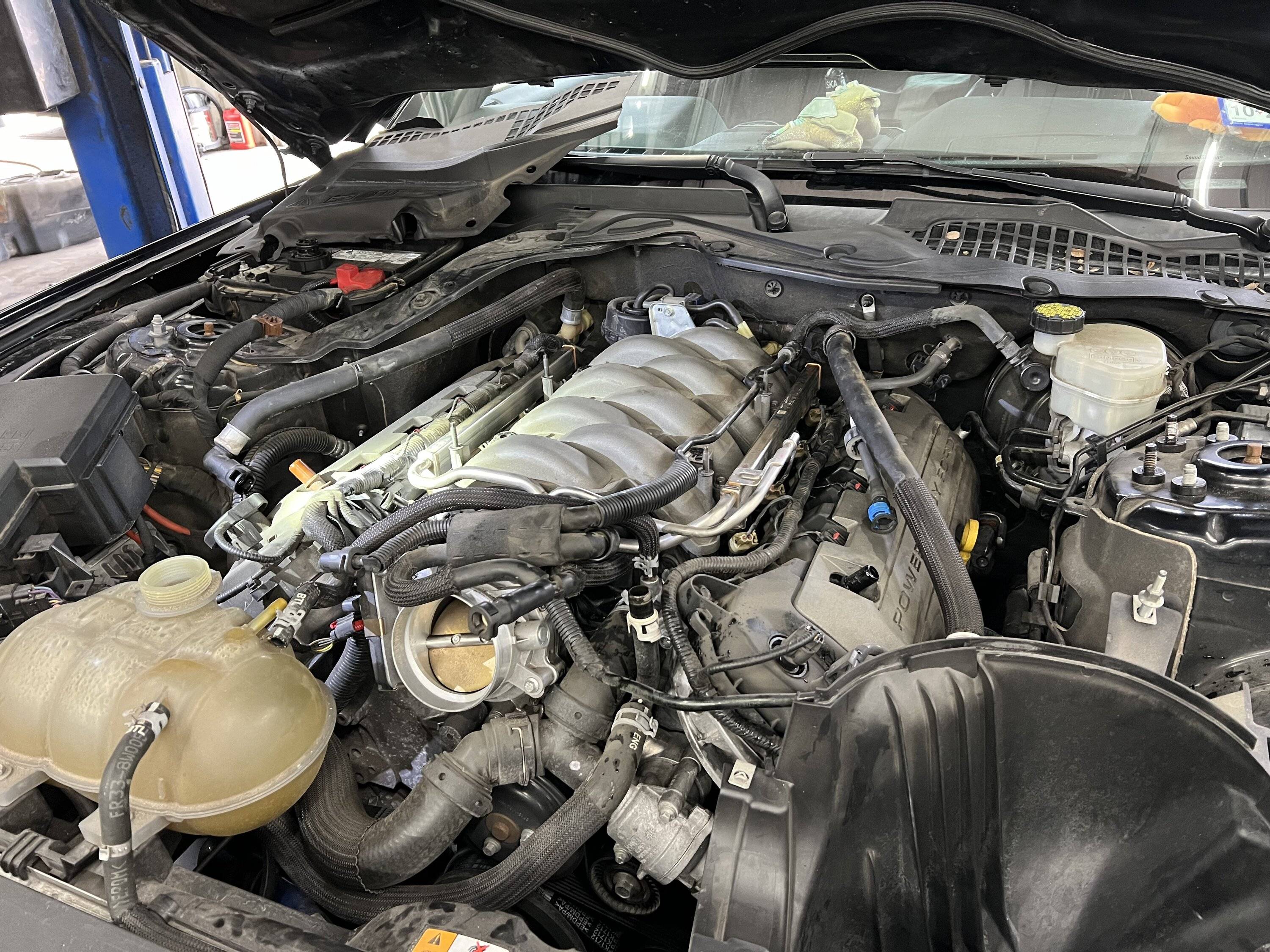

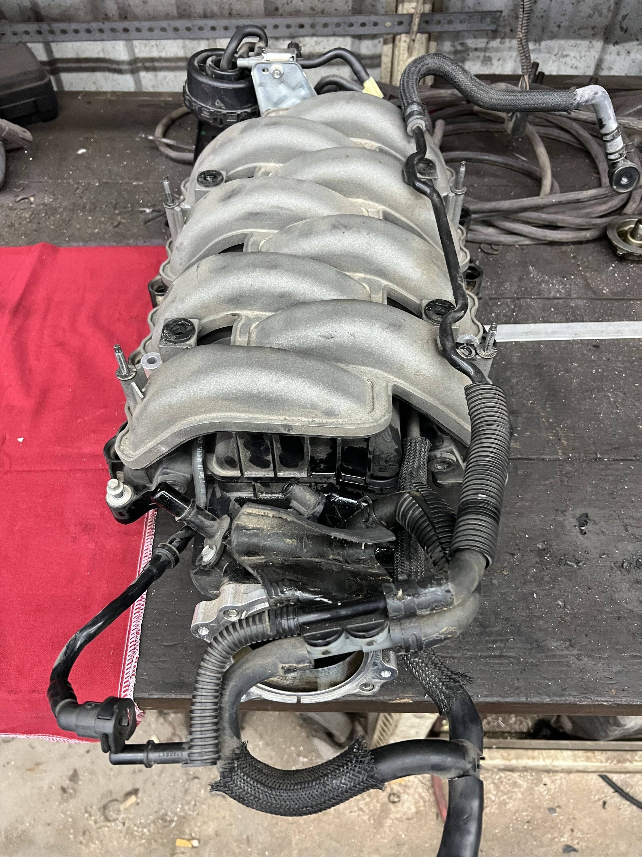

First, thanks to the folks who messaged or posted on a previous post ,I appreciate all the input.
So my 2016 , Ford PP2 mods and tune, 6m , suffered the p0300 p0308 codes. Replaced coil plug and injector with no change. Turns out the drivers bank of IMRC butterflies were completely disconnected . A new 2015-17 intake is unavailable and there is a TSB , my info was it’s not only on back order it will remain so. And a used intake may or may not fail at any time. After reviewing the options I chose the GT350 replacement . One pigtail to the controllers at the back must be lengthened. A extension harness is available to one of the pigtails by the TB . I had the PP2 upgrade installed so I already had the GT350 TB , to use the stock TB you need an adaptor. To connect the brake booster vacuum I pulled the rubber hose off the metal line on the throttle body side and reversed it. Perfect fit. You need a cap to block off a large vacuum port by the TB on the manifold . The bolt on itself is easy. You will not use the engine cover with the intake.
Car started right up on the PP2 tune. Runs well and slams into the limiter lol it has mild surge at low rpm. After 75 miles there are no codes and it runs well and my gas mileage according to the on board system got better.
i will be getting a dyno tune Sunday. Results will be posted.
If you need to replace the stock gen2 intake I do recommend this and you can drive the car after this a tune is genuinely needed. Hope this helps.

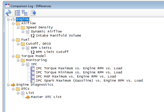

This is a list of differences between PP2 and PP3 tunes. I have both raw tunes, I swapped a GT350 intake onto my car and updated the tune.
The Independant Plausibility Check (IPC) is a system for checking the electronic throttle operation and in the event that the engine is delivering more torque than it thinks it should, the IPC will step in put the vehicle in limp mode with a throttle shut.
The manifold volume and rev limit are also obviously changed, but all other major tables remain the same.
The DTCs, I can't tell what's different so I didn't change them. Car runs fine so far.
