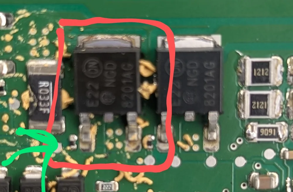

Can you post up some images to the “coil driver” failure reference??

I only have this one picture, you can see the bluish tint on the mosfet. Compared to the one on the right being nice and shiney silver still.
From what Ive gathered and my theory, there is no protection for the coil driver if the coil fails, I ordered what I thought was motor craft coils, they were knock offs. Drove down the road about 20 miles and lost a cylinder. I ended up with a melted coil and this little mosfet burnt up. Swapped mosfet, replaced coils with OE from Ford and haven't looked back.
