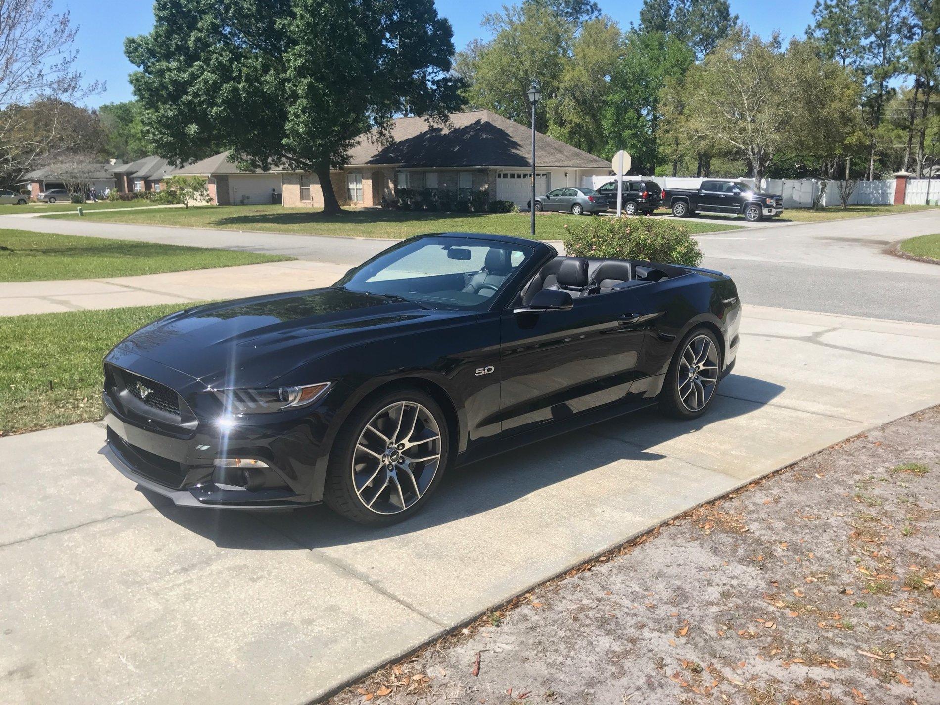

I recently bought a 2015 Ford Mustang GT premium Convertible with 19,000 miles. I LOVE IT, But I have some questions, 1. Does anyone else have problems with their automatic up windows only going up an inch at a time instead of all the way up? 2. When you hook or unhook the top to put it down or to lock it back up, does anyone else's stereo cut out? 3. Has anyone else had problems with the stereo flipping back and forth between phones if you have more than one hooked up to the two USB ports (One under the stereo and one in the center glove box)? Thanks.
