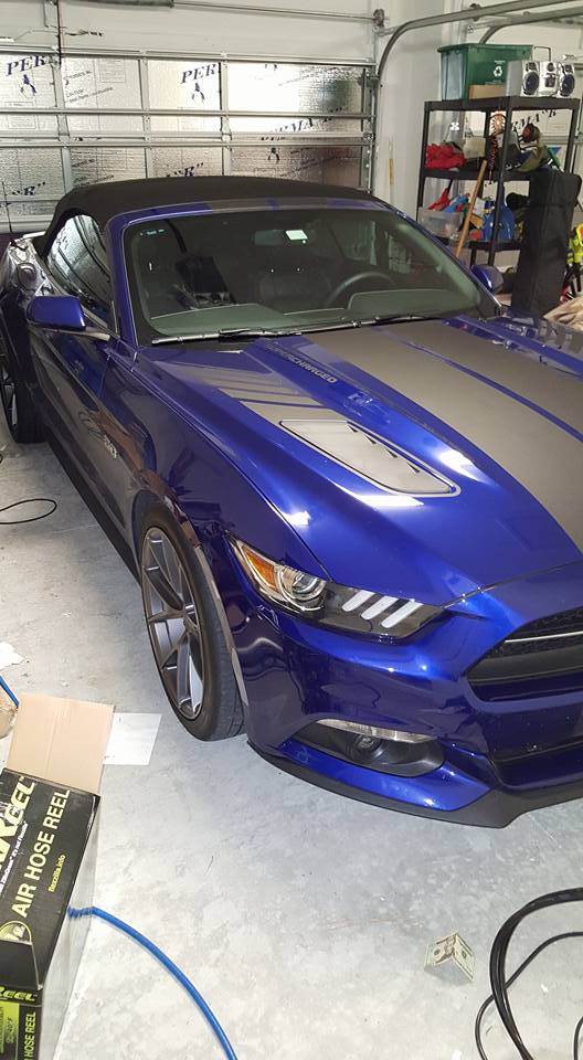

I was able to talk Lund into letting me put a 79mm pulley with 93 pump gas due to clean logs. This caused some major traction issues, so I decided I needed bigger tires. Along with bigger tires came the need for rims. Went from 255's on the rear to 315 Nitto Invo's with Niche Misana graphite wheels to match the stripes:

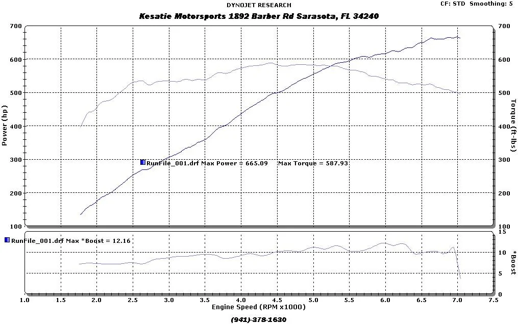

Decided I needed more power so swapped to a 75mm pulley, and with lowered timing went to the dyno. The person running the dyno accidentally let off at 6500rpm(He didn't know I wanted him to pull to 7500 rpm) and put down 665rwhp.

I worked with Lund, and we built a pretty powerful feeling 75mm pulley tune with raised timing for 93 octane with Torco additive. I'm pretty sure it is over 700 to the wheels, but will dyno soon.

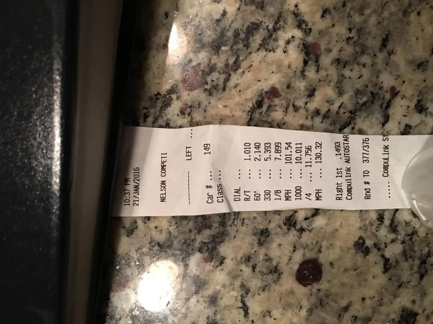

Made it out to the track tonight. Ran a [email protected] with a 2.3 60 ft. Babied it out of the hole and shifted one to 2 a little early. Couldn't get a second run in because it started raining. Need more practice.
*edit*
Timeslip is as follows:
R/T 1.283
60' 2.384
330 5.927
1/8 8.495
MPH 101.08
1000 10.664
1/4 12.432
MPH 129.51
