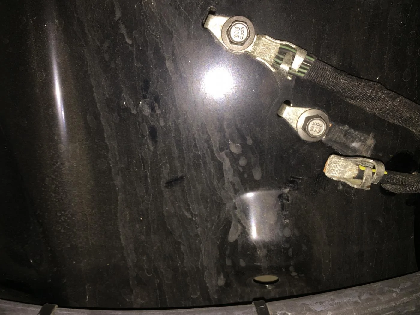

Mine did something similar.. There are two grounds below the airbox, one of them broke off. It must have been the ground that powers the traction, abs, collision warning computer

You mean the ground it mounts to? Watch video below

no there are two ground cables mounted to the fender

Looks like 3 in your picture. I only saw 2 on mine but the bottom of the 2 is where the cai mounts. I resecured it properly and it worked just fine the night of the installation

3? ... more like one that is broken off the wire lug. Just because it worked fine the night of installation doesn't mean the ground is still good. Why not double check it to be sure.

LOL! sorry i was half asleep when i looked at that the first time. but yeah thats obviously the same ground that i must be having an issue with because thats the ground that the CAI mounts to. That said, I'm not sure what would be the problem. It is definitely secured properly and like i mentioned, it worked the night i installed it and failed the following night.

That sounds like you're on to something there. I'd take an ohm meter and measure the resistance between those 2 ground connections, between them and the block and between them and the other end of that ground cable, wherever it goes.
