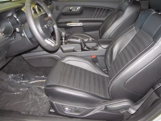

... So here is a picture of my seat and the copy of the no charge invoice. So the dealership told me that for the wind noise they tested another brand new mustang and its normal. And for the seat they submitted it to ford. This car is 7 days old and I can't believe I'm having this many issues already. ...
To top it off the service advisor was rude and acted as if I'm doing im him a favor by driving a ford.
Also does ford not offer courtesy vehicles?
Hopefully there are some online customer service reps going through these forms
Wind noise is one thing, but that wrinkling on the seat seems pretty normal. I wouldn't even notice it.
